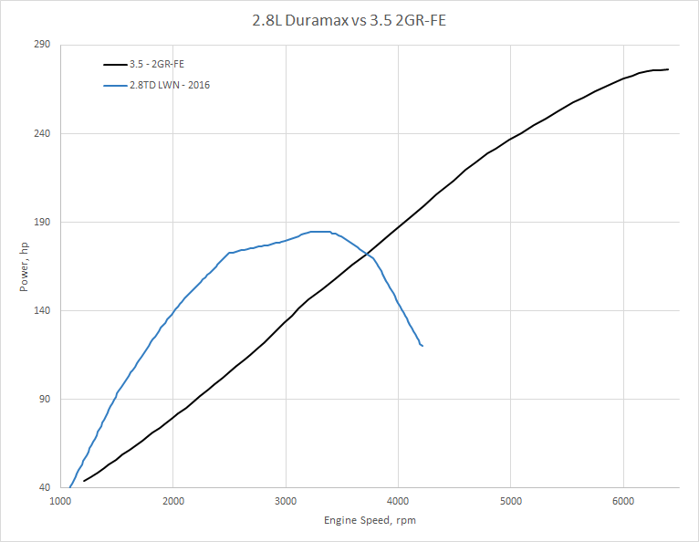

Was curious, so I charted the Canyon's diesel vs the 2GR-FE. Haven't seen the 2GR-FKS on the internets yet, but the FE should be pretty similar.

Despite the big difference in peak horsepower, which most of us were have already acknowledged, that graph pretty much illustrates why someone would choose a small turbo diesel over a naturally aspirated gas V6 for towing and mpg...the difference in low-end horsepower (up to ~ 3800 RPM) is significant and definitely favors the duramax.
The 3.5L gasser has its inherent advantages, but IMO the duramax makes more sense for hauling and towing duties.
