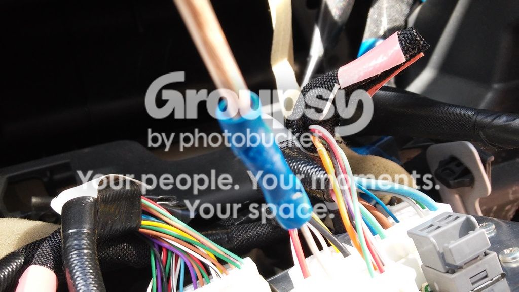

I was working behind the HU earlier today and so, decided to take a few more pictures of it's rear panel; just in case they would serve/assist you better in identifying "The Party Mode" EQ white wire Block G9, term #1 on the HU back panel. Even though the new photos aren't great, they do add some contextual clarity when using them to compare against one/another!
This one is the back of the HU with the two RED arrows at the bottom pointing to the Jumper wire that is used to eliminate the 'Speaker Selection Relay' function (located in the passenger-side kick panel), that shut down your back-door passenger speakers. Now I am ABLE to use the rear door speakers when I have the party mode EQ function engaged and operating! PS: The PINK vinyl tape; accented by the BLUE arrow is just there to help to identify the mesh covered harness that encompasses this PM wire. The RED arrow is there to REMIND YOU to 'CAP' this wire that's been cut... I know that it's intended to be a ground wire, but REMEMBER... this wire that comes from the Relay Coil; which is HOT AT ALL TIMES, and is still LIVE as it searches for a ground and will still cause current to flow where you may not want it to: I have my (series configured) tailgate speaker terminals jumped over, creating a 4-OHM rear door speaker configuration. If I were to energize that tailgate with an amp (built-in or external); I would destroy the HU or power-amp in an instant!..."Just something to keep in mind":

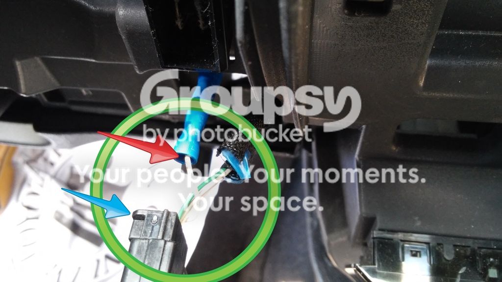

This final photo below is of the change to the party mode button's connecting wire. The BLUE arrow (below) is pointing to the PM switch body with it's white GND lead going to the blue Crimp Connector, and then through the dash 'a short distance' to meet the HU directly on the other side! This 'NEW' scheme changes the Toyota plan completely, by releaving party-mode of it's administrative authority to 'Pick-and-choose' what speakers that you will be allowed to listen to! So by making this simple change, you decide which rear speakers you want to be on: Tailgate, Rear passenger speakers ONLY ...or BOTH... you choose!!!
