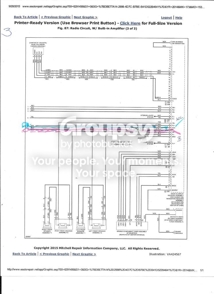

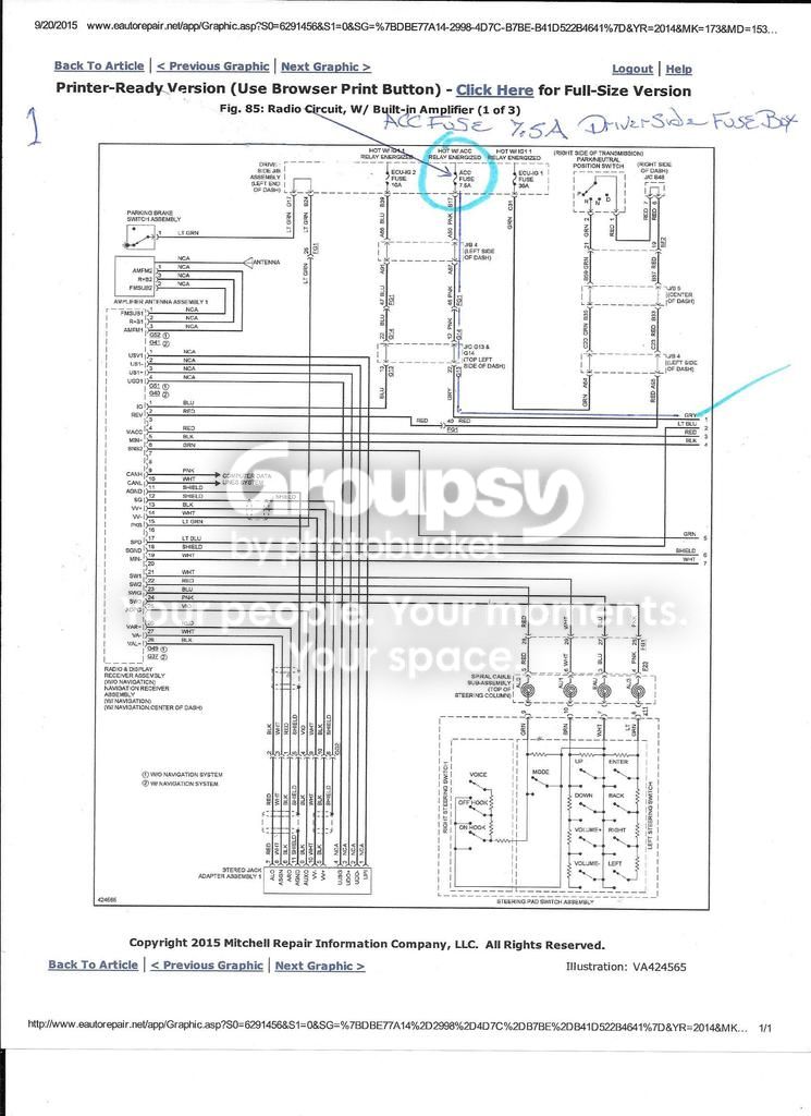

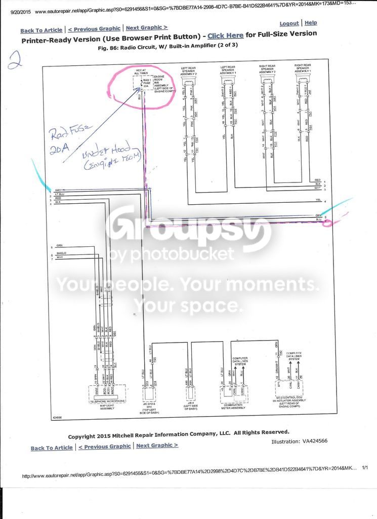

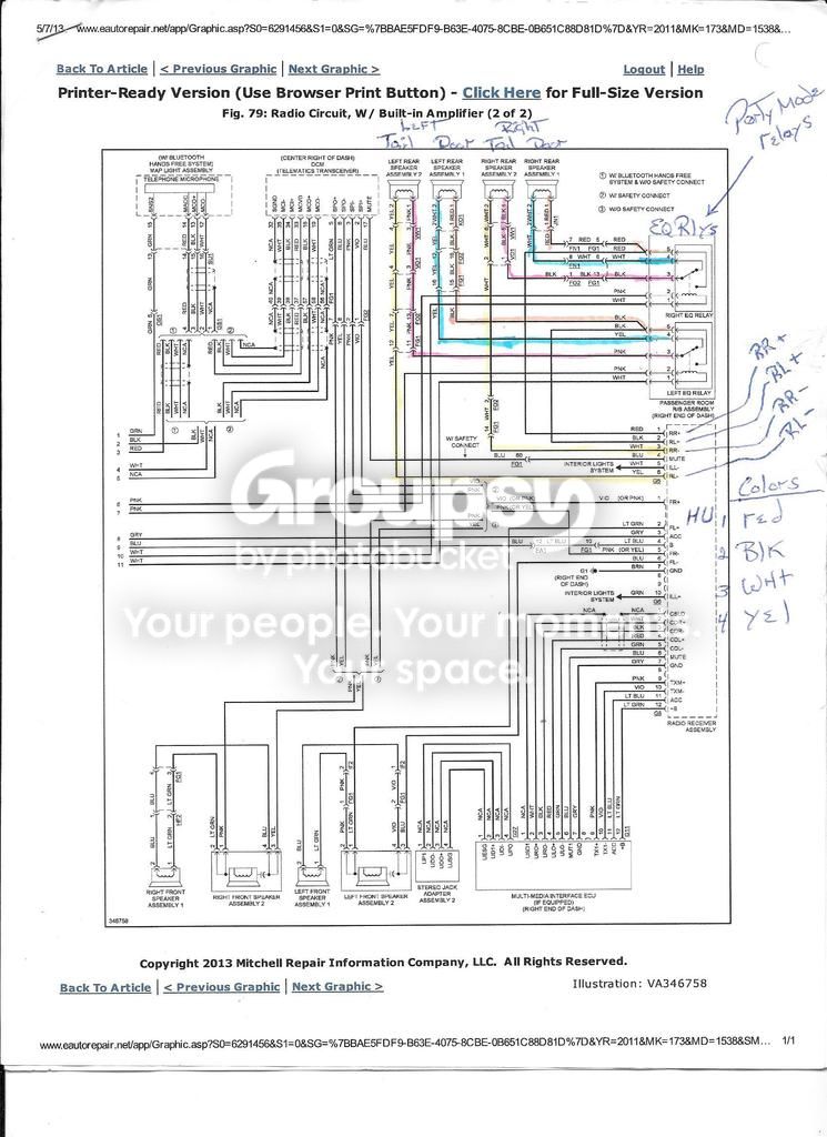

Hey Rig, I need to know where you got your wiring diagram from. I have a 2010 that had the non JBL with no nav but then found a 2013 nonJBL with nav HU on the cheap. Perfect fit, except for the pins for the steering controls and microphone are totally different. Needless to say, in order to complete this conversion I will have to figure out which wires to splice.. Thanks!!
I love the conversion btw.. SO much better, thanks for the post!!
Hi Fatoscar,
Thanks for the compliment regarding 'The Party Mode Tweak'; it was very fulfilling to write about, and I'm hoping that others will benefit! To answer your question about the diagrams... I bought the 2011 4Runner wiring data (which covers '10-'13) a couple yrs ago and then two or three weeks ago, I purchased the 2014 (the latest addition available); which should cover the '14-'16 models. The system schematic that you'll need is the Radio circuit. It has three pages of relative components; including the steering wheel (Spiral controls), ...you can just ignore the highlighter marks on them, that was from another job... "see below":
...Should you need a different set of schemes just let me know and I'll do whatever I can to pull them up, Rgds!

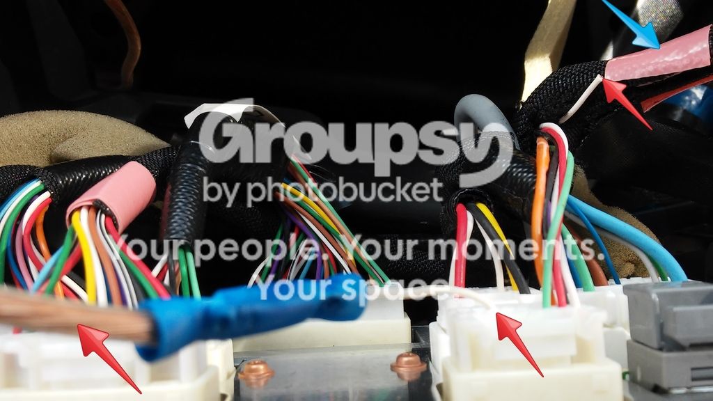

Making the change is very simple: First remove the HU. Now remove the small trim panel that houses the PM button. You're going to cut the White wire at the #1 terminal on the hu... no need for me to rewrite these easy dirctions, just follow these simple steps w/pictures and you'll be done in 20 minutes!: http://www.toyota-4runner.org/1730717-post1.html ...you don't need to read the whole composition, just the part instructing how to move and terminate the one white wire. This is the part that By-passes the relay coils and so prevents them from disconnecting the rear door speakers!
HERE'S THE WIRE TO CUT AT THE HU REAR PANEL "See red arrows"
86f2e648-231c-47d5-b2dc-07a75c33acd3.jpg~original
Take a look at these instructions and let me know that you're understanding them,
Cheers!

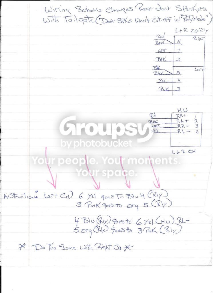

Okay [MENTION=120209]tigger[/MENTION], [MENTION=118444]flyinhawaiian01[/MENTION], and all others interested in maintaining operation of your second row 'Rear door speakers' AT ALL TIMES. Again there are easier ways to keep the backdoor speakers on along with the 'Party mode' function turned on, without going into a serious speaker system rewire. But if you want the Tailgate speakers to behave exactly as the rear door speakers did from the factory; dropping out whenever the party mode is activated, then this is the right way to do it!
A few years ago I wanted to prevent the rear door speakers from dropping out when I had the party mode turned on, so I charted this new scheme out believing that this was the only way to do it; "see if you can follow along". Basically what you're doing is moving the tailgate speaker wires to the rear door speakers and moving the rear door speakers to the tailgate position. The only thing different is that it would be next to impossible to do that out in the open space, from the speaker's location due to aesthetic concerns and wiring integrity/safety issues!
So we'll do that from behind the headunit and in the passenger side kick-panel. The top wiring diagram shows the speaker wires, HU and L & R EQ Relays. I've traced the wires to be swapped with colored markers: Pink, Yellow, Blue and Orange, for my own reference to help distinguish between the really small lines on paper and their difficult to read abbreviated color designations. Down below the diagram I've posted a wire legend to point out just what everything is on the schematic; refer to the lower half below the four pink arrows:
It says: "6 yellow goes to Blu 4 (Rly)..." then, "3 Pink goes to Org 5" then, 4 Blu (Rly) goes to 6 Yel" (HU) yada, yada, yada...
All that's really saying is: Place wire 6 yel (at HU) on 4 blu (on Rly) and move blu 4 (on Rly) back onto 6 yel (to HU) i.e. swap them! Okay, so don't be confused; this chart was never meant to be posted online, but rather for my own reference during the wire changeout! I have the speakers (top of page) labeled to identify their locations in the truck. If you get stuck on something just post the trouble; I'll be checking in here from time to time throughout the day so I'll try to address your concerns as I see them!
