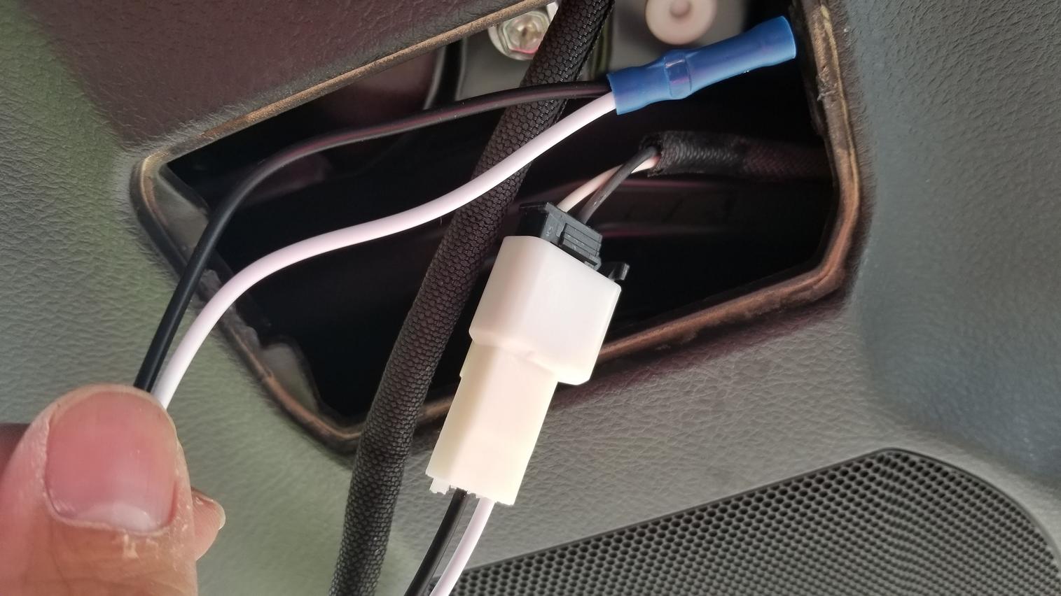

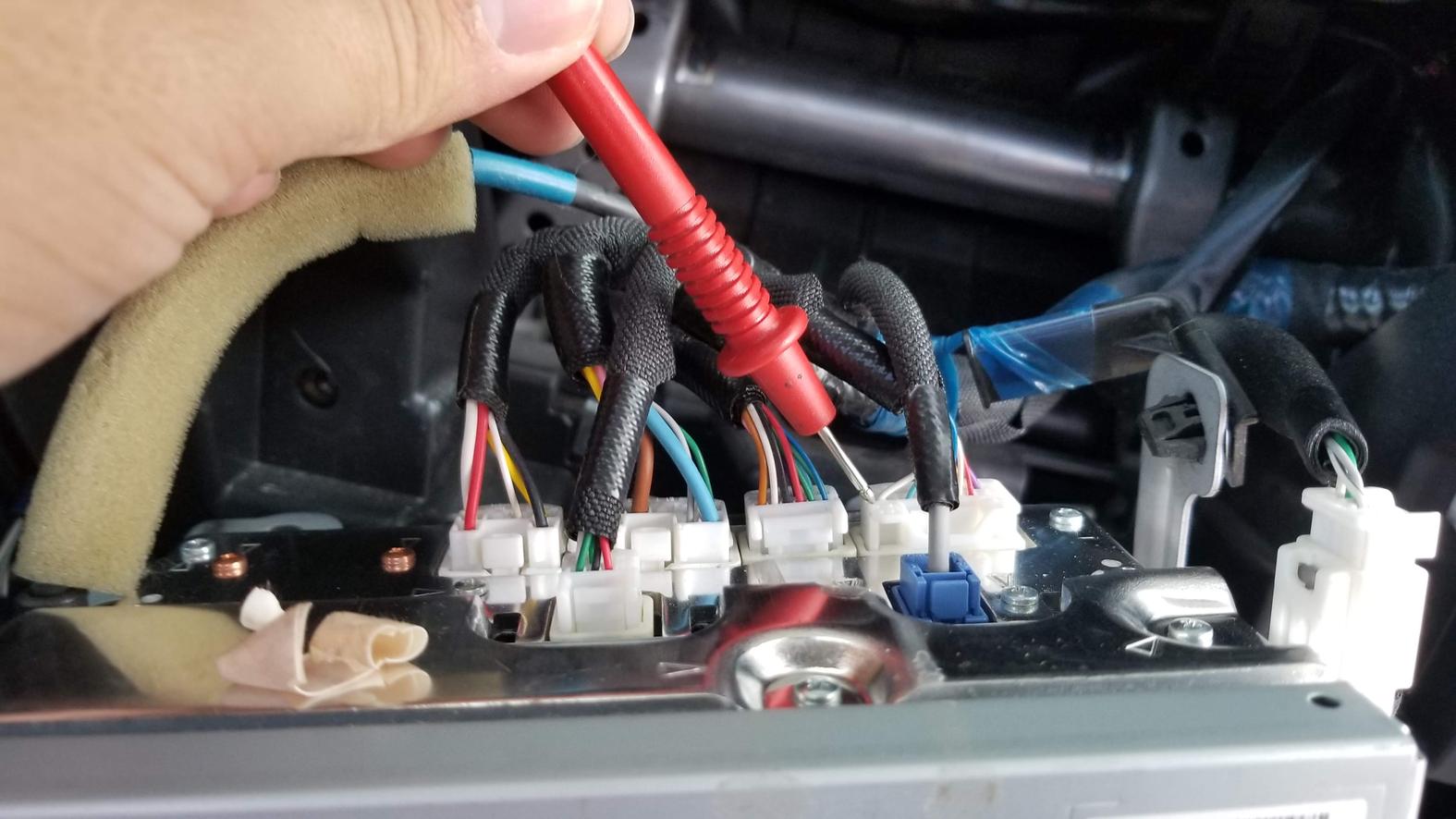

Thanks Op. I did this mod to my 2013 4runnner SR5 with no jbl/navigation. On the head unit my wiring was a bit different. It has different harness plugs and locations. I am pointing to it with meter probe (pic below) I also used a pair of speaker wire harness for the rear door jumpers.
See pictures below.
Thanks for the detailed write up. I was able to find the right wire because you did a great job describing how to test for it.
See pictures below.
See pictures below.
