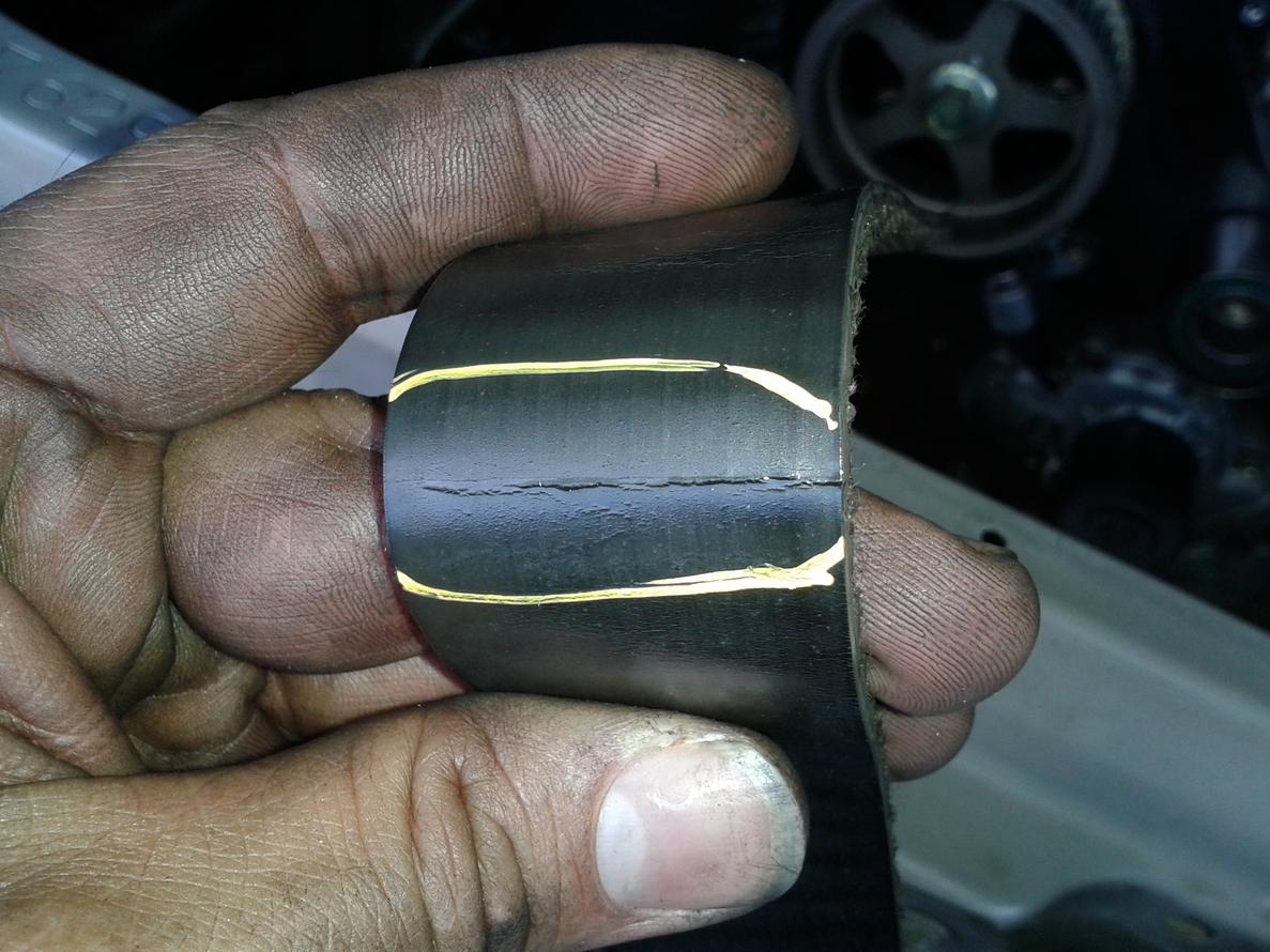

i just did my second belt on my truck. the first change was in 2013 when i bought it. it was the original belt with 206k on it, along with pump, pulleys and tensioner. this belt had almost 90k on it and was already cracked almost through in all directions.

That's low, what brand belt? Doesn't sound oem. I just got the Aircabinman oem kit on eBay. Mitsuboshi timing belt, Asin water pump, etc.

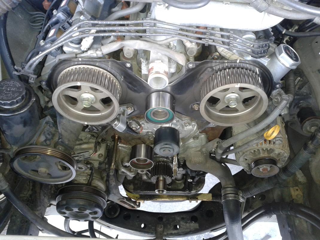

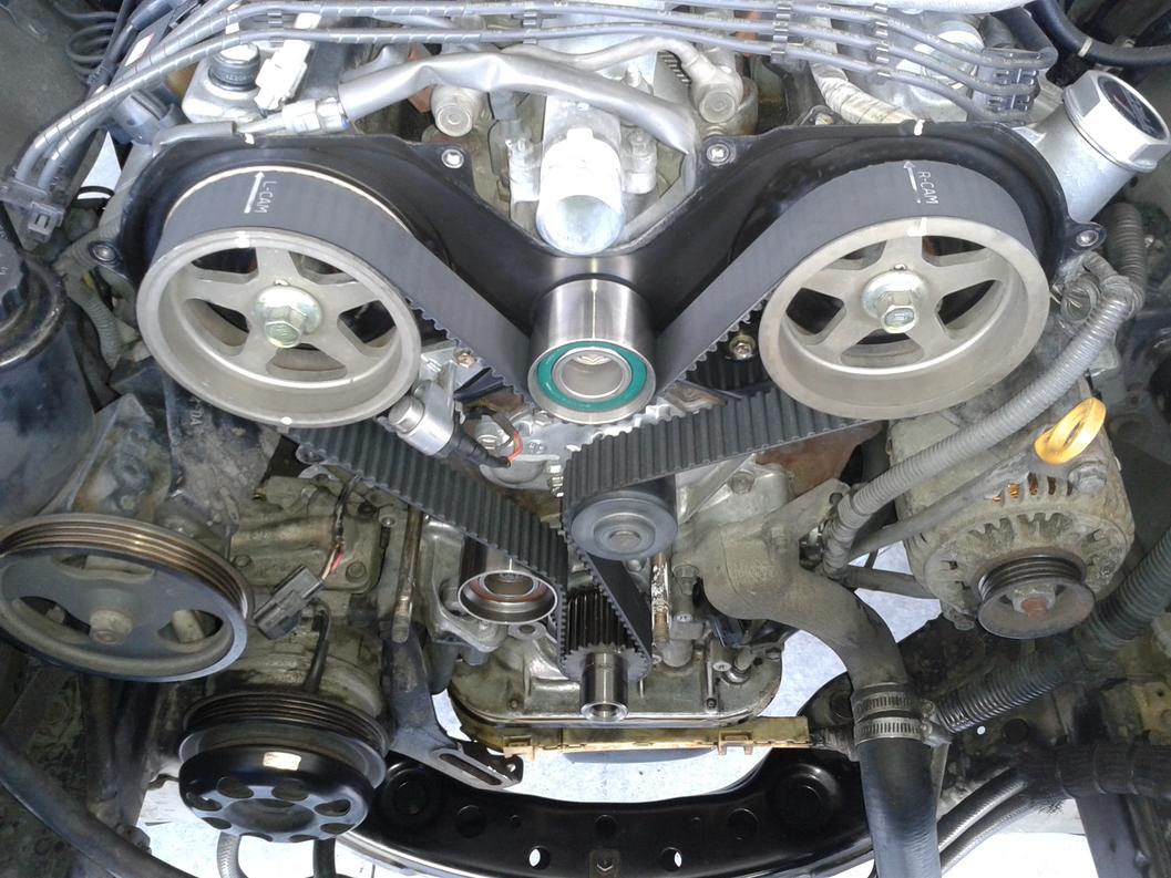

Thinking belt might be on backwards? I put mine on like that first. then the crank register mark on belt did not line up with imprinted dot on crank gear at 3:00 position. The top dot of crank gear was lined up with 12:00 position dot on front of block, but the mark on belt supposed to line up with another dot on gear. Then Realized left/right is driver facing, not mechanic facing. I swapped it around then the crank register mark on belt lined up proper with the dot on crank gear at 3:00 and the 12:00 marks lined up too.
I don't think it's a problem though as long as teeth lined up. If it's running well, all is good.
