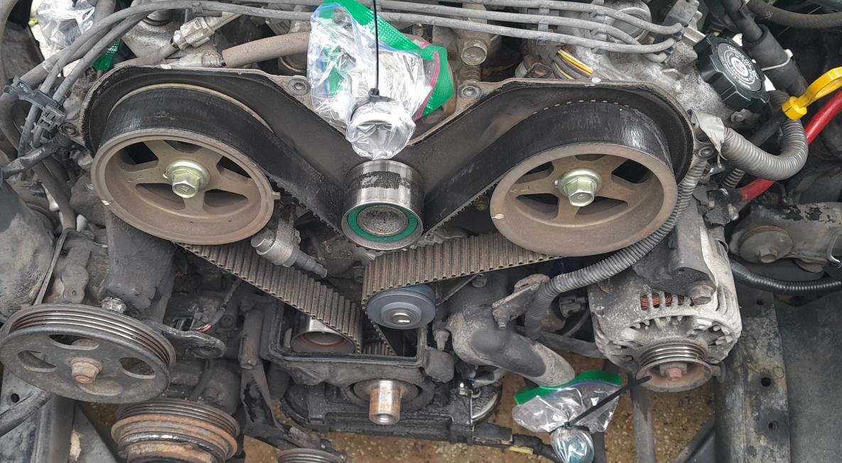

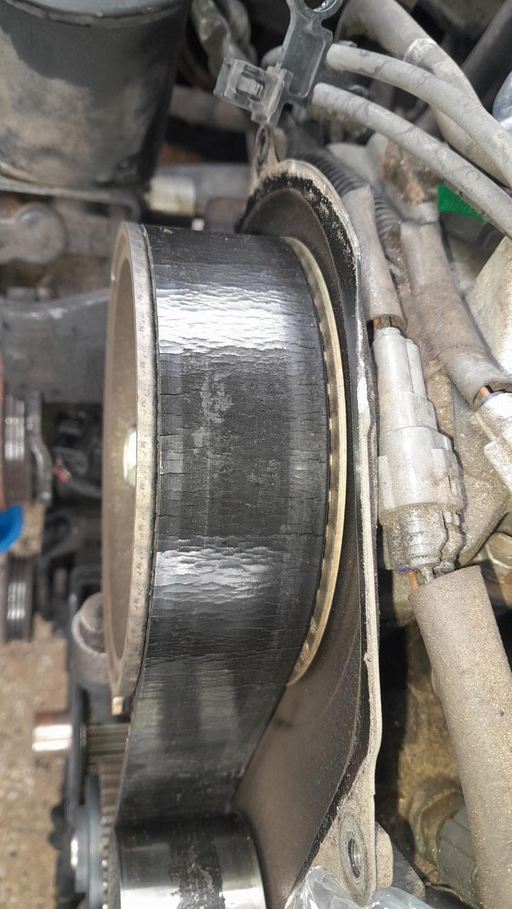

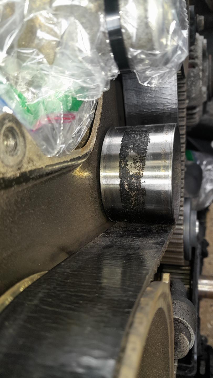

Old thread alert.....97' T100 240K miles. What you think? OEM? The cracking and residue on the tensioner and pulleys might be a good clue.
