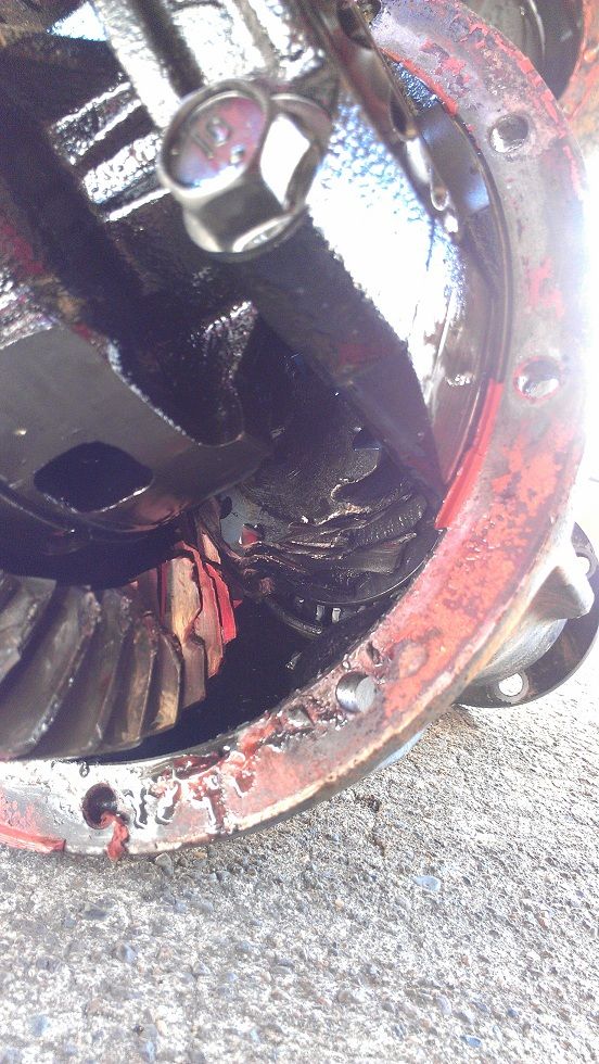

took it out wheeling on the 4th of july and broke my first CV in this thing, it came apart hard and really tore some stuff up, i had pieces of cage jammed in between my wheel and caliper that shaved some aluminum off the wheel and took small chucks out of both the caliper and wheel... then right after that my rear end finally let go, had to put it into 4wd to force it home(only a block away) but it tore things up really bad, i was going to regear, but waiting on payments from the army and my civilian employer fired me so that wasnt an option any more, so i got a good used 3rd member from another 4runner and tossed in, every thing worked great until i test drove it and blew the other CV in my driveway WTF. so now i got two new CVs up front.
IMAG2516_zps03b3876d.jpg~original
IMAG2513_zpsec80484b.jpg~original
IMAG2512_zps7407ef34.jpg~original
IMAG2511_zpsb867ae4b.jpg~original
broken CV and the damage it made:
IMAG2341_zps0b5ac0ab.jpg~original
IMAG2332_zpsb2cf0219.jpg~original
IMAG2337_zpsa9ac53c5.jpg~original
IMAG2335_zps05aa8c02.jpg~original
IMAG2338_zpsad10b42e.jpg~original

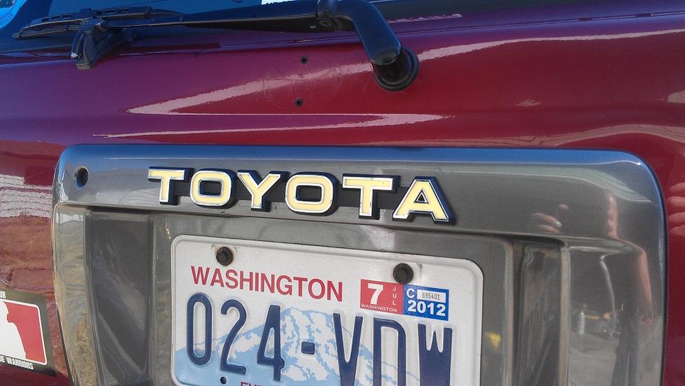

i put on a new toyota emblem on the back gate license plate frame, i think its from a new tacoma or fj crusier, not sure which though, my father inlaw gave it to me.

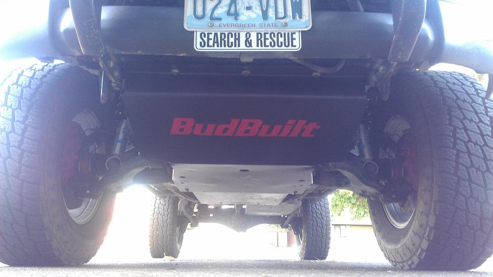

then today i repainted my front skid, as it was all scratched up and had some major paint pealing going on on the upper(engine) side, from a engine degreaser i used a couple of weeks ago when cleaning the motor off. again same painting procedure as above, after i let the paint try for 2 days i masked off the skid and cut out the "budbult" and rescuffed that and shot that with red caliper paint...
