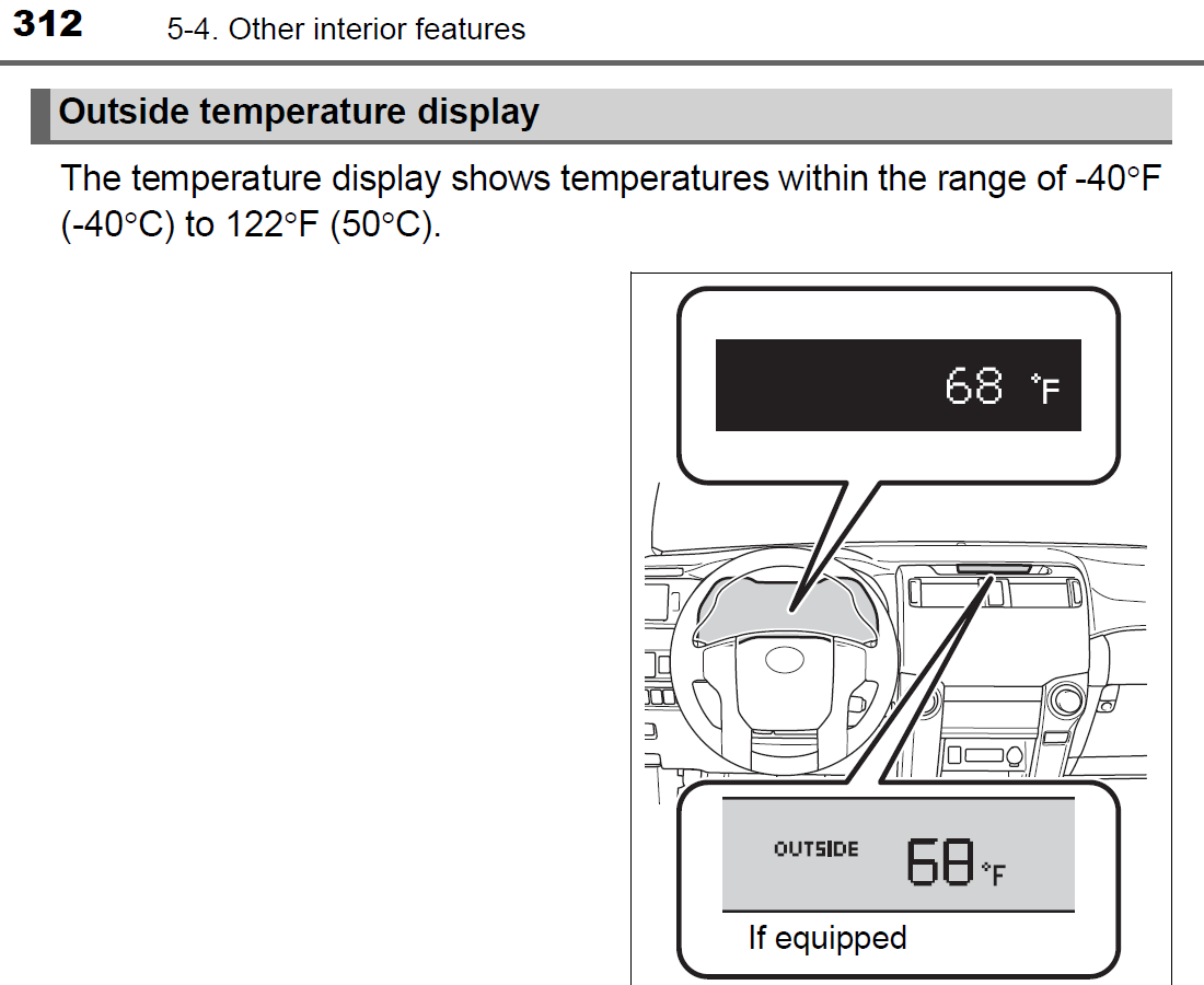

page from owners manual :

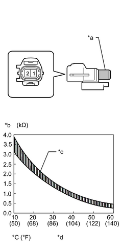

Awesome! Breaking out the multimeter tonight..
Min: -23.3°C (-9.94°F) (Also the Temperature that shows when the circuit is Open)
Max: 65.95°C (150.71°F) (Also the Temperature that shows when the circuit is Shorted)
10°C (50°F) - 3.00 to 3.73 kΩ
15°C (59°F) - 2.45 to 2.88 kΩ
20°C (68°F) - 1.95 to 2.30 kΩ
25°C (77°F) - 1.60 to 1.80 kΩ
30°C (86°F) - 1.28 to 1.47 kΩ
35°C (95°F) - 1.00 to 1.22 kΩ
40°C (104°F) - 0.80 to 1.00 kΩ
45°C (113°F) - 0.65 to 0.85 kΩ
50°C (122°F) - 0.50 to 0.70 kΩ
55°C (131°F) - 0.44 to 0.60 kΩ
60°C (140°F) - 0.36 to 0.50 kΩ
Make sure the vehicle is in movement to get the correct temperature, as per the manual:

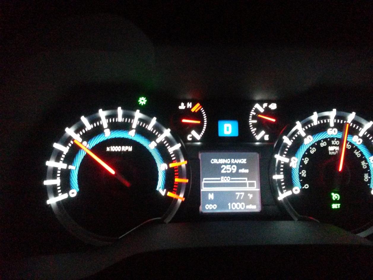

I'm just messing with you! I'm just as bad....here's mine doing 70MPH as well and taking a pic when my ODO reached 1000. Let's see if I can capture a pic every 1k.
