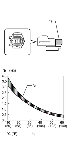

88625P in the picture is the Ambient Temperature Sensor P/N 88790-22150
If you pop the hood, it should be on that center post in front of the radiator.

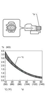

Thanks again. Ill check it out. Any procedure on checking if the probe itself is good? Maybe a resistance reading at xx temp or something?
Min: -23.3°C (-9.94°F) (Also the Temperature that shows when the circuit is Open)
Max: 65.95°C (150.71°F) (Also the Temperature that shows when the circuit is Shorted)
10°C (50°F) - 3.00 to 3.73 kΩ
15°C (59°F) - 2.45 to 2.88 kΩ
20°C (68°F) - 1.95 to 2.30 kΩ
25°C (77°F) - 1.60 to 1.80 kΩ
30°C (86°F) - 1.28 to 1.47 kΩ
35°C (95°F) - 1.00 to 1.22 kΩ
40°C (104°F) - 0.80 to 1.00 kΩ
45°C (113°F) - 0.65 to 0.85 kΩ
50°C (122°F) - 0.50 to 0.70 kΩ
55°C (131°F) - 0.44 to 0.60 kΩ
60°C (140°F) - 0.36 to 0.50 kΩ

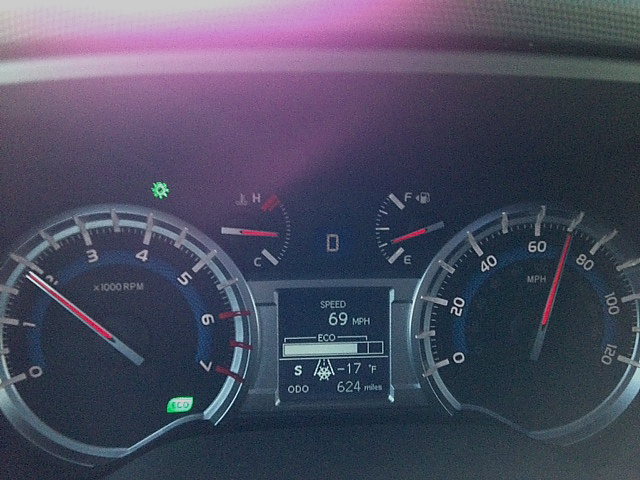

That's odd. Here is -17F. I saw it go down to -28F, but no photos.

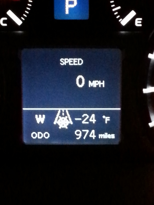

its rated to go much lower, I think -39F. this is the lowest I've recorded on mine.
and as you can tell based on Bilbo's screen, I removed my eco bar via techstream :)
