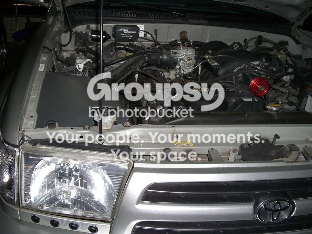

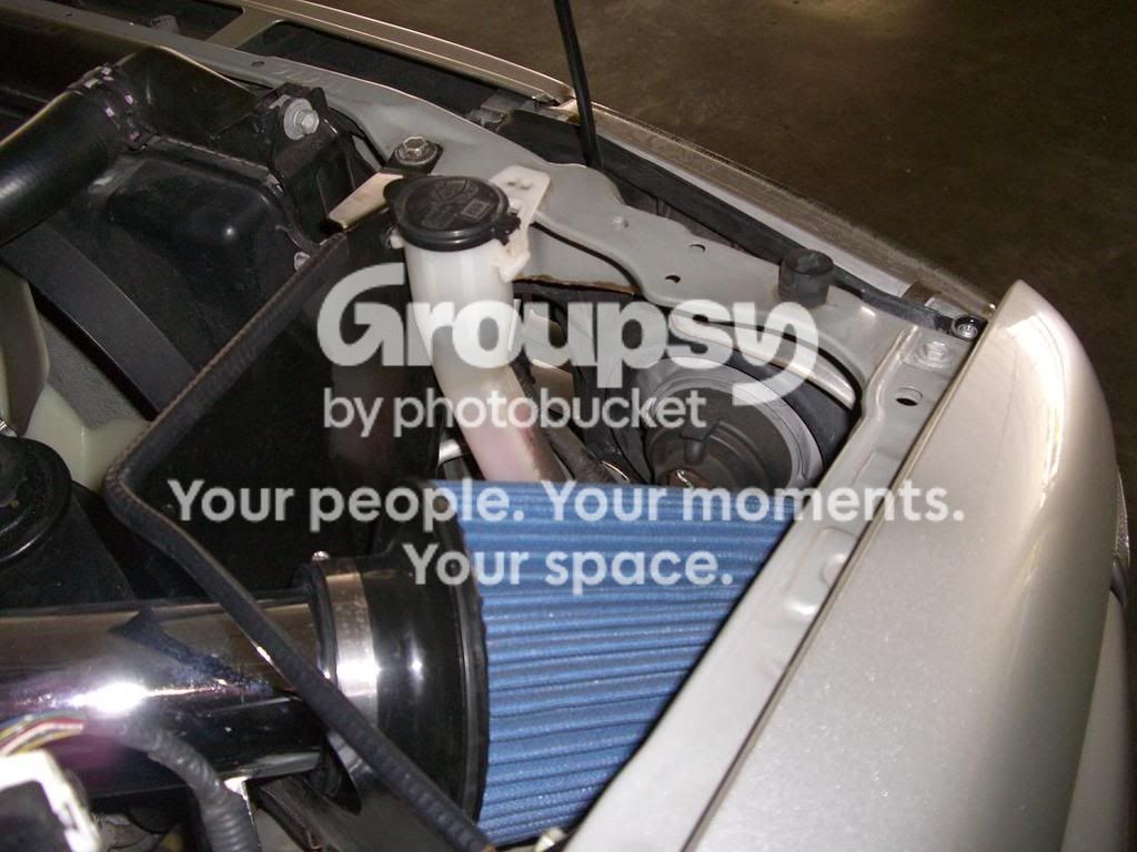

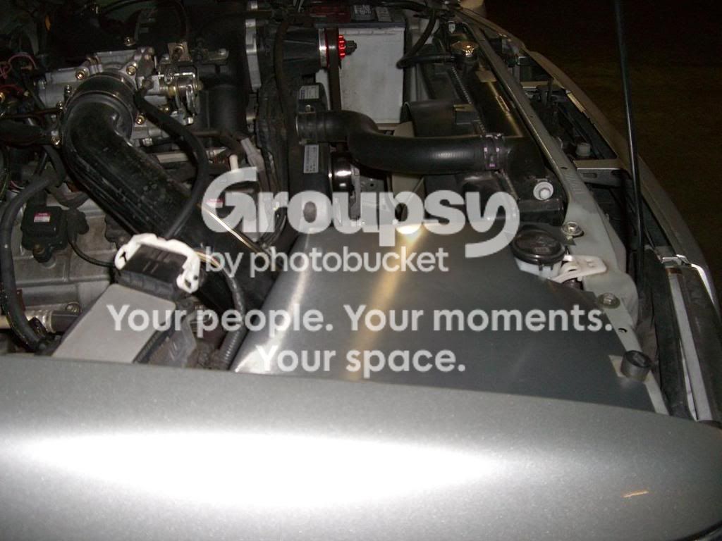

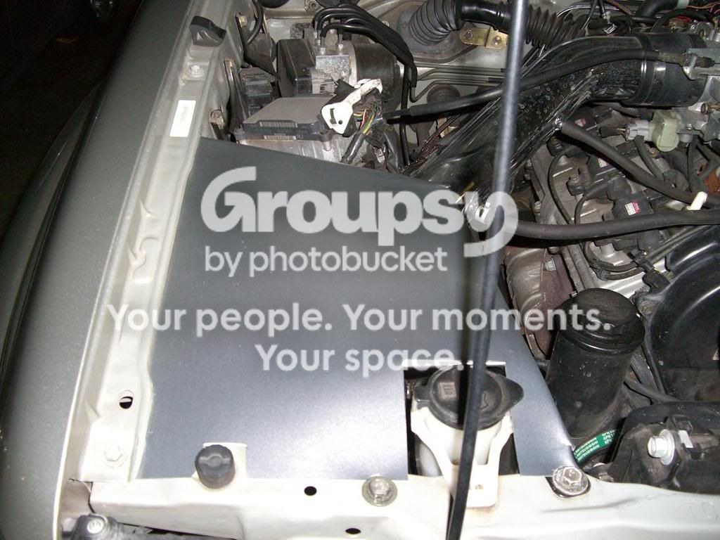

mikeinthehouse - I have an open cone intake similar to the K&N that many say is a POS at best. The benefit to this setup is increased airflow. The area surrounding the intake is restrictive to say the least, and that is why removing the intake elbow in the passenger fender is known to increase power. The downfall is that it sucks in hot underhood air... for which, I have done the following:

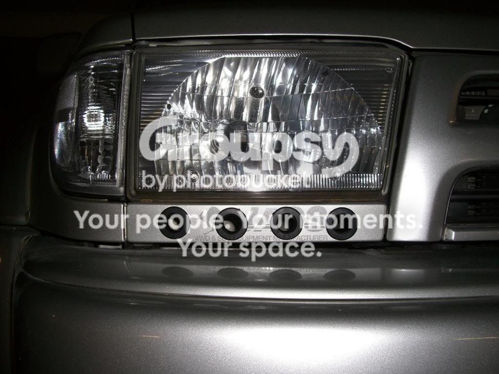

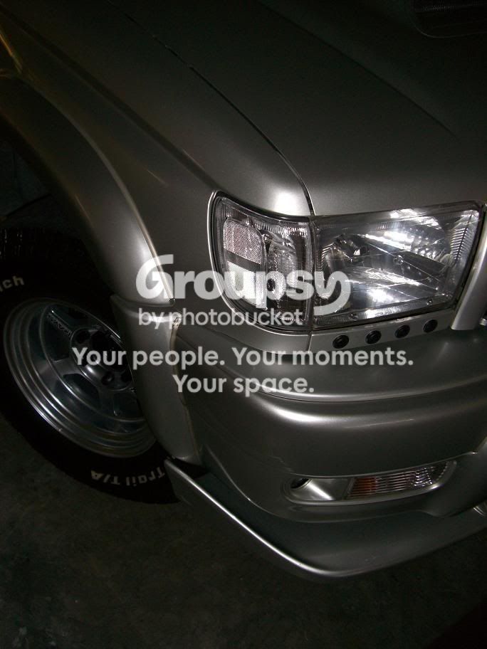

The supercharger generates a TON of underhood heat. To address this issue, I vented my hood scoop, and removed sheet metal surrounding the headlight to allow for more ambient airflow into the intake area. You can't really see it in the pictures, but a significant portion of the sheet metal was removed from under the headlight as well. I drilled four 1" holes in the exterior panel under the headlight, which I subsequently inserted hollow 1" rubber grommits for aesthetics. To keep rust out I used touch up paint and sealed the edges of the grommits with silicone. It gives the truck an aggressive demeanor and sets it apart from the rest of the 4runners in town. The intake came with a useless metal heatshield. I used pliable brushed aluminum to completely wrap the intake heat shield so that no underhood heat can seep in.
To top everything off I did the throttle body coolant bypass mod. The next time you pop the hood, take a look at the throttle body. There are two rubber lines running through the bottom of it. Normally, coolant runs through the throttle body heating it up to 200 degrees. No thanks. The supercharger does a great job of heating the intake charge on its own. Leaving the coolant running through the TB defeats the purpose of having a cold air intake setup. I've never heard of anyone with a 3.4L having trouble with this mod. It's free, and is easily reversible if you encounter a problem.
You might be hesitant to touch your throttle body after a run to the store. My entire intake setup/TB after any trip remains cool to the touch.
The truck is running the smallest supercharger pulley that URD has to offer without meth/water injection. It runs like a champ. No check engine light. No ping. When I hit the gas from a standstill, the truck spins all through first and hooks up somewhere in the middle of second gear on new BFGs. EGT is roughly 1400 degrees. AFR in wide open throttle is at 12. Nothing to sweat about. I attribute the problem free nature of my setup to the TRD 7th injector cooling the intake charge, and the intake modifications I have done.

IntakeHeatShield3.jpg~original
IntakeHeatShield2.jpg~original
IntakeHeatShield1.jpg~original

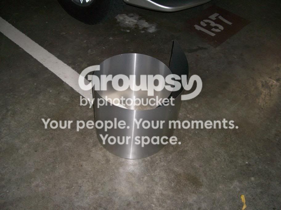

$10 for a 10 foot roll of brushed aluminum from Home Depot:
IntakeHeatShieldAluminum.jpg~original
