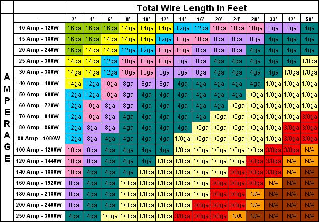

I disagree with anything over 20W needing to run new wire. I have at least 75W if not 150W RMS running to each speaker without issues, and my Kappas sound amazing. I have talked with more audio shops than I can count and they all told me it's not worth replacing the speaker wire from the center console to each speaker. The OE wires are sufficient to handle the power you need.
Good speakers have a capacitor to prevent alternator whine in the speakers. To avoid alternator whine, make sure you have a good ground on the amp (measure with multimeter). I have no issues with my setup whatsoever.
Running the wire 10 feet at 120W the chart (not sure of the author) says use 14G speaker wire.
I used 14G because I prefer to be well over on the safe side.
I'm not saying you guys should change your systems but if you are doing this from scratch it only makes sense to run new wiring because it is easy and cheap.
