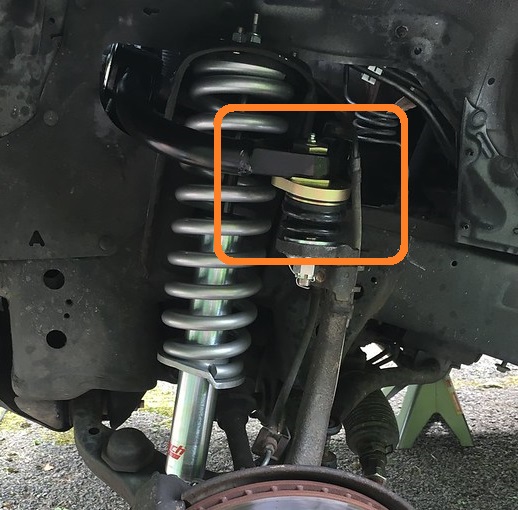

Noticed that you have your UCA ball-joint installed 180 degrees off...it is not the 'D' setting. May make it harder to align as the runner will want to sit like this \ /.

It's been a while since I took that pic, but I must have not had the upper nut torqued yet when I took that pic - it's definitely not sitting like that now. Maybe I was just happy to have finally gotten the old UBJ out and the SPC adapter pressed in after fighting with it for an hour, haha. Good catch though.
