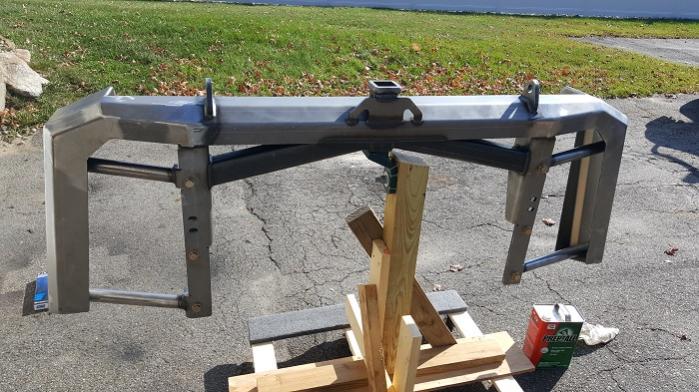

I sprayed primed then coated mine in satin black inside and out, then scuffed and Monstalined the outside. I made a rolling dolly stand with the trailer hitch, pulled the ball off for a bolt point to wood, can stick hitch on either side to flip up or down for easy painting.
Hey that's clever. I just bought a couple of HF saw horses and am making a makeshift paint booth in my backyard with an e-z up, some plastic sheeting, and an electric heater. I gotta get this thing painted today.
