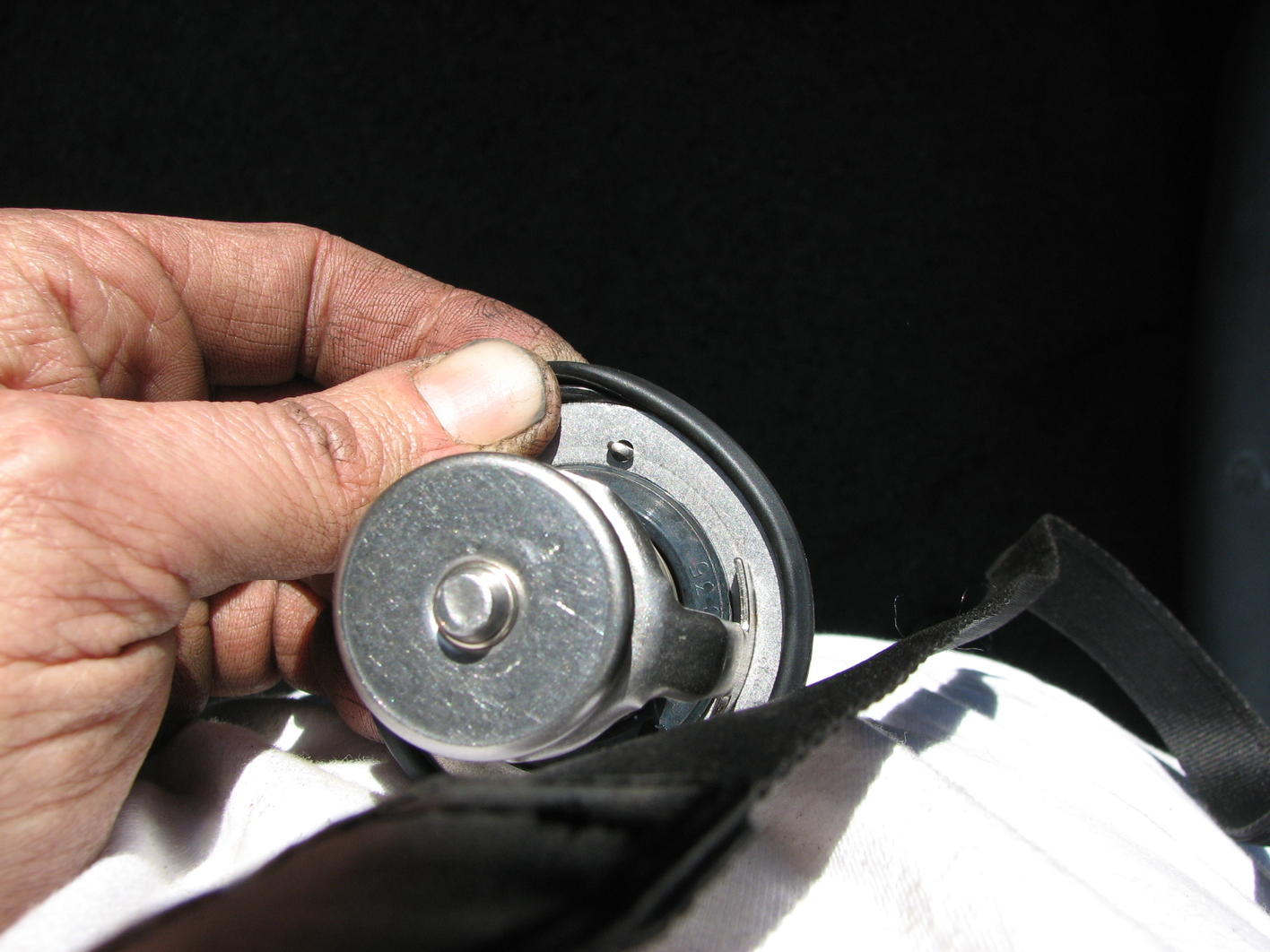

Looking for some help..
Got a new water pump for my 3.4 and it came with the paper gasket, the thermostat gasket and another o-ring that I cannot for the life of me figure out what to do with it...
It is 1-1/2" OD,1-3/16 ID. Anyone know where this thing is supposed to go?
Did not see one when I disassembled it.
Thanks.
Thanks.
This is the only o ring I know of for the thermo. Maybe the same thermo works for other applications and they gave you the oring for that. It would just be a throw away item if you don't need it.
