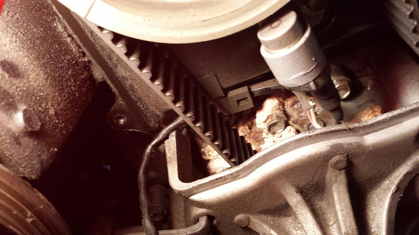

I'm sure about the belt, unless you live in the Mojave or some other extreme environment. Read the mega-thread on TB's on Yota-Tech; they rarely break on their own before 200k. I am less sure about the water-pump either locking up or leaking on the belt which will kill it in no time. I plan to peak behind the timing cover at 90k or so on the WP just for peace of mind or to move up the change if I see coolant leakage. At 180k, your factory WP owes you nothing.
Here is a picture of a factory WP with 102K miles on it. I decided to do the TB and found this when I was in there.
