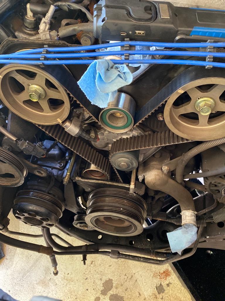

After a long wait, I finally have some time to do the job and alone. Do I have to remove the neg battery cable?
Done. Took me about 7 hrs. Not bad for one man noob. Thank you to all that helped
