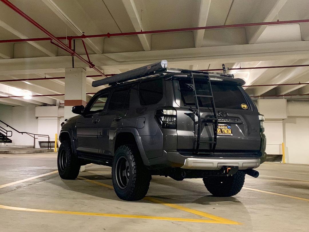

tinted tails
i love rice
The OE assemblies are sealed. You can't bake them open at all. Cut maybe.
The TYC lights are two piece with the same bonding they use for the headlights. Just bake and pop open.
TYC is what Kustom54, and probably others like Unique Style Racing etc are using.
USR sells Depo branded lights that are blacked out by Depo FYI
