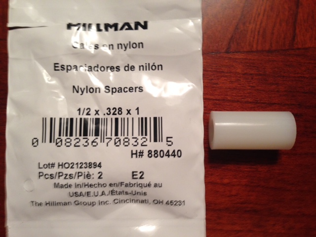

I've been lurking for some time and finally got a 4runner. I figured it was time to give something back to the forum. I replaced my liftgate supports with some Strong-Arm supports and as others have mentioned, they don't come with the "bushing" that is needed at at the end that needs to meet the liftgate. I was able to go to Lowes and find a nylon washer/spacer that worked perfectly once I cut it in half (one for each side). Here is a picture of the part from Lowes. Hopefully this helps someone else out.

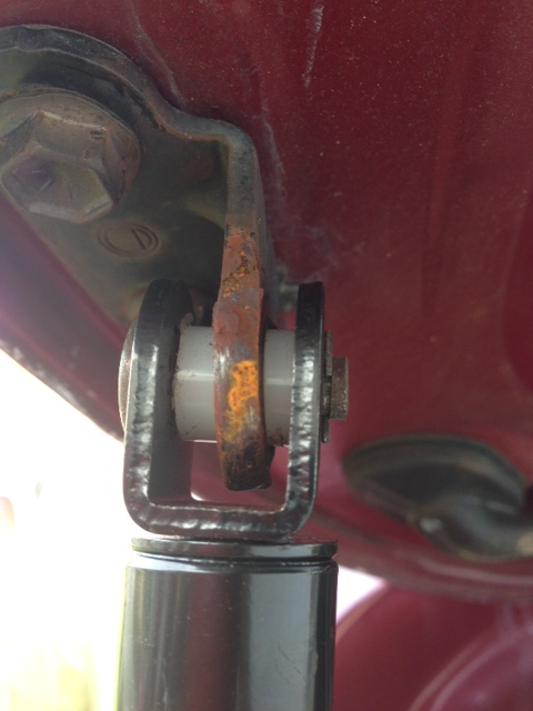

Here is a picture of the spacer and where it goes. I've only had them installed for a week so I can't really speak to how long the "spacer" will work but I think the Nylon is pretty strong and if not, on well, i can put another one on pretty easily.

It's the perfect length between the uprights of the lift support (when you cut one piece in half from lowes). There is about 1mm clearance between the spacer and the hole in the bracket that is attached to the lift gate. Just enough where is isn't loose, but there is still enough clearance for the bracket to move across the spacer when you open up. Hope that helps. Oh, the hole in my brackets that attached to the gate was a little bigger than normal due to the old bushing being toast and metal rubbing on metal before switching eveything out.
