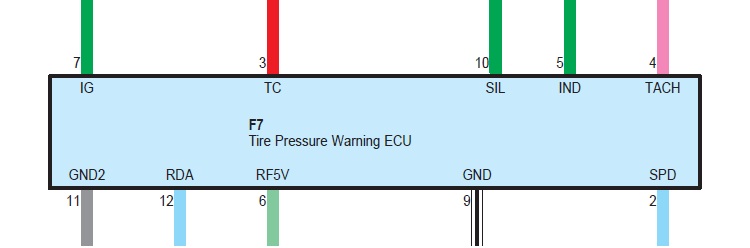

Nobody has traced the wires to the TPMS ECU to figure which wire to ground or ground to open to shut off the warning light on the 5th Gens...........yet. We have the wiring diagram and if Antman or someother spark chaser guru wanted to do it ,I have faith that they could.The only time mine bugs me is aired down offroad and it would be nice to have a switch to turn it off......hint ,hint ,hint.:eyebrows: I like that it's there when daily driving in case I don't notice a tire going down,and why wouldn't anybody want to know that?
I believe that installing a simple on-off switch in the green IND line, pin 5 should do the job but haven't tested it yet.
[EDIT]
The wire might work like the 4LO wire, in that is grounded to indicate active. In that case the switch would need to be double throw. For normal, the signal is handled as normal. For TPMS disable the signal from the ECU is disconnected and in its place either a pull to ground or a pull to high is used. The high voltage could be 1.8V, 3.3V, 5V or 13.8(vehicle's regular 12v).
[EDIT]

I remember seeing the 4th Gen schematic on how to do it but can't find it now as ours should be similar.
Not going to do it unless I know for sure. Could turn out like this if the wrong wire is grounded......
