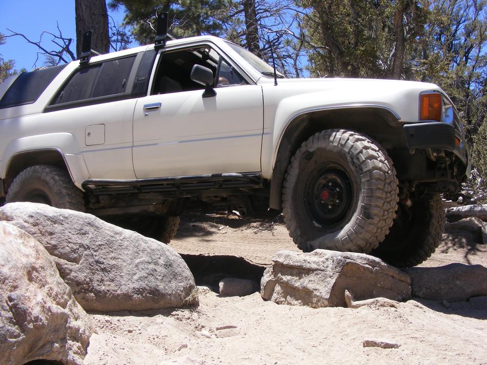

I'd go with 33/10.5 or 265/75. They will look way better and shouldn't rub too much if you do the pinch weld mod. :wink2:

here is the way i purchased my 92 sr5 "4wd" 33x 12.50 15's if you go with the 10.50 width tires you wont have the issue i have... but be warned that you will lose nearly all of your get up and go with the 33's on the street :( and regearing the front and rear axles to 4.88's would be beneficial
