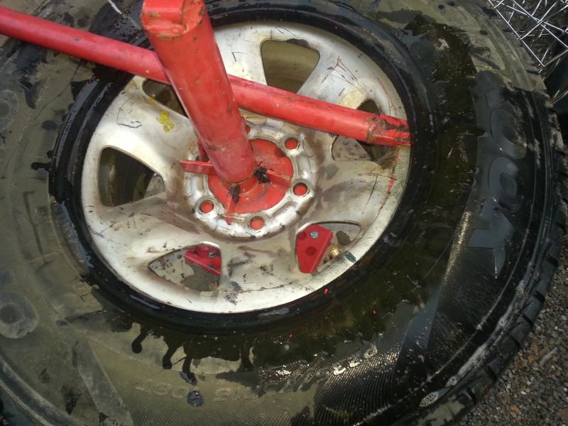

What I don't understand about tire tech is how to answer a relative's question about her tires and handling on windy mountain roads.
She goes through tires every two years, even though she drives like (and is) a little old lady.

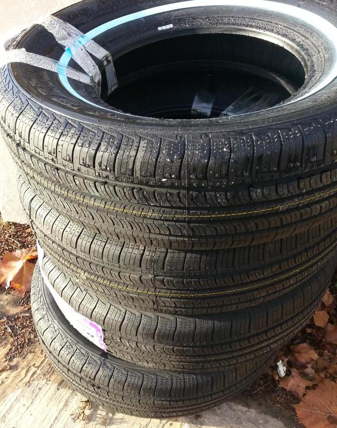

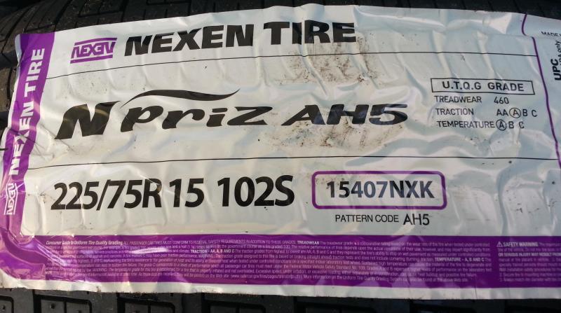

Up until now, she has been using P235/75R15 108T tires (Treadwear 700, Traction A, Temperature B) but we are switching her back to the stock size of P225/75R15 (Treadwear 460, Traction A, Temperature A).
230391d1481561333-advice-requested-those-you-who-have-mounted-tires-balanced-wheels-home-toyota_mounting_tires_01.jpg
She seems to get less than 10K miles for every UTQG 100 points in treadwear, so we expect these new tires to be worn out in less than 46K miles (i.e., 460% of 10K).

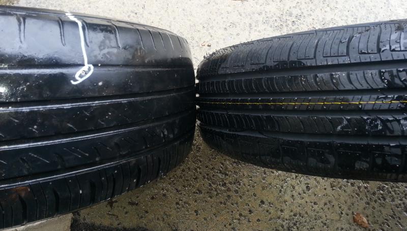

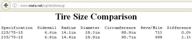

But my tire tech quesion is how to answer her when she asked me how these two differently sized tires (old and new) will handle on the one-lane 30mph windy mountain roads she drives every day?
230750d1481751039-what-would-you-tell-owner-expect-handling-changes-between-these-two-tires-0_tire_size_handling_question.jpg
230395d1481561348-advice-requested-those-you-who-have-mounted-tires-balanced-wheels-home-toyota_mounting_tires_05.jpg
Based only on the SIZE difference, and knowing that she drives mountain roads, what would you tell her the handling characteristics will be between these two tires?
  • (old) P235/75R15 108T (this is the stock OEM size)
  • (new) P225/75R15 102S
