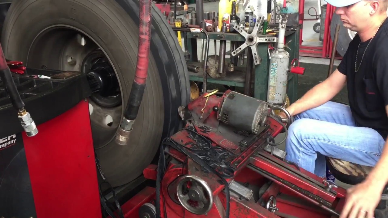

Anyone ever had tire truing done to a new set of tires? They basically mount the tires then shave down the high spots so that they are perfectly round. Then they get balanced. The result is perfectly round and balanced tires. There are some cons like not able to rotate the tires (truing & balancing is done with the wheels mounted on the vehicle).

Haven't had it done, but looked it up a while back as my F150's 35's had an out of round tire. I thought they were done on a machine that had the scraper device that does the truing at an equal distance from the center? And why would it matter which corner of the vehicle it's on after since the wheel and tire unit are now balanced?

Learned how to do it back in my consumer car repair days. There are different methods, one of which is with the tire/wheel assembly still on the vehicle.
It's rarely done anymore, because tire construction and inspection during their manufacture has improved.

I haven't heard of this being done in like 30 years. When I get a tire that can't be balanced correctly with repeated tries on a road force machine, I have them warranty replace that tire.
Update - I ended up taking a chance and had a local tire shop road force balance my tires instead of taking them further to have them trued/shaved. They are now almost perfectly smooth at all speeds. The tires are OEM Nitto Terra Grappler G2's with 41k miles on them and I've had the steering wheel wobble since I bought it new. It was really bad when I first got it but the dealer worked on it and ended up swapping out 2 tires. It was never perfect but good enough that I was tired of dealing with it and didn't want to keep taking it back. It had gotten worse though in the past year. So I'm kicking myself for not getting it sorted out sooner but the upside to this is I have found a good shop. I will be hitting them up in 10k miles or so when these tires are done.
