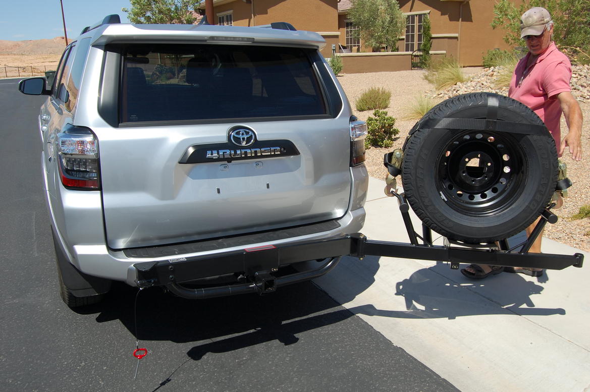

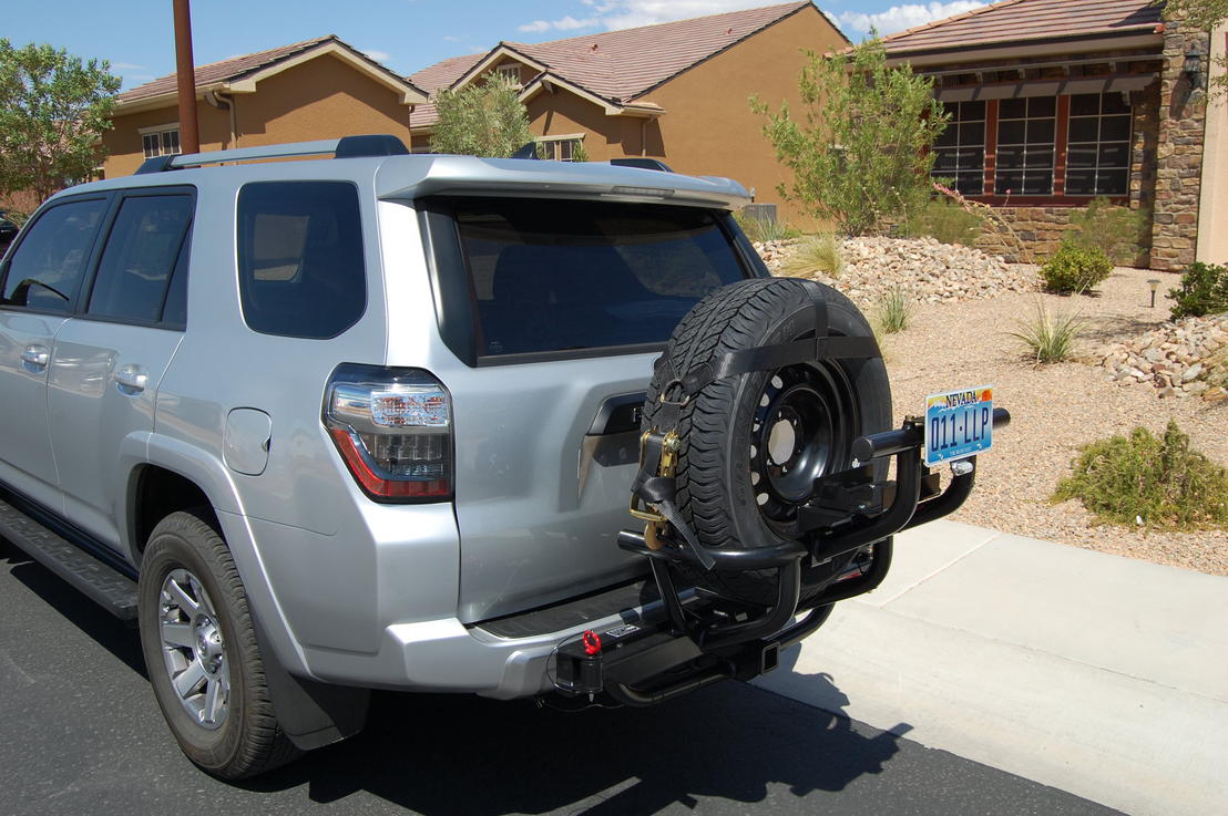

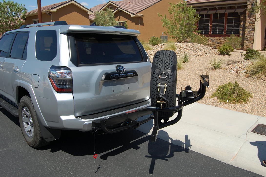

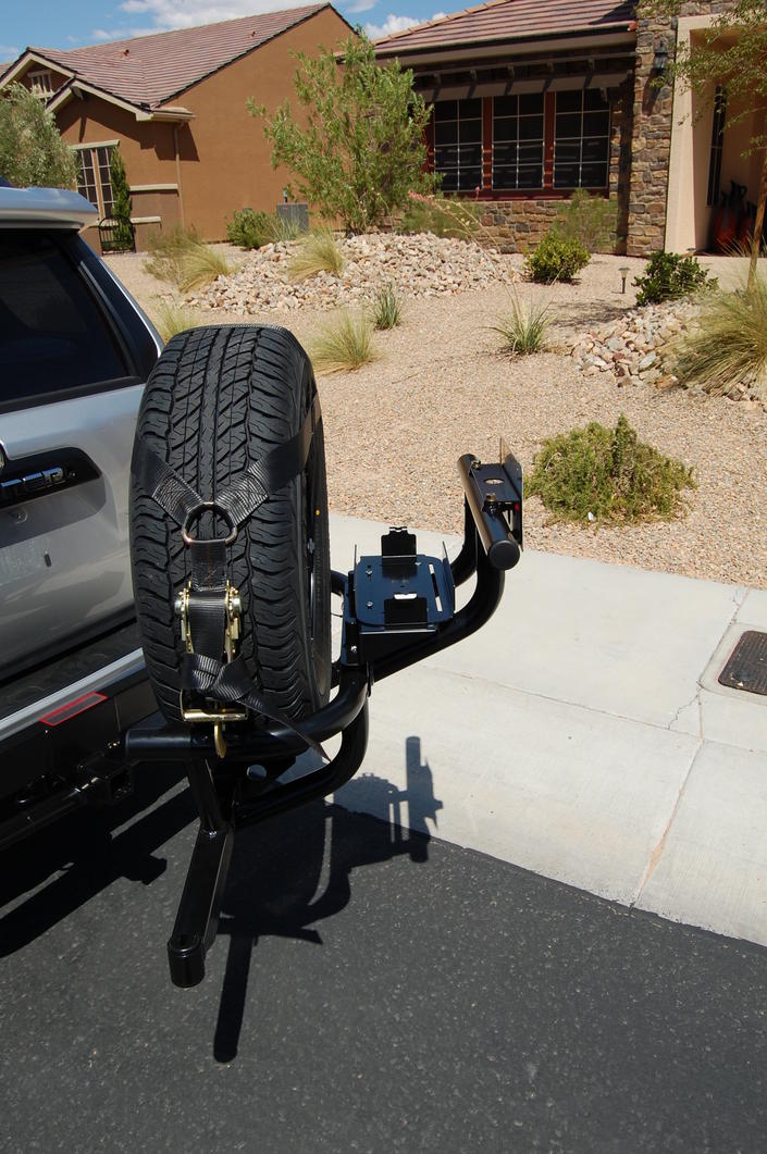

Last week I called Tiregate and asked if I could bring my 2014 4Runner to their factory and have an Adventure Series Universal Hitchgate attached to my car because I was very skeptical about the ability to mount the unit in the towing receiver of the car and not have the Hitchgate wobble. I spoke with Lisa who was very accommodating. She said she understood my concerns and they would be more than happy to test fit a Hitchgate. On July 22 I arrived at the factory in Santa Ana, California. Lisa had lined up Derrick to do the installation. A “factory test unit” in center mount configuration was installed on my car to see if my tailgate would open. I wanted the center mount configuration, however Tiregate’s web site cautions that an offset configuration may be required for tailgates over 53”. The tailgate on my 4Runner is 55” when measured below the tail lights. The center mount configuration worked perfectly, allowing the tail gate to open, however with minimum clearance when the Hitchgate is swung fully open.
Derrick removed the "factory test unit" and installed a new Hitchgate on my car. He is also the person who manufactured the Hitchgate he installed. Can't get any better than that! He showed me the design of the unit and why it would not wobble. He explained the stress tests that were done on the unit to ensure all stresses were mitigated and accounted for in the design. I’ve been in the aircraft and aircraft jet engine manufacturing business for years. I was very impressed with the design of the Hitchgate and its method of mounting in the towing receiver to ensure the mount is tight and wobble free. The quality of Derrick’s workmanship is also outstanding. I took home the Adventure Series, Centered, Universal Hitchgate with the single Jerry Can Mounting option and the License Plate Relocation Kit. I also got the locking pin for the towing receiver, and the chain/lock for the tire to secure it in the Hitchgate. Two of my “technically savvy” neighbors looked at the Hitchgate and were very impressed. I had considered replacing my rear bumper with an aftermarket bumper, however after seeing the Hitchgate I decided against spending twice the money and having to cut my plastic bumper trim to accommodate the aftermarket bumper. With the Hitchgate option I have a stock car that is easily converted for off-road use, and can later be sold/traded as a stock car. I ruled out putting the spare tire on a roof rack because I'm 66 years old and my back is not in the best of shape. The spare tire is easily placed in the Hitchgate when the Hitchgate is swung away from the car. Yes, I still have the factory spare tire installed under the car, however for peace of mind I carry two spares. I could have a 100 mile walk in the Nevada, Utah or Arizona desert should I have two flats, and I have been told people have gotten two flats.
If you want to keep your car stock, I highly recommend the Hitchgate option. I have yet to purchase the Jerry Can so the attached pictures are without the can. The Jerry Can sits behind the crossbar to which the license plate is attached. The pictures on Tiregate's Website of the single Jerry Can option installed on the Adventure Series Hitchgate are not reflective of what I was provided. I think the option I was provided better protects the Jerry Can from damage. When purchasing a Jerry Can ensure the can fits in the mounting bracket. The Jerry Can I liked the best was 5/8" too wide to fit in the mounting bracket. Additionally, Tiregate has hold-down straps for either a metal can or a plastic can. You have to chose which strap you want. Both are not provided.

I'm not sure if I'm confused or the poster is confused. Tiregate.com offers different options to mount the spare tire. The pictures in the second post appear to be another option offered by Tiregate, not Baja. You will see the second option posted on Tiregate's Website. I did not choose the option in the second post because:
1. Ease of placing the tire on the mount as perceived by me, and the condition of my back.
2. I did not want a gas can up against my tailgate. I wanted 5 gallons of gas as far away from my car as possible in case of a rear end collision. I've been hit twice from the rear so I'm very sensitive to what can result.
I don't know what option Tiregate offers to mount a license plate on the second option pictured. It appears the driver of the Baja vehicle could be subject to a ticket for not displaying a rear license plate, however I can't see the complete rear of the car so maybe the license plate is displayed. I can tell you the license plate mount on my Hitchgate has a light.

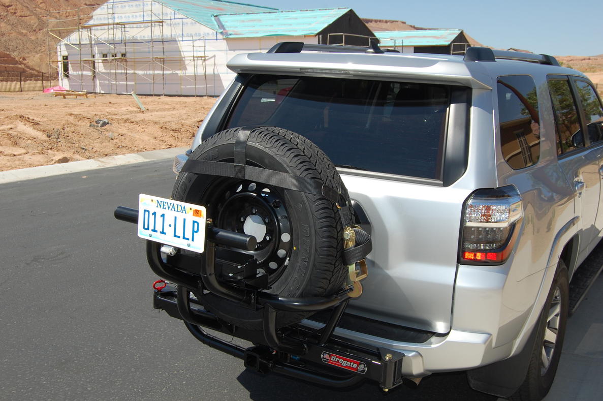

How's the license plate light connected/wired? I see something at the bottom of the swing out but not quite sure what that is.
Can you take pics of the connection/wiring?

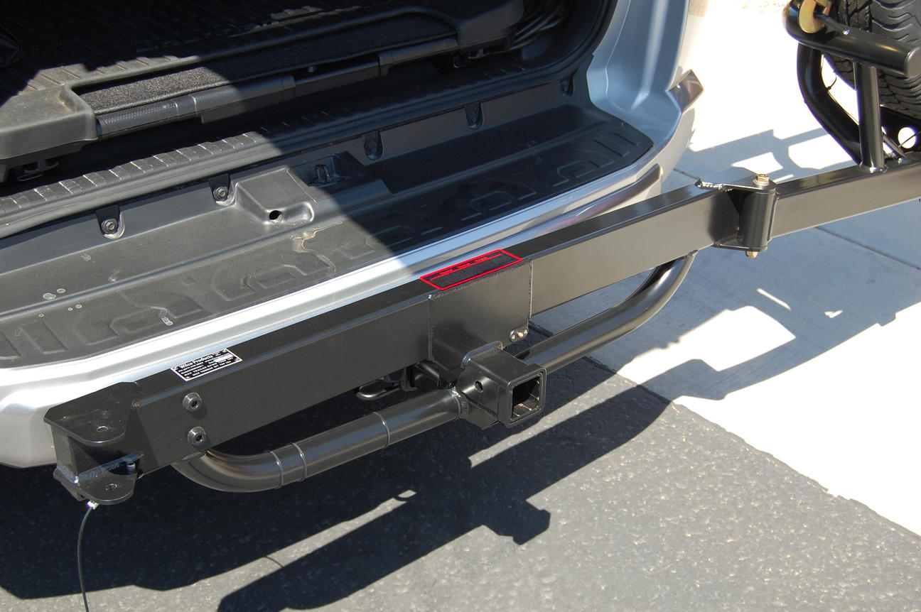

OP could you post a pic of how this is actually connected to the hitch? I'd like to see "why" this thing won't wobble...
Similarly, what's the construction like? I live in a very rainy climate - most things rust out here pretty fast when not made very well :nono:
Licence Plate Light and Wobble
The license plate light is wire to the standard trailer electrical junction box located under the car that came on the 4Runner. I did have to buy the piece that plugs into the junction box. See picture.
It won't wobble because of the "wedge" piece (gold color in picture) on the end of the tongue. When the Hitchgate is installed in the receiver you tighten a bolt from the opposite end of the tongue that pulls the "wedge" forward and upward. Once tightened the tongue is firmly in the receiver. Additionally the pin is installed to "lock" the tongue in the receiver. I was very impressed with the "engineering thought" that went into the design.

Licence Plate Light Wiring
I forgot to mention the design of the electrical circuit. The license plate light is mounted on the swing arm portion of the Hitchgate, and electrical power has to come from the car. A person might wonder how long the electric wire has to be to accommodate opening the swing arm to full open position.
If you look in the 4th to 6th pictures from the top I originally posted you will see two small round balls in brackets on both the bottom of the swing arm (near the person's foot in the 4th picture) and to the right of the Hitchgate receiver port. When the swing arm is locked closed those two balls come in contact (they are spring loaded), which makes the electrical connection. Another smart engineering design!
For the person in the rainy climate, I'd want to keep those balls well maintained with electrical contact cleaner to prevent corrosion.
My 4th gen has a 55.5" opening do you think that the center swing out will clear? Reason I don't want the offset is because I don't want it in front of my Gobi ladder.
