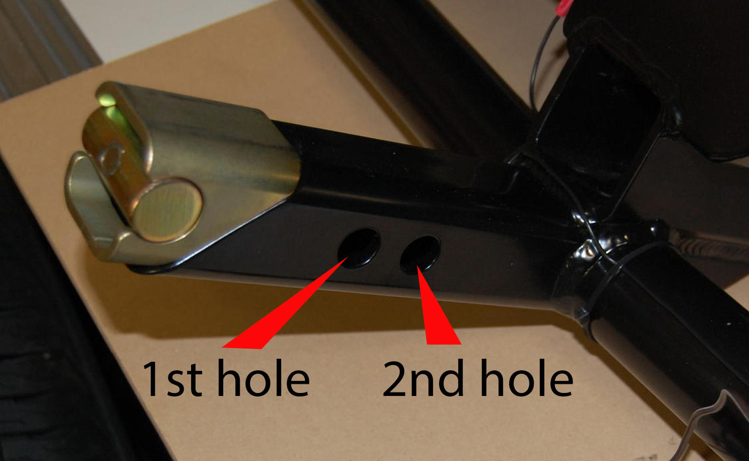

For anyone that has the Wilco Offroad Hitchgate, were you able to push the tongue in the 1st hole or have you successfully been able to push it in further to the 2nd, outter-most hole? The 2nd hole would mean the hitch gate is in tighter and closer to the rear bumper, which would improve departure angle slightly from the first hole.
I bought the Wilco Offroad Hitchgate for my 2016 TP and I had to remove my OEM spare tire for the Wilco tongue to have enough entry clearance, which is fine because the new 33" spare will be on the hitchgate anyway.
When I tried maneuvering the tongue into the deepest position, to the 2nd hole, the wedge block is just barely still inside the receiver on the back side so I felt it was safer to torque down the tongue with the wedge block at the first hole, where it sits a little deeper within the receiver. I'm curious if anyone has actually pushed the hitchgate in, up to the 2nd hole and if it's worked okay without the hitch or the wedge block coming loose.

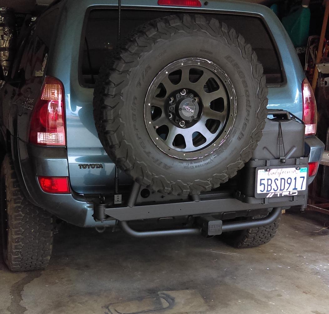

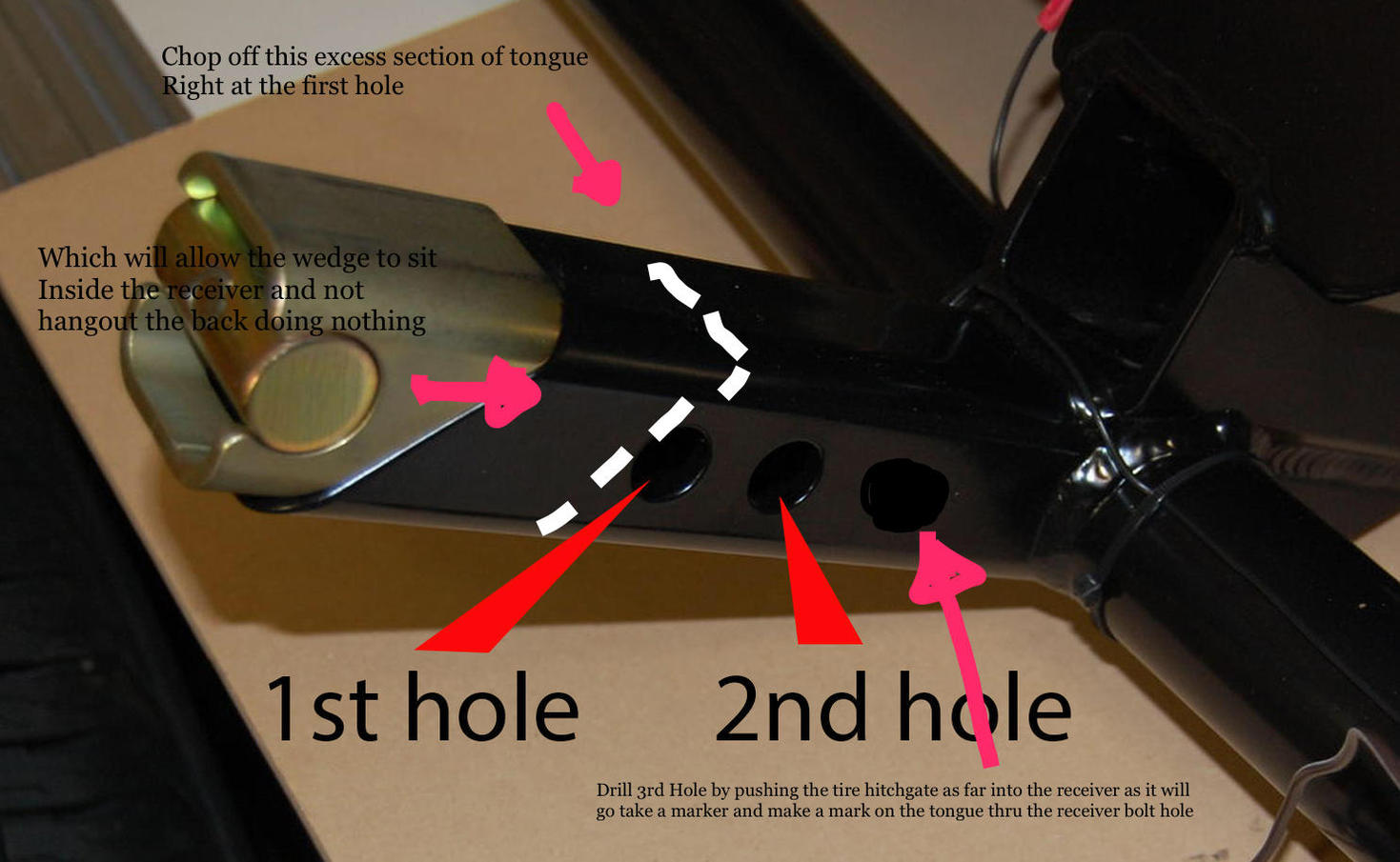

I actually made a third hole to get the tongue all the way in for these reason of better departure, tongue weight balance and for aesthetic purposes. I can't stand how far they stick out past the rear of our rigs.
Then I chopped the tongue up to the first hole for the wedge block to sit inside the reciever like it was designed.
Also for the new 3rd pin hole added I went and picked up a grade 8 3/4" Dia. bolt, washers and nylon nut as my new pin which has zero play with the hole opening so no slopping around.
And bam the tiregate modified for a perfect look and fit the way it should have been made.

Thank you for the reply. Brilliant idea to cut the tongue shorter and add a third hole. Would love to see pics and also the process and tools you used to chop the tongue and drill the new hole. I think I'll do the same on mine. I can't stand how far back it sticks out, killing departure angle.

Super helpful!! Do you have any shots of it in your 4Runner after the modification and did you take their to be done at a welder etc?
Once I figured it all out, I went ahead and did all the work as well..haha

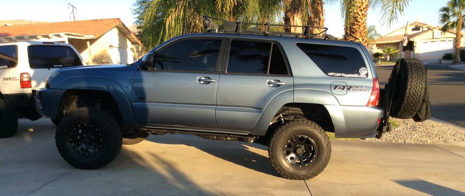

I've done much more to my tiregate than just this mod
This is the tiregate as ordered from Wilco. No mods besides the antenna and the antenna mount.

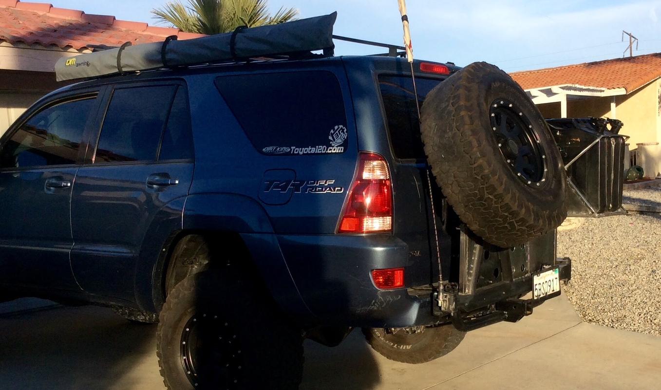

Here's another shot of the tiregate with no mods done to it. You can see it sticks out like 2ft off the back of the rig ....looks like doo doo and that's when I got to thinkin...
Notice the tire straight up and down as well.
