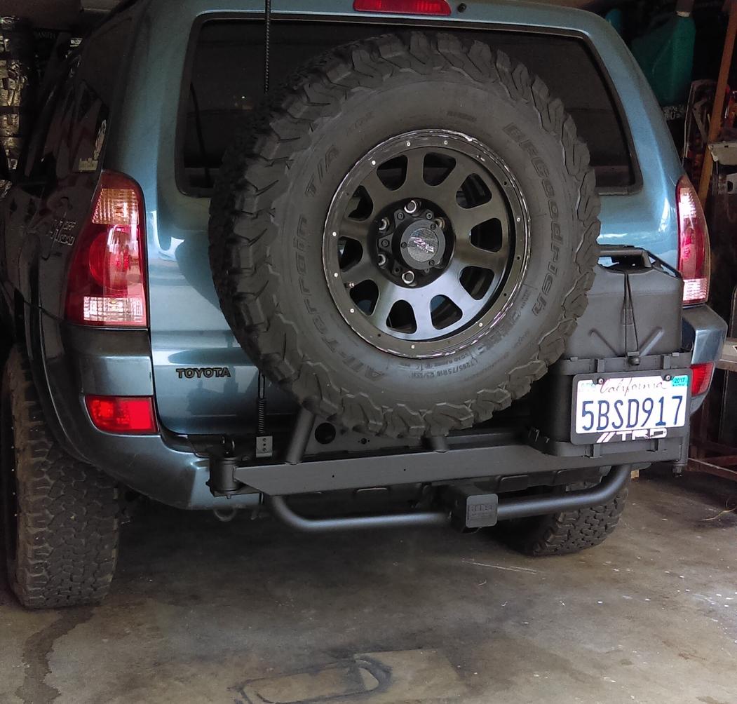

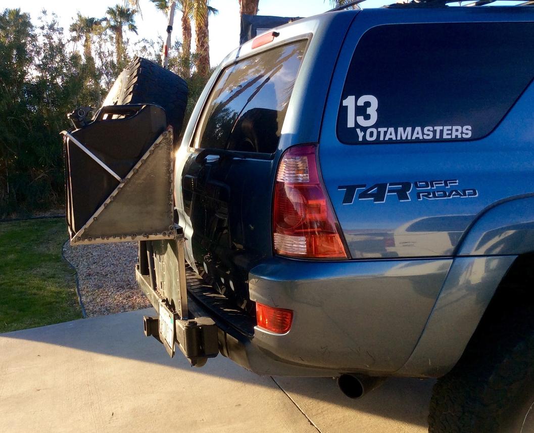

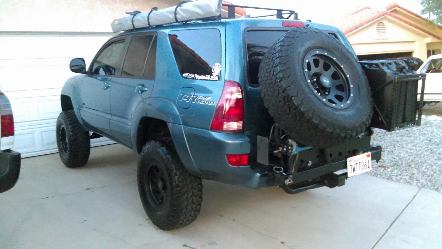

So here is where I had things all mocked up and and some what fitted into place
As you can see now I have just enough space for my arm between the tiregate and rear hatch.

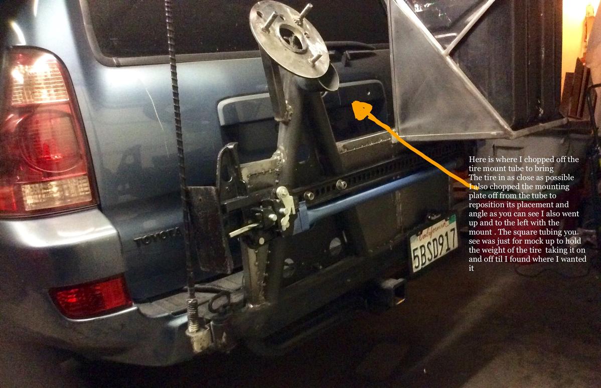

So there's two places ou need to chop in order to get everything as close as possible ..one is the tongue going into the receiver and drilling a new hole and two is the tube that extends out for the tire mount which I will attach a photo of.

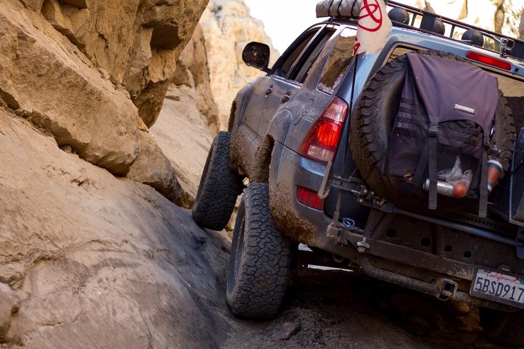

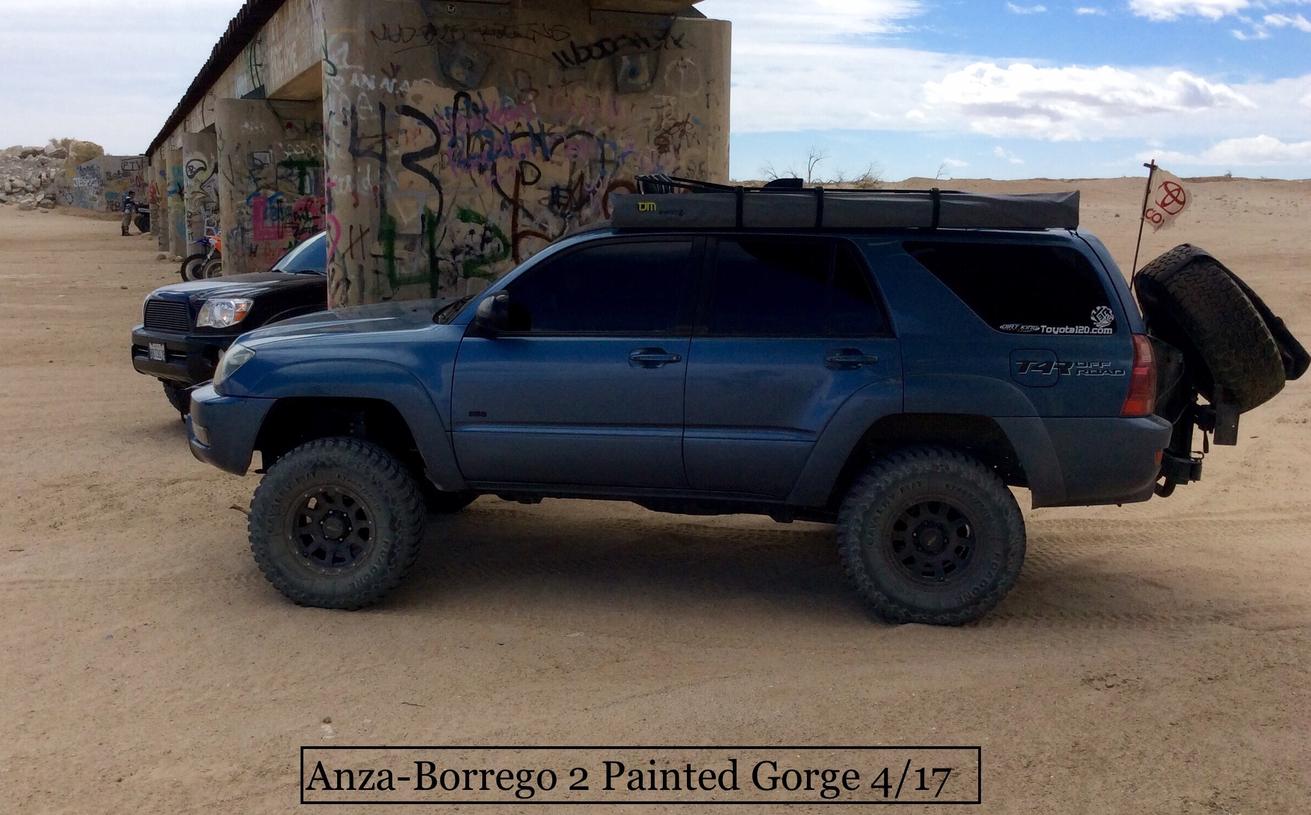

Here's a shot while wheeling you can see it don't shift around or nothin and that's also a 285/75/16 on there the first 3 pics are with a 265/75/16

Also I added a hinged fold down table that behind the tire area also a mount for the base to my hi lift and a mount for the hi lift tire attachment
