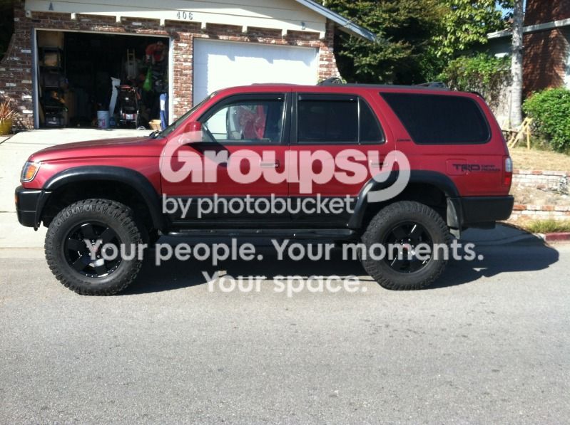

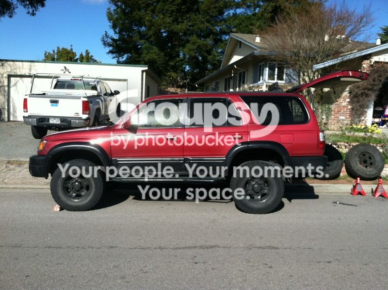

In regards to 265's or 285's, definitely go with the 285's. I've had both with my lift and while I didn't mind the 265's at all, 285's just look so much better. They fill out the wheel well a lot better and allow greater ground clearance. Also there is some power/mileage loss, but nothing unbearable.
265's -worn out
285's with Duratracs
