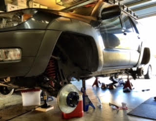

Front end completed;

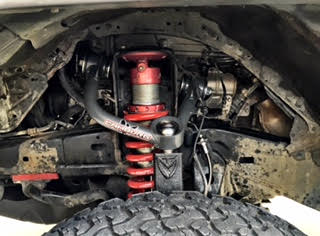

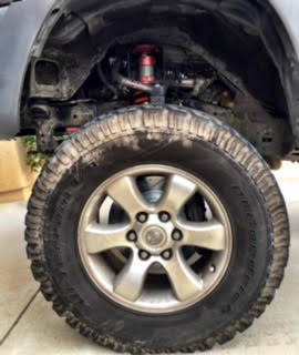

Suspension;

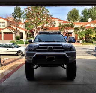

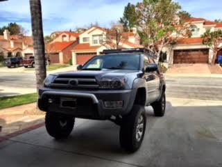

Back on all 4s;

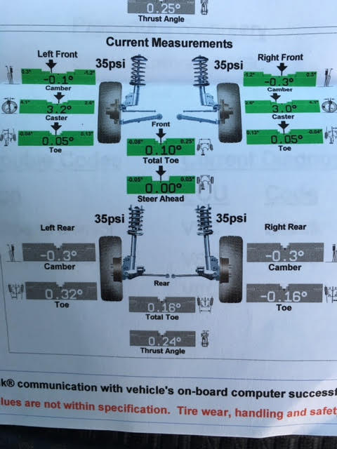

I just picked it up from getting an alignment and I am at about 6" of lift in the front. 4" from the spindles and 2" from the 2.5 Coilovers. :lookout:
Nice set up. with that much lift in front you might want to go 3 LT icon's or metal techs springs in the rear and maybe a daystar on top. Your still gonna have to do a BMC and pinch weld for sure. Body lift is a maybe cause you can just crank up your camburgs
