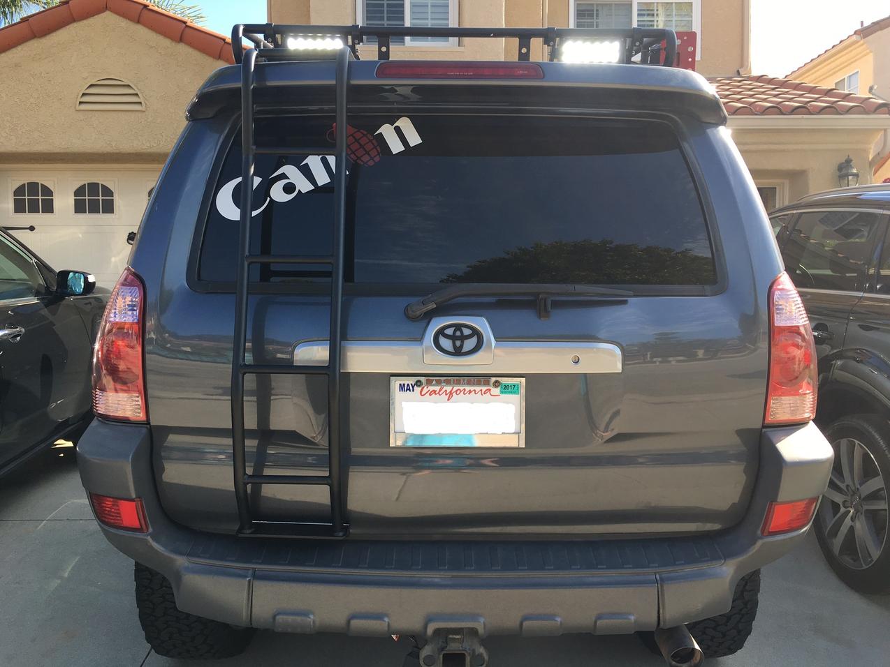

So I got my Gobi Ladder installed this weekend. It is super convenient to getting things on and off my roof from the rear, especially because with the body lift, my rear bumper is at a slant.

Those of you running reverse/rear lights, where was your point of entry to keep the wires hidden? I think I am going to pop my interior door sills and run the wiring under there, but before that point (cargo area), where would be the best place to run it? I will post some more pics when I get around to wiring them, but here is what they look like for now.
I drilled a hole through the roof on the driver side rear, under the roof rack end cap. I only have 2x 18w's, so a thin wire was plenty (I think 14ga). Used a liberal amount of silicone and I have not had a leak in the ~2 years since installation.

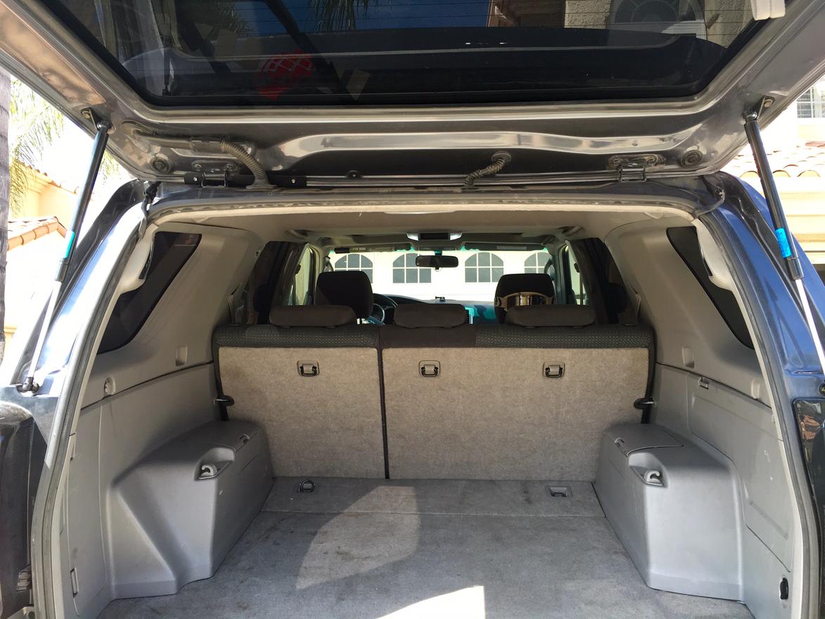

New Hatch Struts

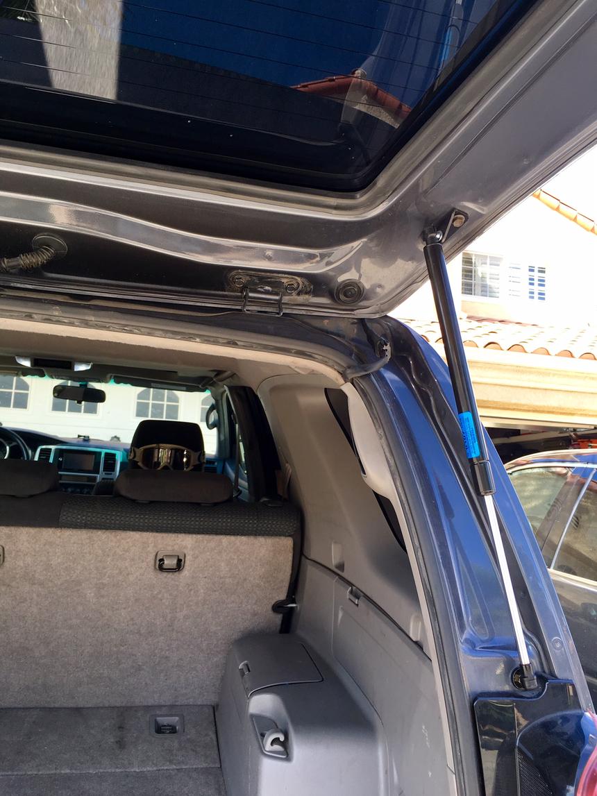

After adding my Gobi Ladder, the hatch just didn't open up like it used to. It was much slower and didn't open up completely without some assistance. So I bought and installed these StrongArm (part #: 6107) hatch struts. Let me just say, "wow!" Night and day. Opens up like it's supposed to and opens completely without any help! Plus it was a super easy install.

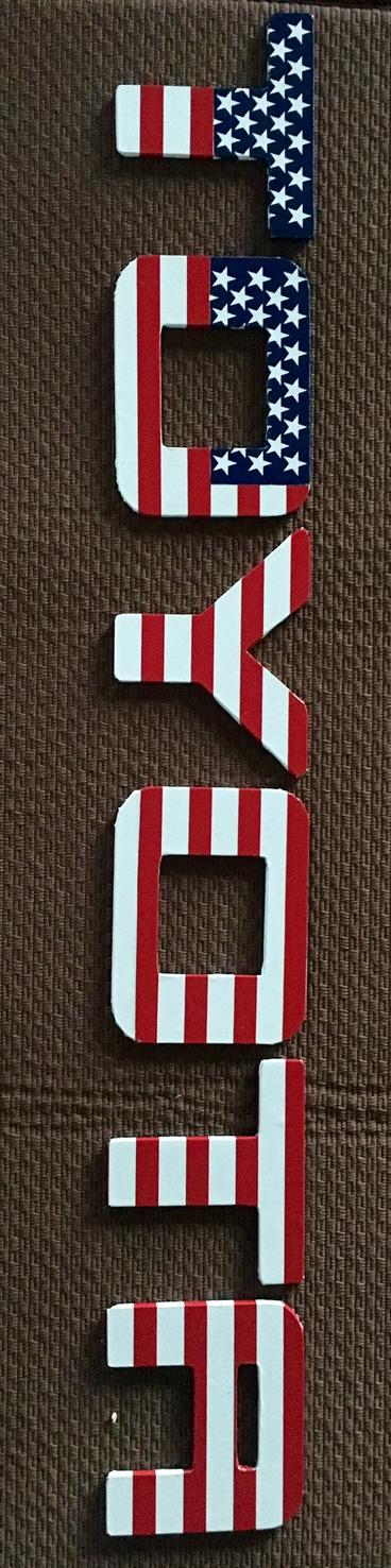

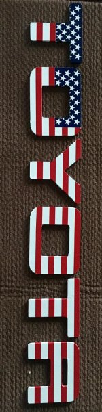

So I have officially started my Satoshi grille and here is the first piece of the puzzle. The Emblem::usa2:
Here you have some "Raptor Style" lettering wrapped in the beautiful colors of Red, White, and Blue!

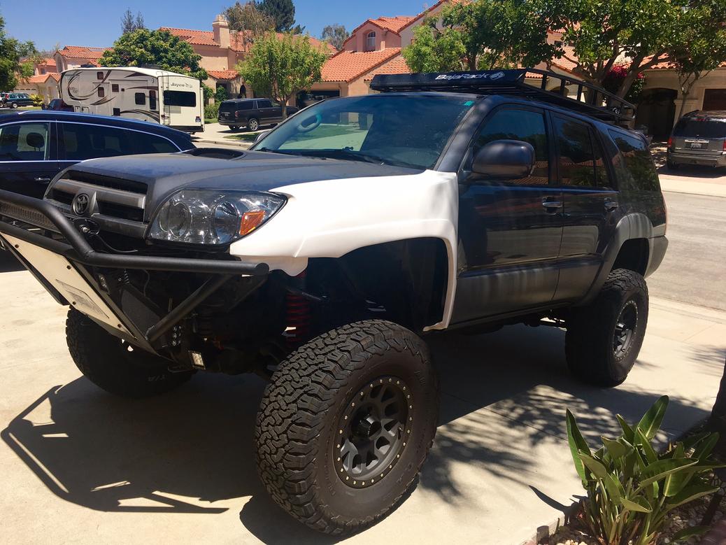

Fiberwerx Fenders

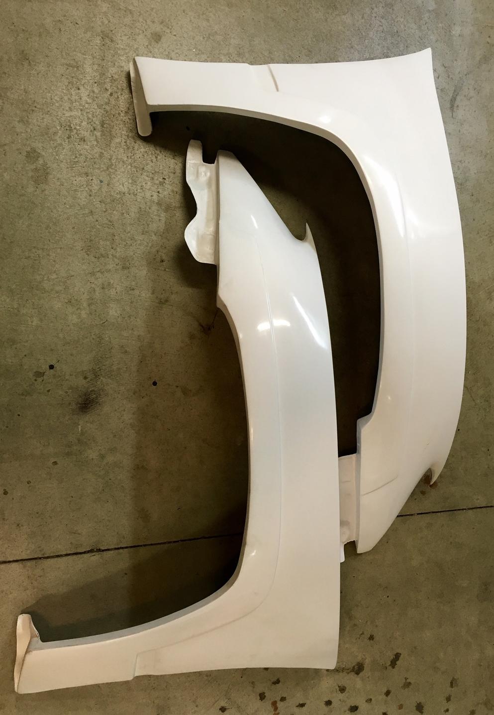

I also picked up these beauties yesterday. I hope to get these installed in the next few days, as they will sexify my T4R!

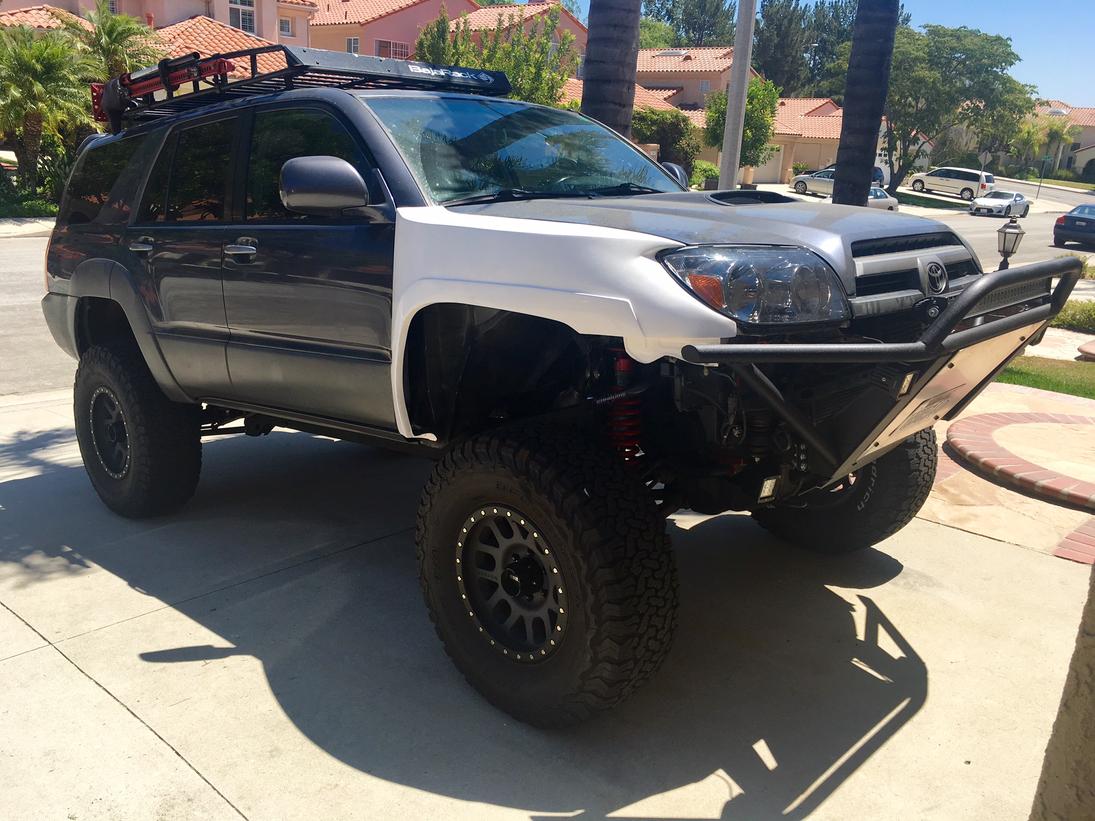

Fenders & Exhaust
So I installed these on Friday. It really takes a lot of measuring and massaging to get these to fit nicely, but I am happy with the end result. Now I just have to get them painted. I am sure I will get annoyed with the white within a week or so...

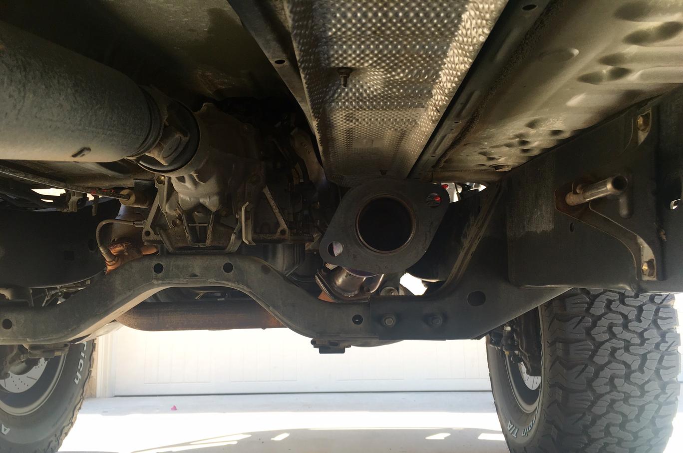

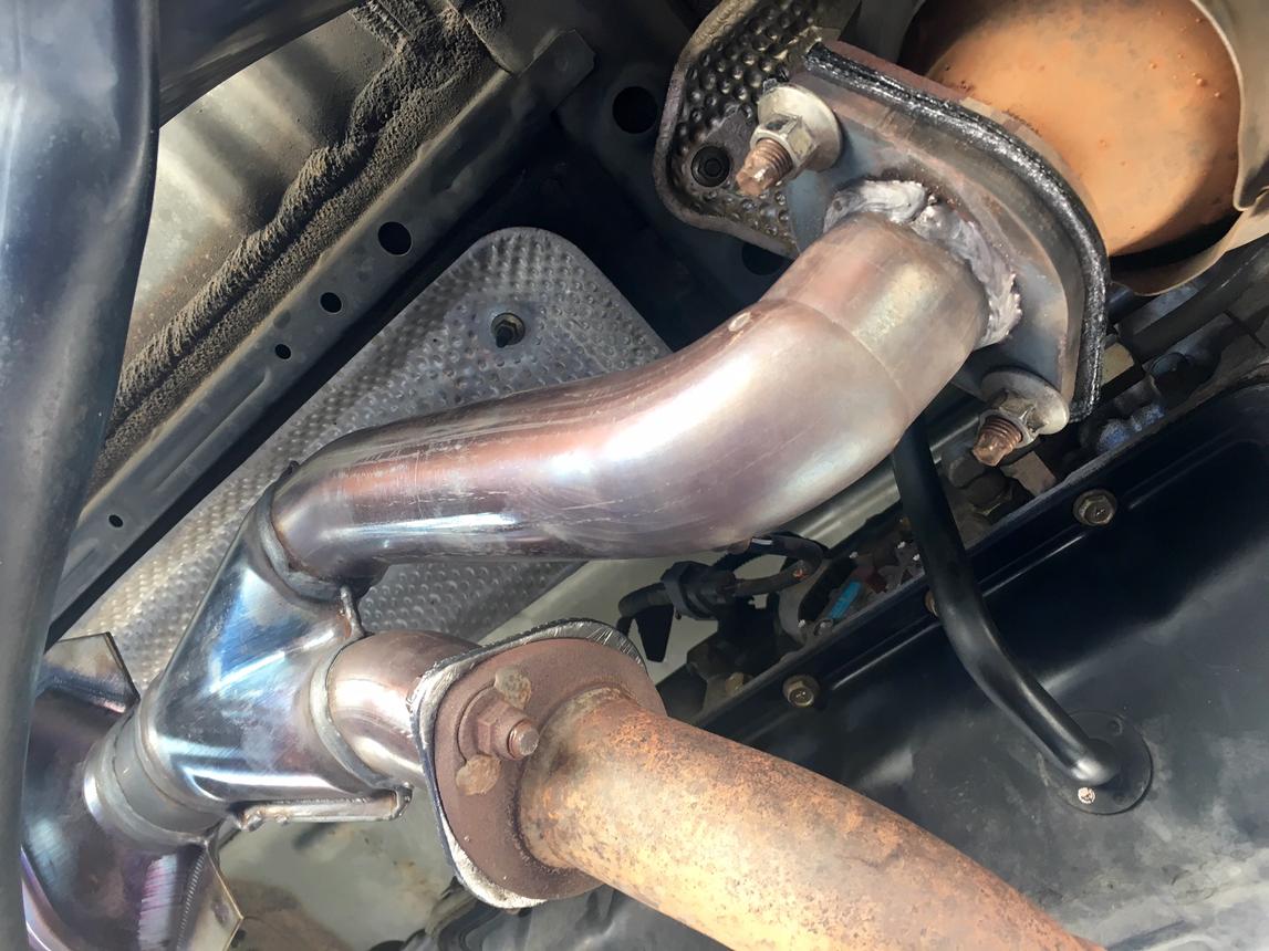

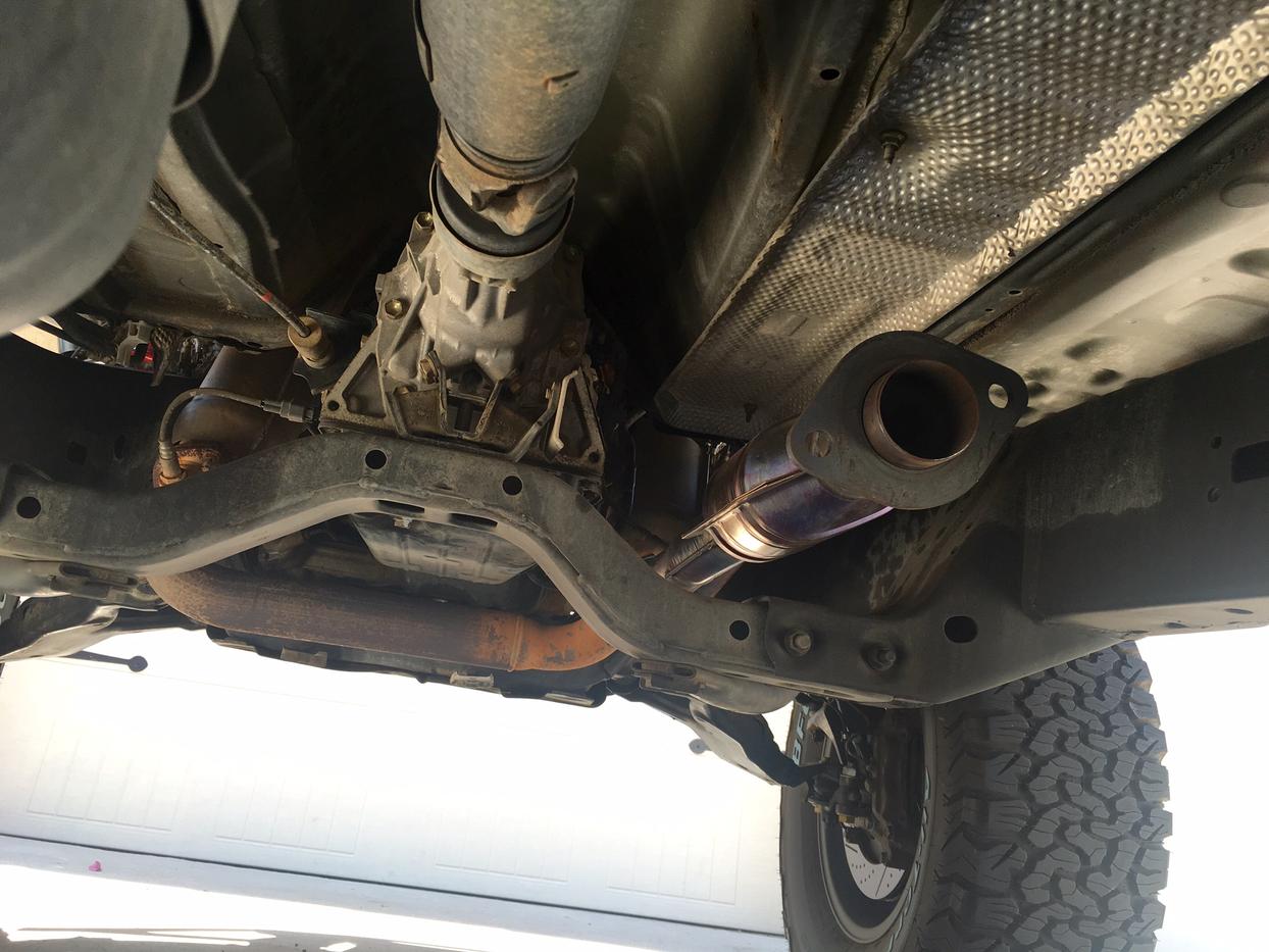

I also had some air escaping between my header and Y-Pipe, so I installed some Remflex 6005 exhaust gaskets. They sealed it up and no more leak! I had an issue with one of the nuts that stripped, but had some good ones left over from removing my bumper...good as new!
After I installed my gaskets, I wanted to see what the exhaust would sound like if I removed it (running just header + crossover pipe + Y-Pipe) and holy hell! It sounds fierce! My neighbor came out side and thought that it was the supercharged Camaro, haha! I will try and get a sound clip loaded up later.
