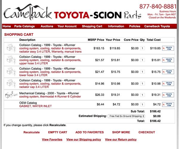

A screenshot of what I ordered, but captured from their main website. The same login won't work, so need to register at that site too...
Radiator, upper & lower hoses, rad cap, t-stat and t-stat gasket...

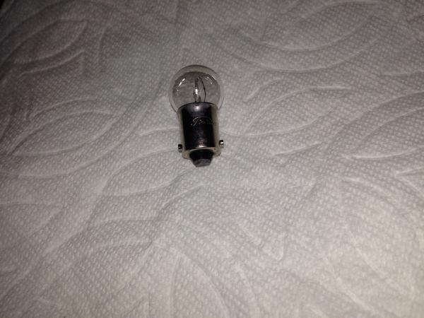

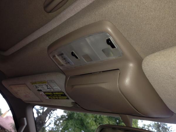

A follow-up from a few posts earlier... The map lights in my 2000, and the bulb within, not the festoon type, as a popular bulb website indicated:
Seems that it might be a 1142 bulb. I'll need a magnifying glass to read it...

Turns out my map light bulb was the same as yours, BA9/BA9S, but I also ordered Festoon bulbs as per the myriad of sites out there saying that's what we needed. I bought something like this off ebay for the map lights and they are way too bright for my liking. I'll wait to see what you do :cheer2:

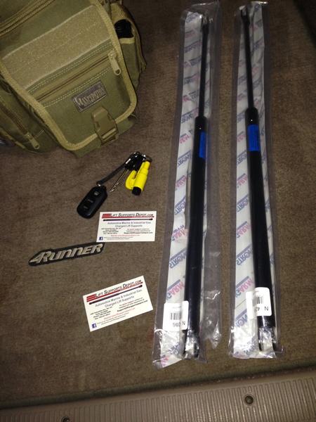

Will install these later today:
What kind of lift did you get for the rear hatch? Can't really tell from the pic.
I got the StrongArm off amazon. Great reviews and made in the USA (I think they're based in So. Cal). Also comes with a warranty but don't remember what kind.
Don't know if they'll last as long as the OEM ones but I'm hoping at least 100K.

These are StrongArm alright. I think it was Mike who recommended them earlier in this thread. The kind of "mod" that I can do at this time too, and the price is right also...

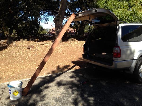

The 5-gallon bucket was pretty full of rain water, so fairly heavy.

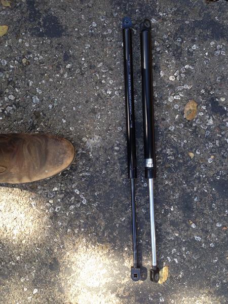

Straight-forward install. Should have had new retaining clips ready though, and whatever hardware is recommended too. Both of the tops had some type of broken sleeve inserts and one of the bottom one had some type of washer (the other bottom did not). I'll figure-out what should be there, and add those later, along with new retaining clips.
Each of the struts I removed was different:
That all said, these open the rear hatch all the way. Takes more force to get it down, but a worthwhile trade-off, IMO.

I made a stand for the lift gate out of a scrap board that I propped the lift gate up against the rear bumper - safer than something on the ground that could slip.
The upper factory mounts use a delrin bushing that cracks and crumbles over time. This bushing is not sold by itself, it only comes on the shock assembly from Toyota for $285 per side. I harvest them from the junkyard, but most are just as bad - I'm looking for an alternative source for replacement bushings.
The lower mount has no bushing, just spring washers to quiet the pin from rattling.

Yes, I could have supported it better, but my 2x4's are needed for part of a house project (constructing walls). Didn't have anything else that was scrap, so there you go. I was going to back the Runner near some dirt and simply dig a little ditch for the wood, but this did the trick. Actually, even without but bucket, it was wedged pretty damn tight.
