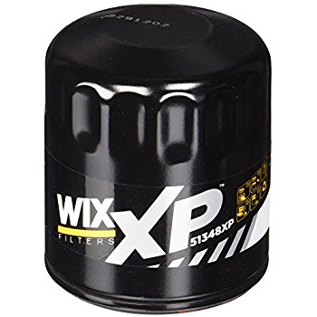

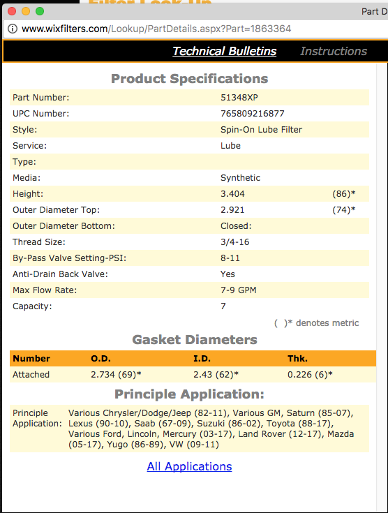

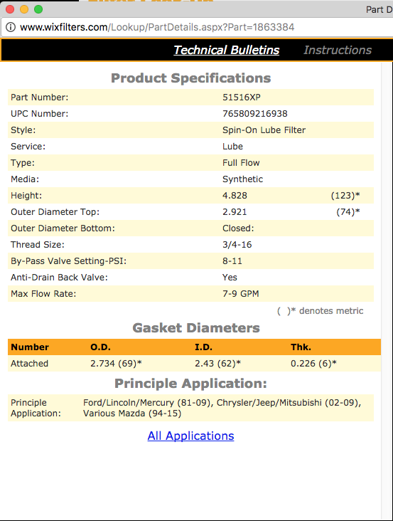

I am going full synthetic 5W30 with a WIX XP filter, PN 51348XP. If using conventional oil it's just PN 51348. If you need to do 3-4K oil changes (lots of city driving with prolonged idling) then don't bother with synthetic.

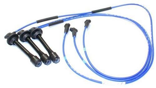

I went with NGK plugs and wires. Done. If you want "OEM" wires you can get them off Amazon or Camelback for about $50

Do you go with Iridium NGKs, maybe like these?
https://www.amazon.com/NGK-BKR5EIX-11-Iridium-Spark-Plug/dp/B000A8JLIY

I went with the standard, non-irridium NGK plug.

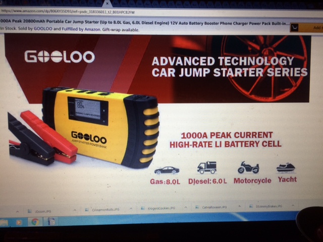

Well, I just ordered this, probably to arrive after the holidays.

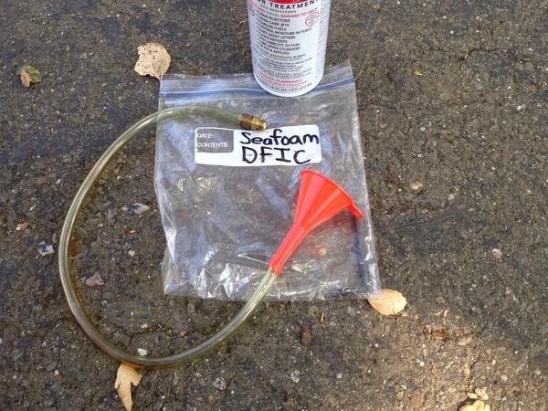

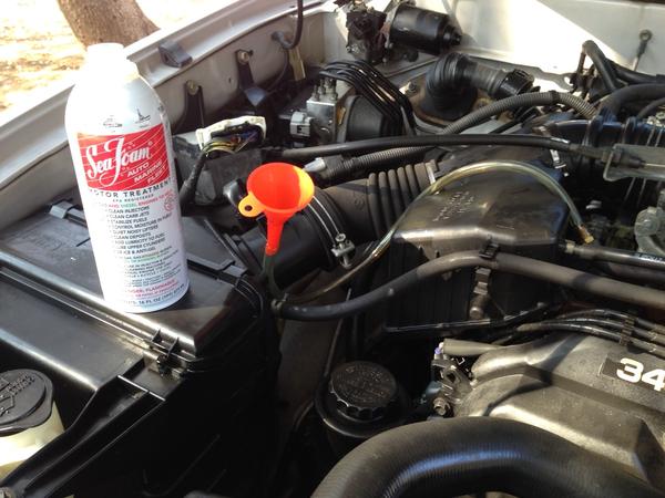

Seafoam in fuel tank, check.
Seafoam in the vacuum lines, check.
Always liked doing this one because of the glorious pontiff-like white smoke! There was not a ton, but a fair amount though. The set-up I use on my MINI worked perfectly.
The threaded brass fitting is for an intercooler bung on my MINI, but it slides perfectly into the vacuum line in this application.
Used about 3/4 of the Seafoam bottle. Will put the remainder in the crankcase later today. Looks like it needs to be 1.5 ounces per quart of oil. Seems that we have about 5.5 to 6 quarts. About 1/2 can is needed, so I'll open another bottle. The oil is actually approaching the fill mark, a bit low, so that is a good thing here...
I have a similar setup with a funnel and an adapter for that hose.
SeaFoam wants 2 oz per gallon in the tank, so that’s 1 can per 8 gallons of gas or 2 cans per tankful. A less expensive option in the tank and crankcase is Marvel Mystery Oil. 32oz of that is like $3 at Walmart.

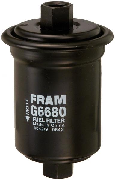

Most guys opt for Toyota OEM fuel filters, but you are free to do as you like. Toyota’s fuel filters are lifetime so I don’t know why you are changing it. LMAO (inside joke)
8 plugs now means you only need to buy 4 next time :thumb:
One set of wires, remember, one coil per two plugs LOL

octanejunkie ^^ I didn't buy the oil filter 51348XP / hope my WIX 51516XP works...might just be a longer one ??

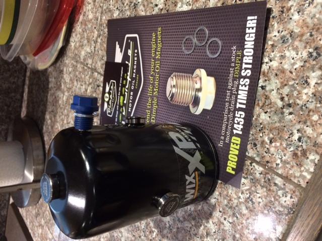

Fluids, the WIX XP Platinum are extended mileage filters / all I use.
- they contain a synthetic media / also sold to Amsoil & rebranded
- purchased from Filter1.com
I no longer use Amsoil (Group IV & way to expensive), except for Syn. grease / Redline for the Transmission & Gear oil.
And Pennzoil Ultra for engine oil, made from 99.5% clean Natural Gas base stock.
- my engine oil change frequency is 10,000 Km or 6,200 miles
- 2000 4Runner SR5 v6 https://www.amsoil.com/AmsoilGarage/internal/vehiclelookuppage.aspx?url2=2000+TOYOTA+4-RUNNER+8
- Transmission Synthetic Group V - D6 ATF - gallon - $49.95 @ Summit / 30705
https://www.summitracing.com/int/parts/red-30705
- Our lowest viscosity, most shear-stable ATF for consistent operation, designed to satisfy Dexron-VI®, Mercon®SP, Mercon®LV, Honda DW-1, Toyota WS, Mercedes Benz NAG-2, ZF-LG 6, 6+ and 8 fluids
Dimple Magnets for pan ($35 each) & oil filter (4pk for $35)...quality products & Made in USA...Phone 1-704-320-0700
Canadian distributor in ON. sells them for $35 Cdn & free shipping if buy 3 products...Phone 1-905-665-7883
Magnetic Drain Plugs - Dimple Products

- always wanted a vehicle Jump Starter/Battery Pack unit
- a strong capacity HD one, is like $300 in Canada
- did a fair amount of YouTube research, and got a good one for $99.99 US$ each / ordered 2
- also purchased one for our son, from Dad for Xmas ... there are times travelling, his Apple Laptop battery goes dead, so it can be quickly recharged
- unit is getting a 4.5 star review, over 100's of positive comments
Will even work on our JD's...LOL
GOOLOO 1000A Peak 20800mAh Portable Car Jump Starter (Up to 8.0L Gas, 6.0L Diesel Engine)
- 12V Auto Battery Booster Phone Charger Power Pack Built-in LED Light and Smart Protection
https://www.amazon.com/GOOLOO-20800...rd_wg=NEIxW&psc=1&refRID=R87WEXWSFT3VXR3R44T8
I linked the specs of the two WIX XP filters mentioned, seems the only palpable difference here is 1.424" in length - "that's what she said"
