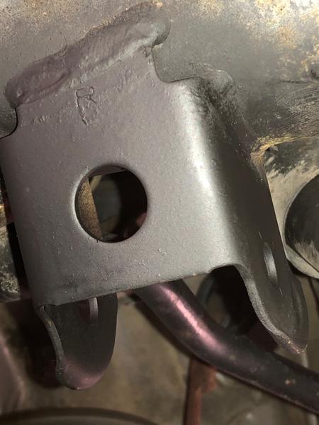

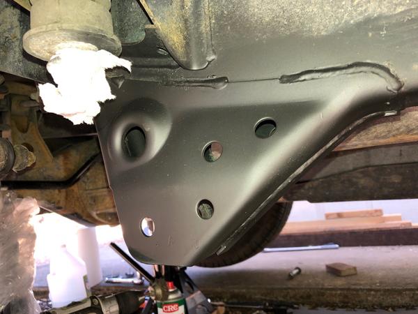

I also cleaned-up and painted the arm mount locations, here a photo of the lower ones:
Nice prep work on all the rear goodies!
What paint did you use on the frame?
That's too funny, I was scrolling down this last page to type the same question. Paint looks great! I'm curious as well.
Also, what did you use to clean your TB and IACV? I have the gaskets to do the same but haven't known if I should use carb cleaner or what. Your's turned out great. Hoping this will solve my hot start issue.
Thanks Mike, you too 128keaton. I probably spend almost as much time cleaning and painting (dry time included) as the actual work. Being a CA vehicle, rust is not all that bad of course, and I want to keep it that way whenever I venture into various areas...

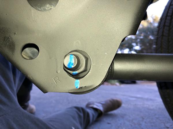

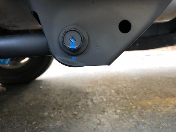

I always re-torque after a short drive, and today was a reminder why I do so. Of the eight bolt/nut pairs (both upper and lower arms), seven did not budge, but one upper arm was loose. I applied some blue Loctite and torqued to spec, again.
Kudos to Brian (BrianSD_42) for caring enough to reach-out to me with the reminder.
I explained to him, once I'm confident that the fastener/s are snug, I mark (fingernail polish) them so I can easily tell if they loosen over time. As you will see, I also painted the bolt heads along with the threads and nuts. Provides rust prevention there, and also makes it more difficult for them to back-out. Here are a couple...

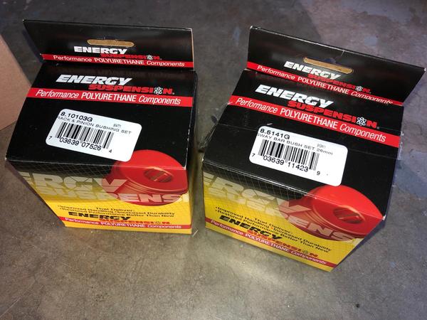

The aforementioned bushings for the front, awaiting a helping hand:

]The aforementioned bushings for the front, awaiting a helping hand:
You used whiteline for the rear control arms but got energy suspension for the front?

ES for front and rear sway bars, and steering rack. Whiteline for the rear control arms, upper and lower...

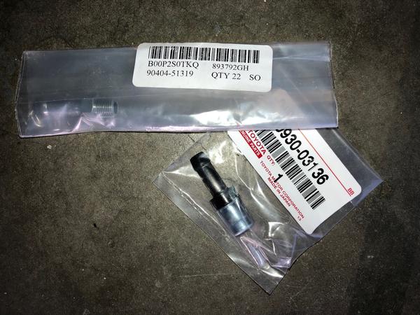

This showed-up a couple weeks ago:
Still need to figure-out what I'll do in the rear...
Also got this:
And since the install is easy/fast...
I didn't do this for any possible performance gains or even throttle response improvements. I like to pull spark plugs periodically for inspection, and this will make that faster. For me, it's worth it. Aesthetically, I do prefer the less cluttered engine bay too... Sound-wise, I have not detected any difference, at least with normal driving.
