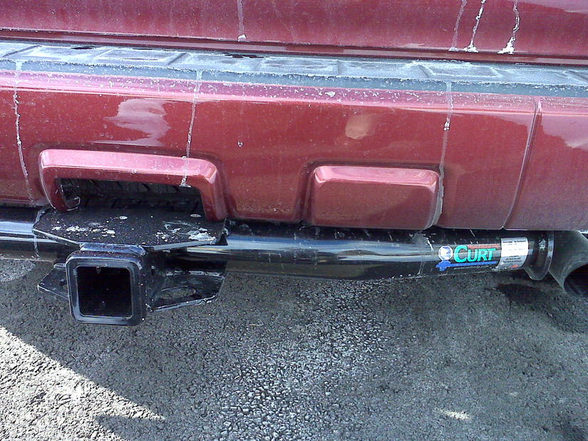

So did you get the hitch put on ? How does it look ? Do you have a space left where the stock WC hitch was ?
We pulled the Roo home on Saturday with the DMax, so now it is nice and comfy in my driveway ... waiting for warmer weather !!
Hitch Installed
Got everything installed on Saturday. Damn it was cold! Hitch went in very easy, as did the brake controller. Was timeconsuming taking the bumper cover off, and starting the screws above the muffler were a challenge. Couple of F-Bombs and a minor case of frost bite and it was done!
You can see in the pic the gap above the hitch. I'm going to do the aux reverse light mod when the weather warms up, and put a light in there.
