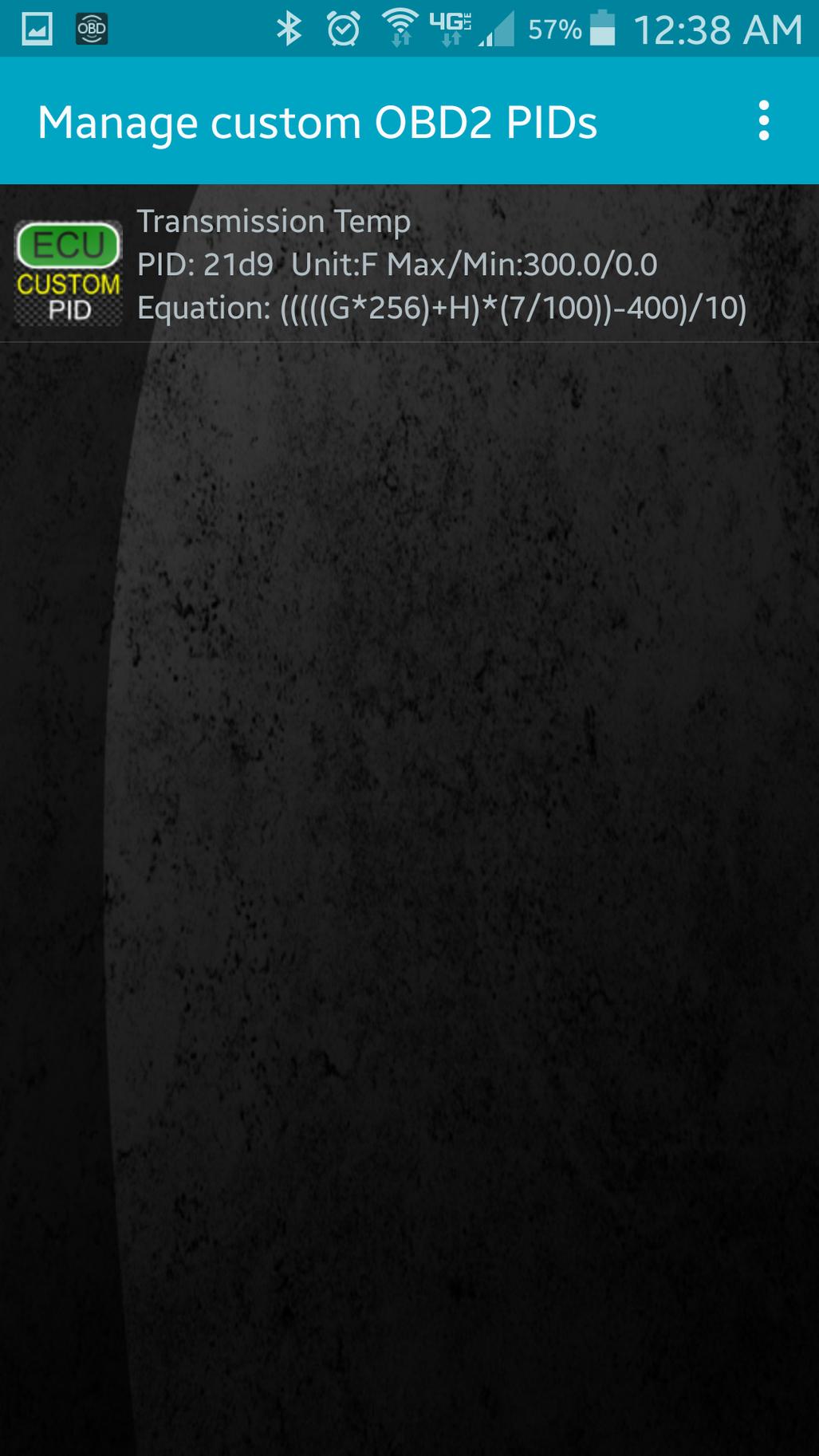

Pretty sure I entered everything correct but I get a "No Data" response when I test or use the custom PID on real time info
