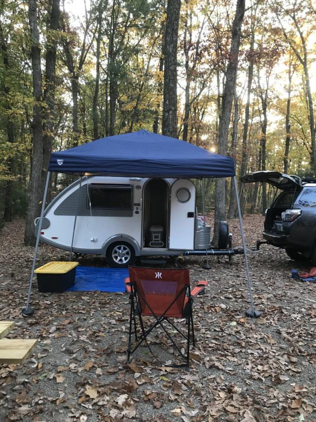

I've towed both T@B and the smaller T@G rentals on trips in the Virginia and Pennsylvania mountains.
The T@G was a breeze and I really liked that little trailer.
The T@B was noticeable, but didn't strain the 4R if you towed smart - anticpated hills, thought about torque converter and watched trans temp (scangauge).
East coast mountain passes are significantly lower demand.
I wouldn't hesitate a minute to tow either again.
Separate issue - recommend you rent/test drive a T@B.
I think they are trying to do too much with too little room.
The model with the inside kitchen and bathroom are almost unusable unless you are small people.
That's why I preferred the T@G - bigger bed, bigger outside clamshell kitchen and no bathroom (campground toliet or BYO).

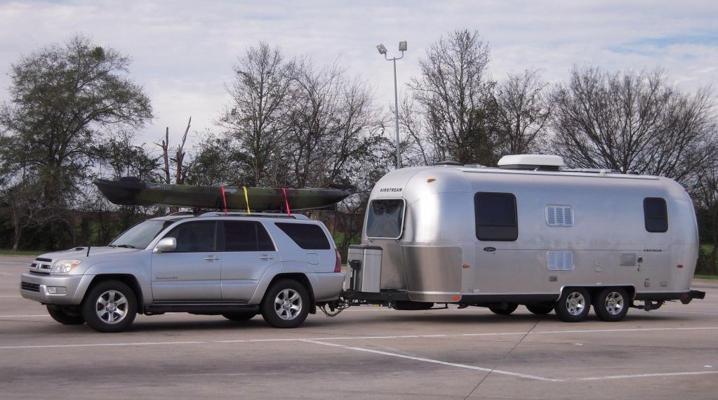

Mine isn't a teardrop trailer but my 2004 V8 is rated for 7,000 towing and 700 tongue weight. The weight distribution hitch (WDH) is the best way to move weight off the rear wheels and move it to the front axle and back onto the trailer. It also adds sway control which is needed for single axle trailers. I tow a 6500 lb. Airstream and it handles very well and stays level. My WDH is an Equalizer, sold by many trailer dealerships.
I love Airstreams. I wouldn't have thought a 4Runner could pull one.
My 2004 V8 SE is rated for 7000 towing and 700 hitch weight. With a WD hitch I'm below that and the 23' trailer maxes out at 6500 lbs. I've been to VA just outside DC, central FL across to AL, LA, MS, TX and up to AR, TN and KY. I've gone from KY across the plains to OR then back across the north to MN, then back down to KY. It's a little slow over the mountains but handles extremely well; never had a problem with cross winds or heavy traffic. I love my T4R :)
