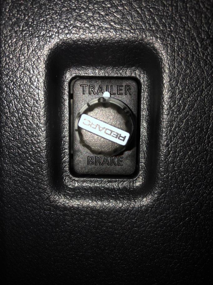

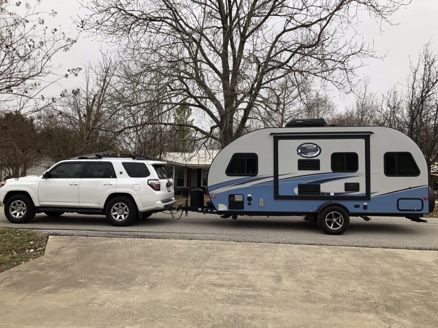

We recently purchased a Forest River Rpod. Don’t know what you are wanting but for 2, we really like it and the Runner pulls it pretty well. We did install an Andersen WDH and I have Airbags that I haven’t installed yet. I installed the redarc brake controller also.

Which Rpod model is that? How hard was the brake controller install? We are looking to buy an rv for cheapish and then fix it up to sell or keep. 2 people will normally use it but needs to be able to have 4.
Rv
It’s a Rpod 190, the table removes from the front dinette for an extra bed but any more than 3 would be close quarters. The brake controller is plug in play the factory plug is behind the drivers kick panel and plugs directly to the unit, no cutting.

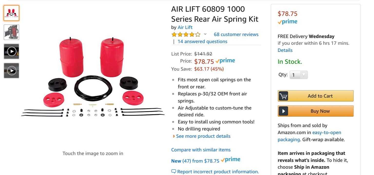

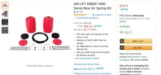

Which air lift bags did you buy? I can't find any for 2015 models.
