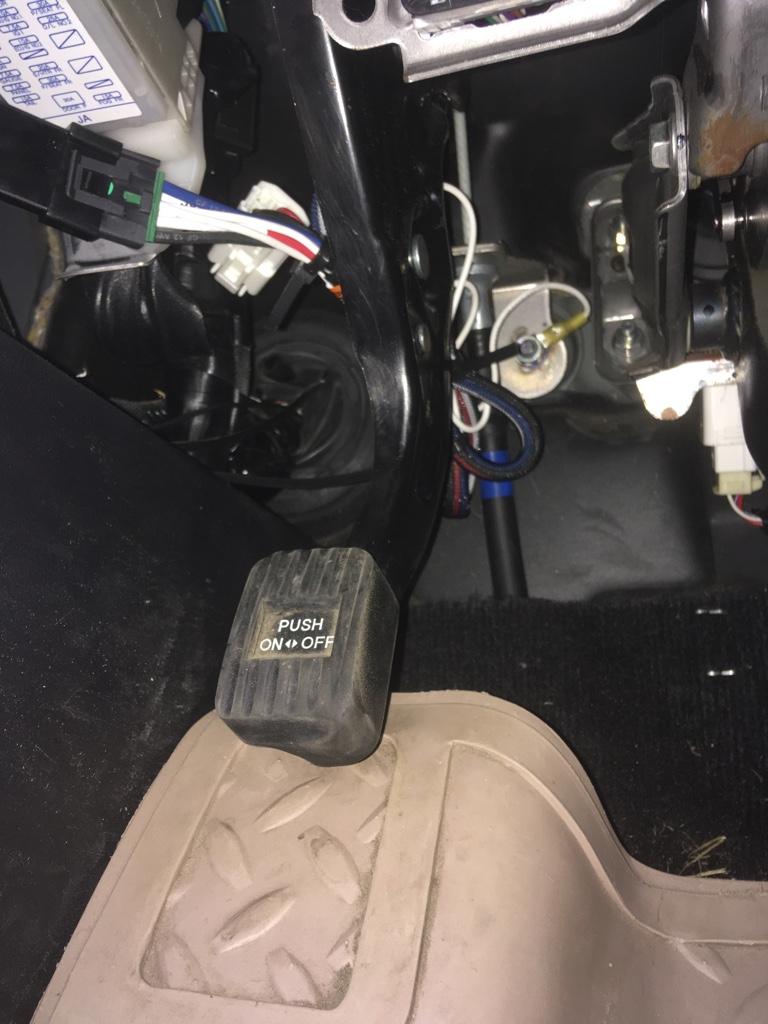

Here’s where mine is located (2012 Ltd)
Factory connector is above and to the left of parking brake (white connector). Black connector on left of pic is the EBC connector. Everything in-between is the Toyota adapter harness.

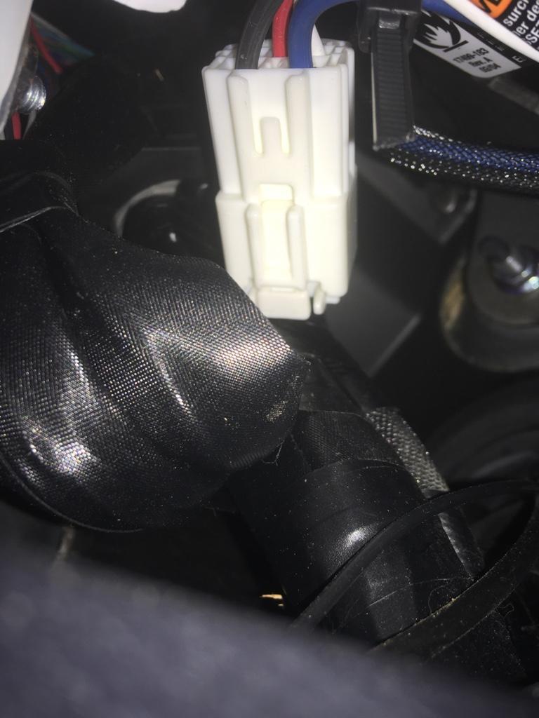

Close up of factory connection:

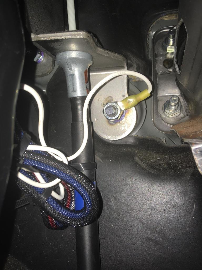

EBC adapter harness has a white ground lead, installers connected it here:

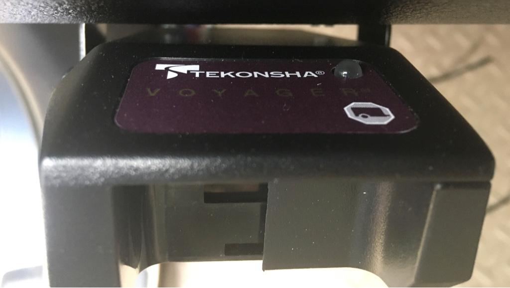

I have the Tekonsha Voyager:
