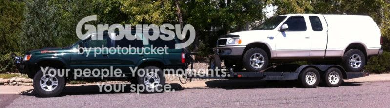

Don't try this at home.
Towing.jpg~original
Wow... Tail wagging the dog a little bit?
That is a lot of Ford back there. It did squat the 861s a few inches while towing.
It was a short tow, maybe 5 miles. I took back streets to the repair shop, for the Ford. Easy on the starts and stops. Truck and trailer had to be pushing 7000 pounds.
