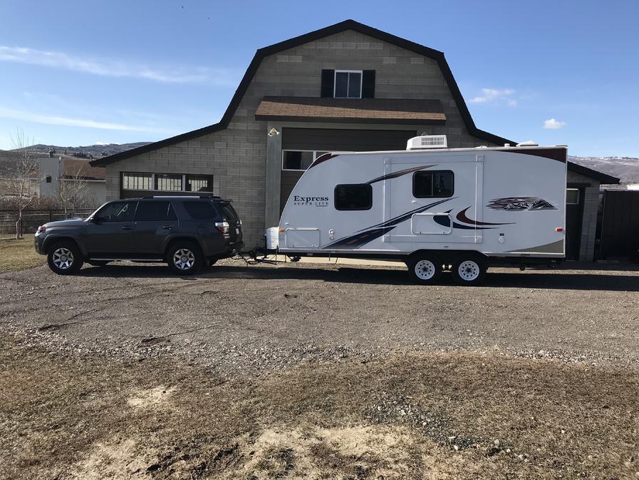

I must say this thread is/was extremely helpful. Just drove my travel trailer (roughly 3600 ibs) from Utah to Wisconsin with stock 2015 Trail Premium. Having a WDH makes a big difference. Installed RedArc Tow Pro Elite trailer brake controller day the before I hit the road. Averaged 62 MPH.
