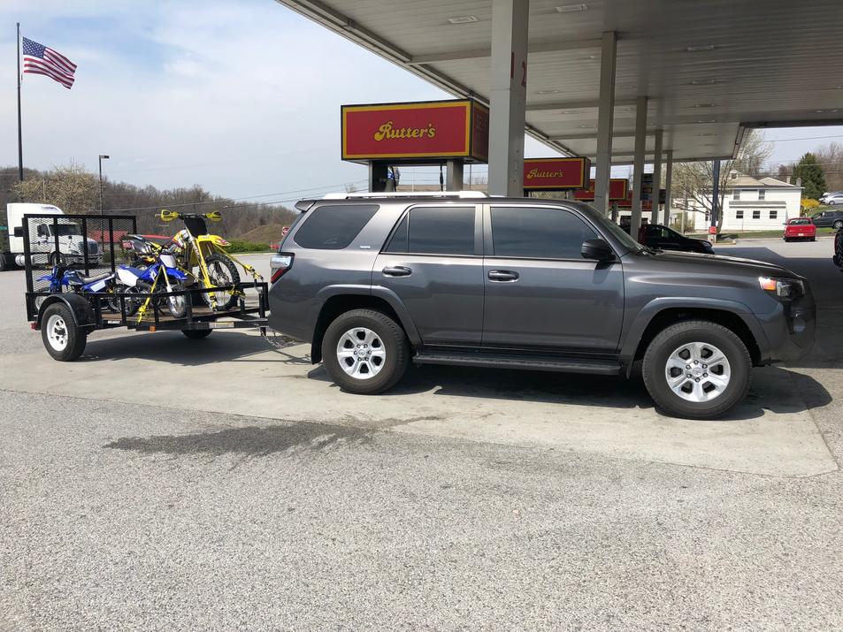

Towed for the first time (only had it a month now) but a few dirty bikes on a 5X8 trailer, didn't even notice it back there.

So far, so good.

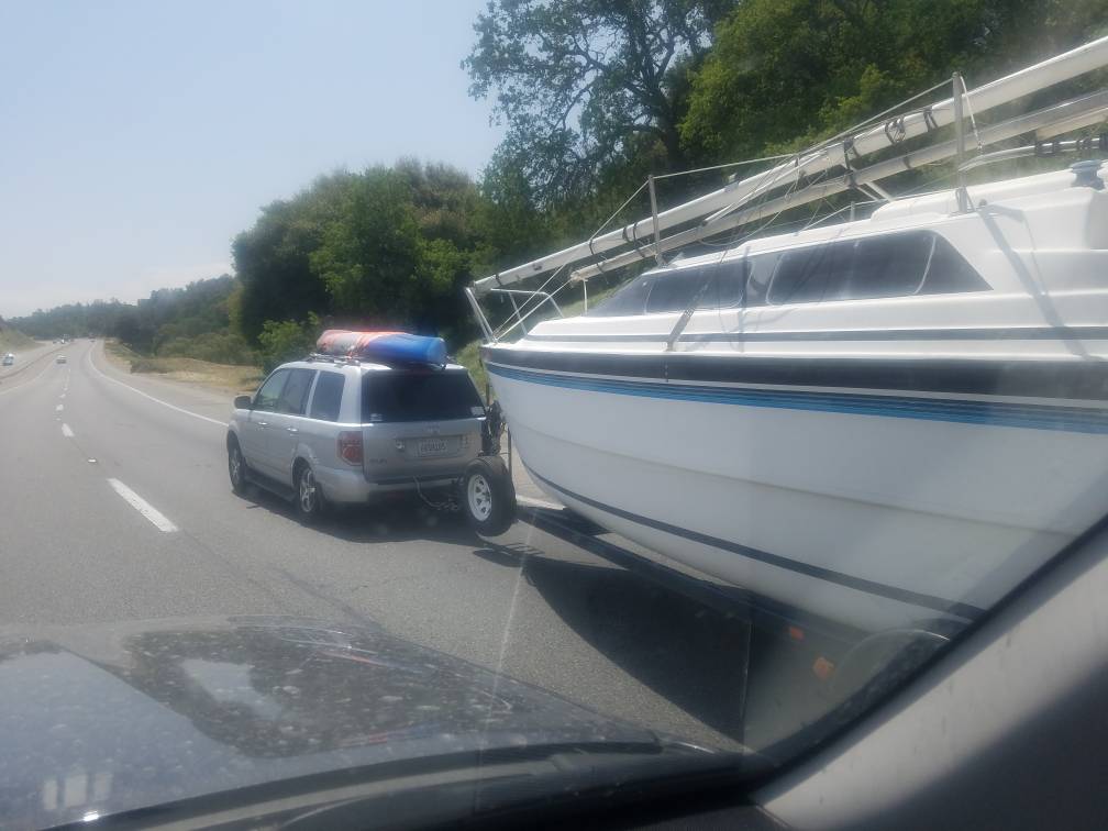

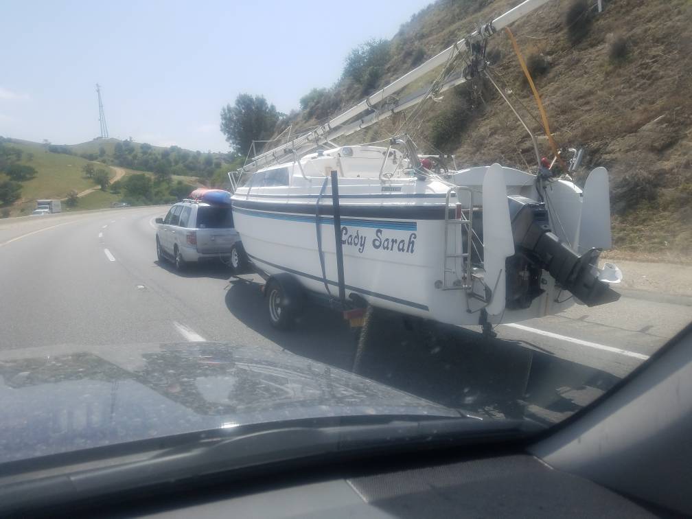

Spotted this Honda Pilot driver,
took these on Highway 40 today.
The rear tires were slanted so badly I thought his axle was fixing to snap.
The inside was packed with kayaks, he was white knuckling the steering wheel and we could smell his dirty droors as we passed him.

WOW, what an idiot. Glad he didn't hurt someone.
He is over on a Honda Pilot forum wishing he had bought a 4Runner :rofl:

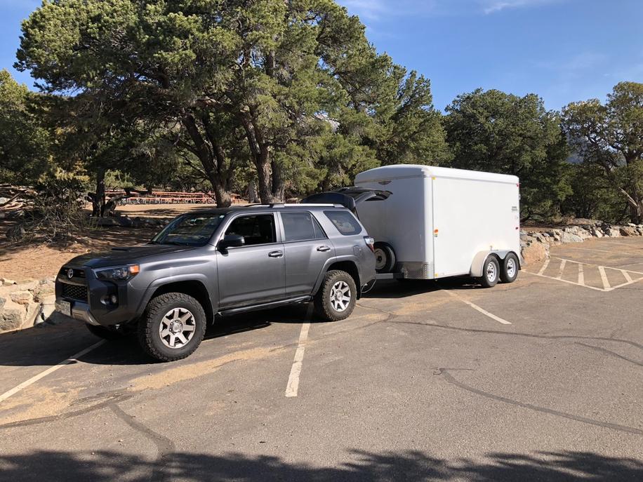

Mission: haul a trailer of boy scout camping gear from the Denver area to Great Sand Dunes National Park for a weekend campout. While this is not a particularly challenging route by Colorado standards, I did go up and over La Veta Pass, elevation 9,400 ft.
  • Trailer gross weight: 3,220 lbs. Also had 2 passengers and more gear in the back.
  • Distance towed: 462 miles round-trip
  • Mix of Interstate driving at 70-80 MPH and winding mountain roads between 25-60 MPH
  • MPG: 12.7
  • Average TC temps (transmission out): 180-190 deg F with one spike to 238 for a few miles over La Veta Pass
My 4R is equipped with BFG K02 stock size tires Rated C, Bilstein 5100 all around, and AirLift bags in the rear springs that I had set to 25 PSI. I tracked my transmission temps with a Carista OBD2 adapter and the OBD Fusion app. I also have a Tekonsha P3 brake controller. Frankly, I don’t know what all the fuss is about. For my occasional towing needs, the 4R did just fine. Here’s what I learned:
  • Use “Sport Mode”
  • The 4R did best on the Interstate in S4 gear and 2500-3000 RPM
  • Don’t be afraid to rev it when you need to. I had no problem on the mountain passes in S3 and letting it rev up to 4500 RPM when needed.
  • The AirLift bags are worth it
I’ve overcome my fear of running high RPMs in the 4R. Sure, it could be disconcerting at first if you aren’t used to this. I think most of the power complaints about the 4R stems from unnecessary worrying over RPMs. I’m not going to rev it all the time, of course. But for those short distances up hills or when you need the power—why not? I can tell you we did just fine with the trailer (no problem keeping good pace with traffic) once I went where the power is.

Wow. That must be loaded with crap. That's a Macgregor 26x sailboat. Although it's huge physically - they only weigh about 2600lbs. They use a water balast that takes on about 1500lbs of water for sailing. But it should be within the tow capacity of a Pilot. Assuming the water is drained for towing! But not if you filled it up and the interior is stuffed with another few thousand lbs of stuff. They're not known as being great boats either. But they make a good mini floating RV for cheap. I wonder what is going on inside that Pilot or how much weight they stuffed into that boat hull.

It was just one guy in the pilot. Looked terrified as we passed. Lmao

Thanks for the write up. This is similar to my U-Haul setup that I took from Florida to Oregon. We didn't hit the elevations you did but my weight was closer to 4k lbs and 5 total passengers. Back was packed and had a cargo carrier on top full of luggage. I had mine humming at 4k RPM on a regular basis in the hills without issue. Sure, it wasn't fast on the steep inclines but did fine. I don't have an extra tranny cooler or air bags just yet though but plan to add them in the future.
