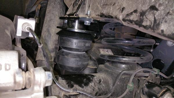

I just installed the Airlift 1000 bags on my 2016 Pro. (2" Toytec lift)
They work great! Easily leveled out my sag, with the #3300 toy hauler attached (loaded with #800 of motorcycles).
4Runner tows it just fine, IMO, but I'm not going anywhere fast and mileage is 10-11mpg on average.

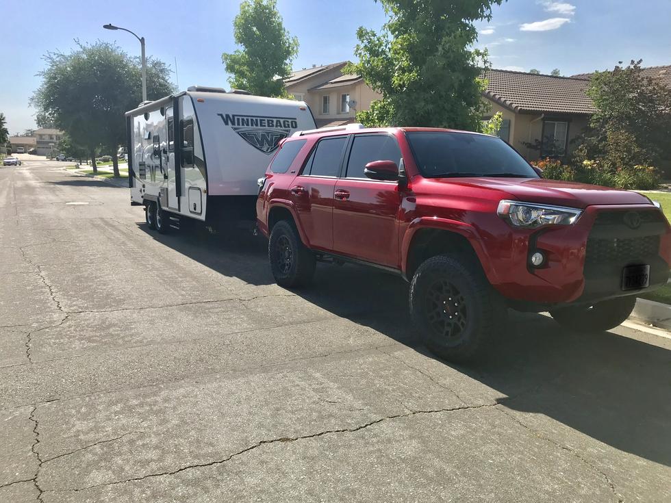

Pushing the limit but brought her home last month. Have been towing her every weekend since around 250 miles round trip.

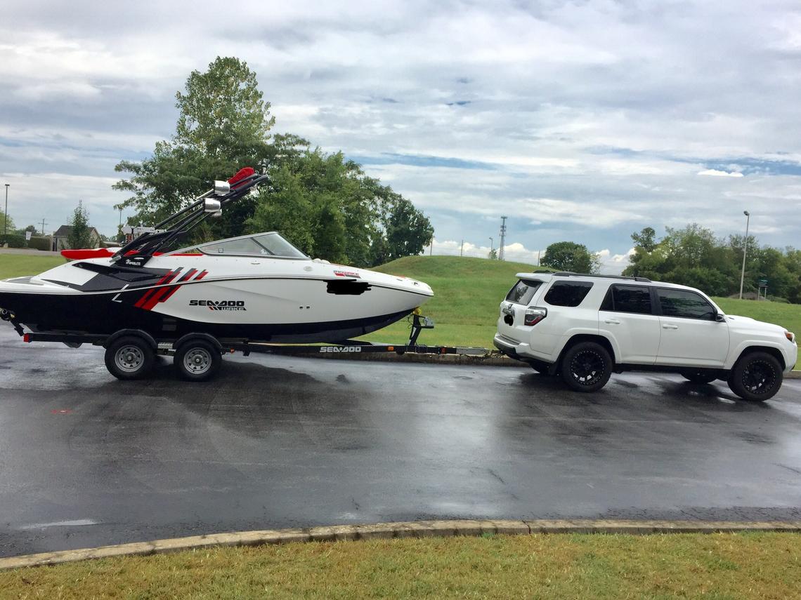

Titanpat57 - go big and you won't regret. I have towed a tandem Rockwood Minilite 2306 (4121lbs) for 4 years and never a problem over 1000's of miles in the PNW. It's slow no more than 65mph but not particularly thirsty - I have never seen less than 11 mpg. I have extra tranny cooler fitted that even up the steepest hills keeps temperature below 210 or so, Firestone airbags set at 25psi for towing and a WDH. Here are my scale numbers which is fully loaded - 4 adults, dog and all the stuff:
Toyota Max. Leavenworth 2017 Astoria 2018
Front 2998 2557 2469
Rear 3439 3682 3571
Trailer 4700 4121 4387
GVWR 6100 6239 6040
GAWR 6437 6239 6040
GCWR 11300 10360 10427
so can't quite enough of the rear axle to the front but it's only a couple of hundred pounds off and most importantly the GCWR is at least 1000 to the good,

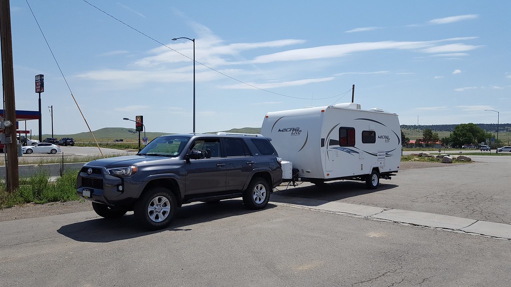

2016 SR5 with Firestone bags, stock springs, pulling an est. 3500# (wet) 19 ft TT.
