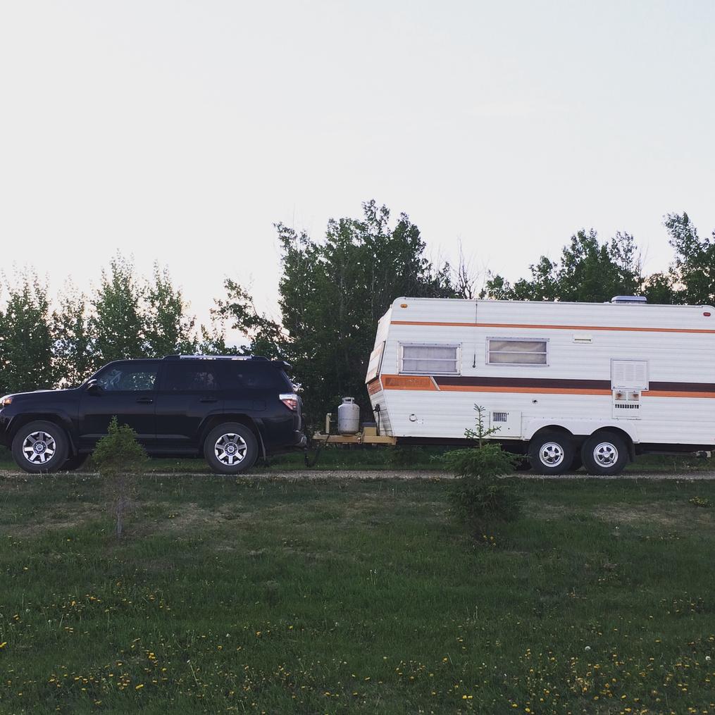

First real towing job for my 4Runner earlier this summer. Old 20' Aristocrat trailer, could definitely feel it back there.

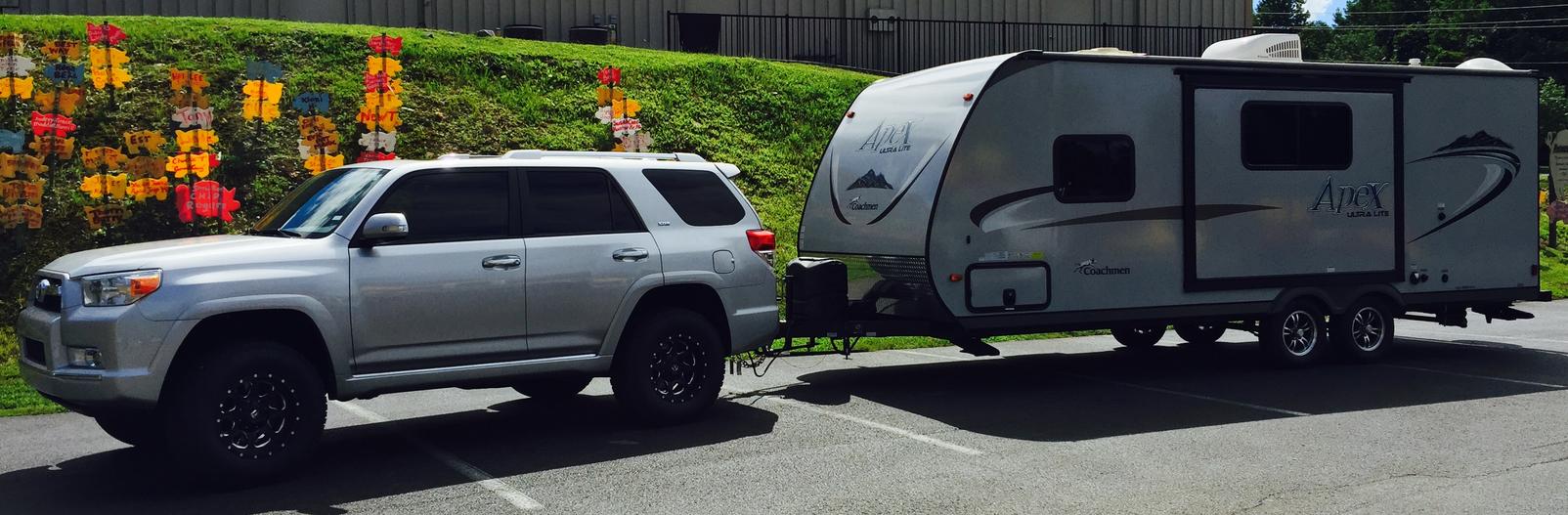

I've got airbags (w/wireless air) and use a weight distribution hitch as well; sag/nose pitch hasn't been an issue at all. Would recommend the combo to anyone planning on towing with a 5th gen. For reference, our TT is 4300 lbs empty, we probably push 5000 outfitted, depending on length of the trip.

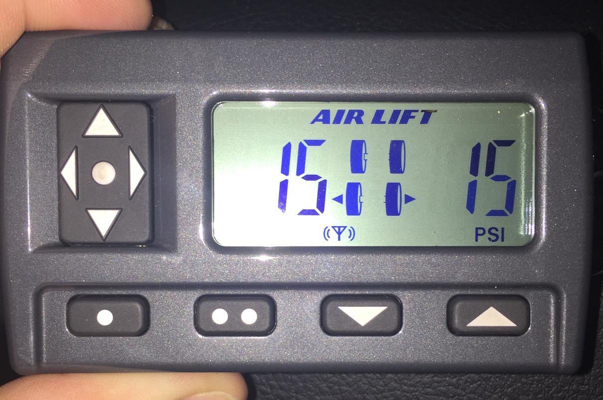

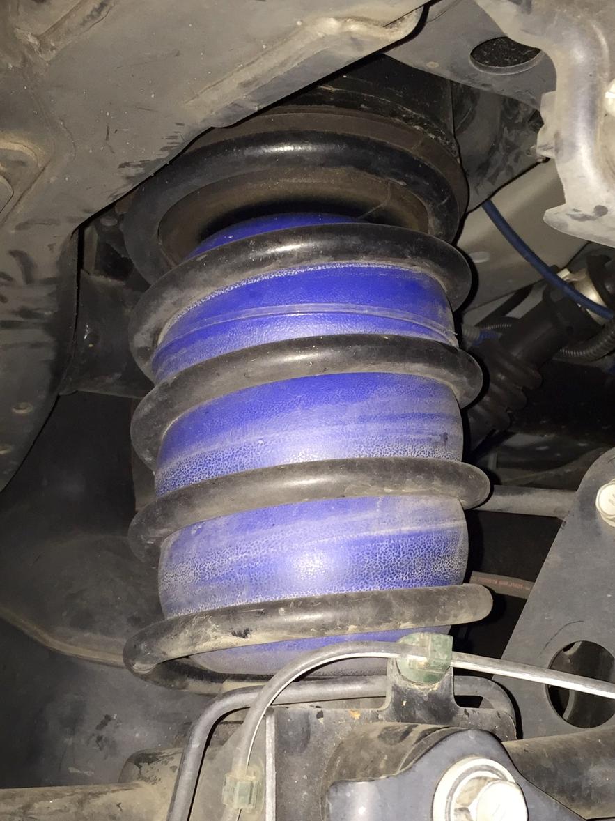

[MENTION=134163]jdt4rnh[/MENTION]..as discussed in our PM

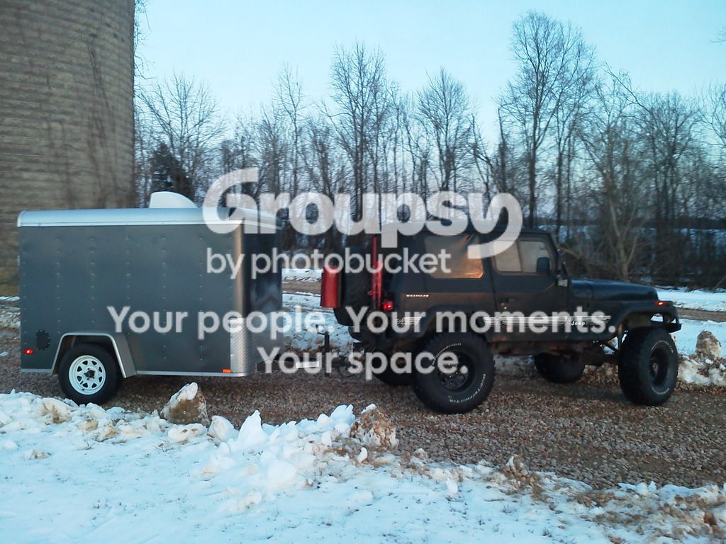

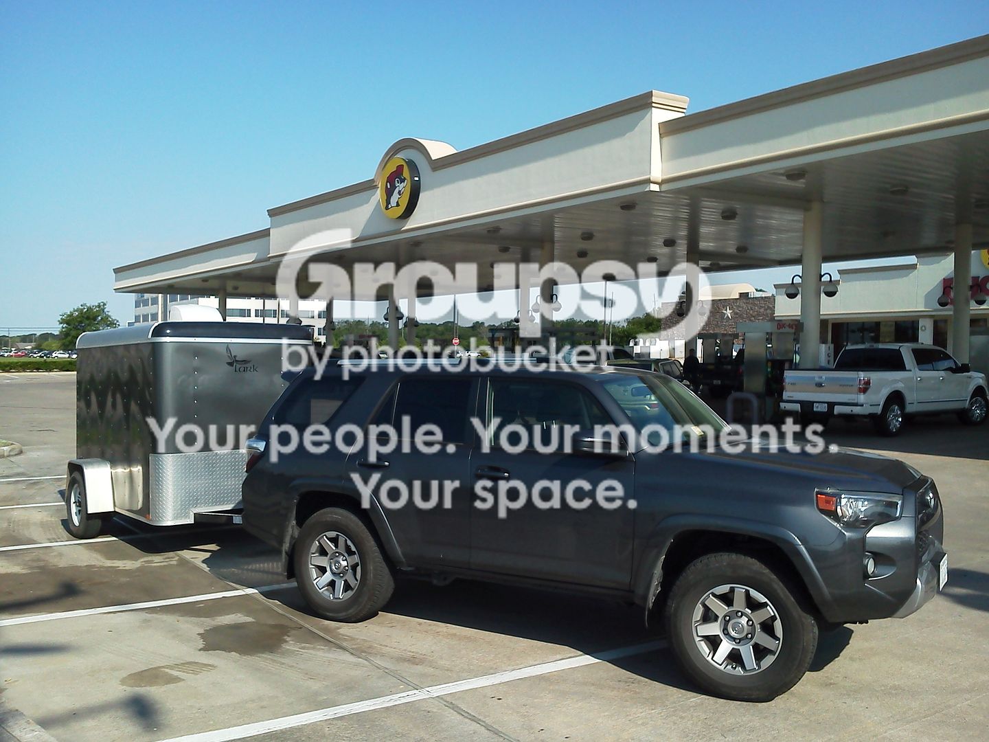

From Norfolk to D.C. with the Jeep (very Scary!!!)
From D.C. to Texas to D.C. 4 times
From D.C. to Maine twice.
Always at 3600 lbs. Pulled no problems, all stock.

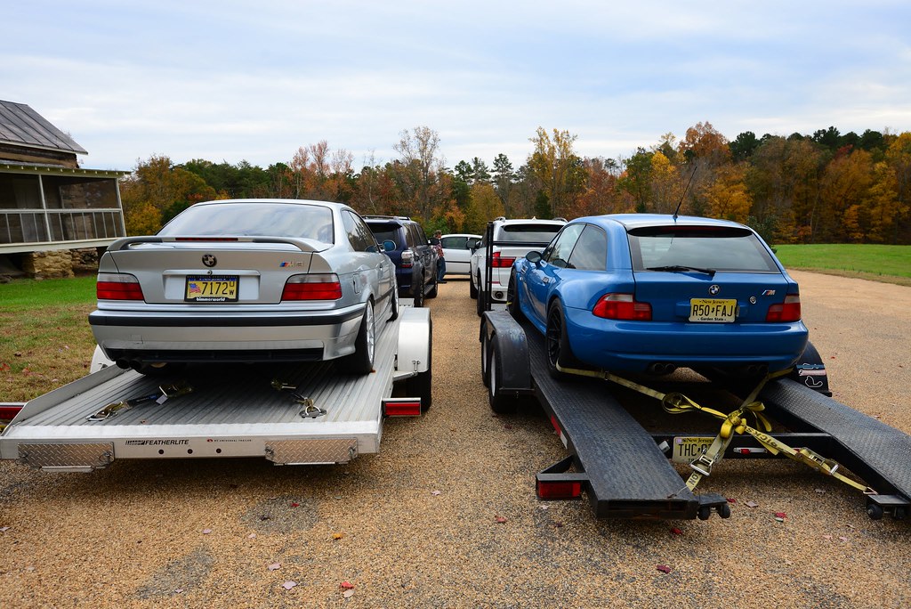

Nice trailer. :thumb: and of course the e36 M3 and Mcoupe. What does the aluminum trailer weight, if you don't mind me asking?
I want to say 1500-1700 lbs? I'm not sure, it's borrowed. :P
My buddy has a steel open deck and it's about the same weight (with M coupe)
I also installed a brake controller to make easier work of braking. I cannot imagine it without it!
