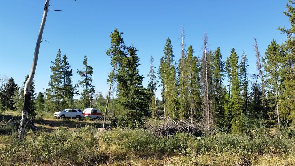

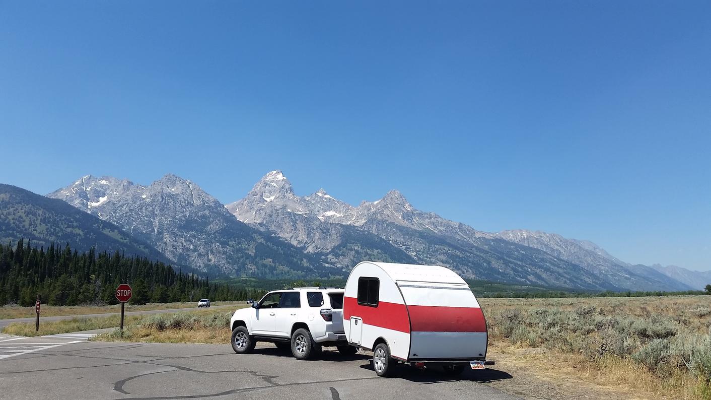

Just made an 800 mile round trip through the Wind River range in Wyoming. Had a blast. Towed my home built teardrop. I have no idea on weight. All of the scales were busy over the weekend or I would have stopped in for a weight measurement.
My guess is 1500-2000lbs
Mileage is very dependent on speed and wind. Also keep in mind that we climbed over 9500 feet multiple times on this trip. Basically the roads are a big roller coaster out there. At 65mph with no wind I'll average around 15mpg unadjusted for 285 tires. Worst tank was around 13.5 into a 30mph headwind. Wyoming is windy. Also at 80mph I'll get around 13mpg.
Here's a few pics from the road.

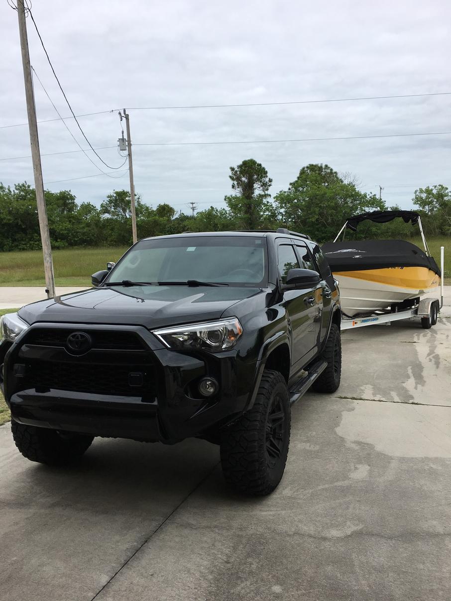

I am a tournament bass fisherman and have been towing a big heavy boat around for the past 15 years every other weekend. I have a 21ft. bass boat with dual axle trailer w/ brakes (4500lb). My primary tow vehicle is an F250 diesel. I have been towing with my 2014 Trail Prem the past few weekends and I must say I'm impressed with how well it does, however, you can literally see the fuel gauge move. It's horrible. The terrain is mostly flat with a few rolling hills. The only thing i'm concerned about is if I needed to make a sudden stop. Pull isn't the issue when towing it's stopping. It also starts to feel a little unstable when approaching 70mph towing that kinda of weight. By the way, my 4runner has BOSS suspension and 285 Nitto G2. It doesn't squat or sag with that tongue weight. Super solid.

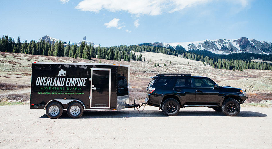

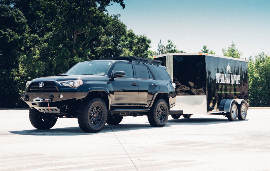

We pulled a 7x12 enclosed trailer from Florida to California and back in May of this year. 5,800 miles total. The only thing added to help the experience was a Tekonsha trailer brake controller to save our brakes. Well worth it. Our 4Runner has a lift, bigger tires, a front bumper, winch, roof rack and sliders. So gas mileage was terrible. But overall it was all good, not a single issue.
Trailer probably only weighed around 3000–3500lbs.
Here's a couple pics of the setup:

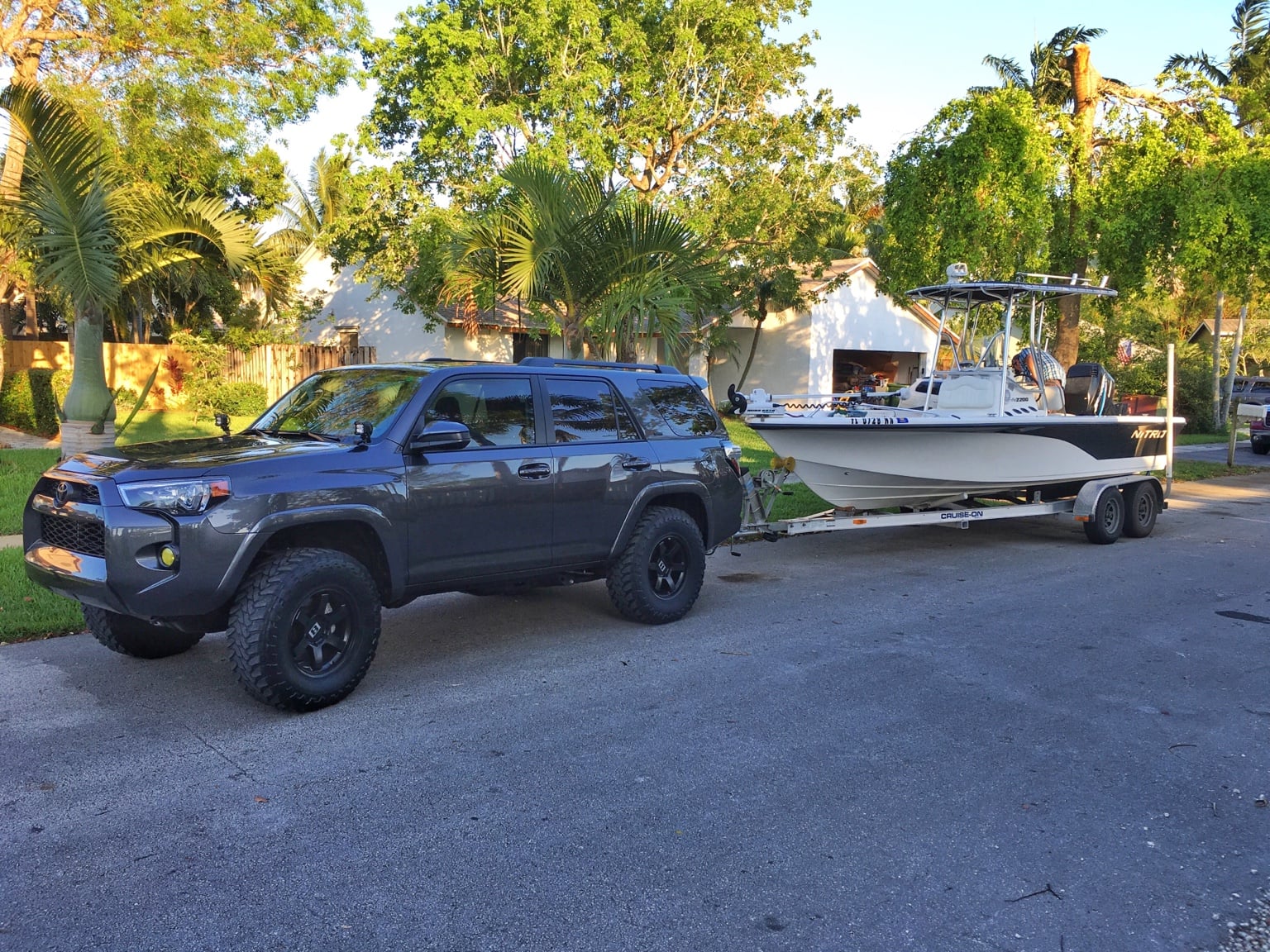

Found a pic from 3 years ago when I really hadn't done any mods to the 4R. Anyways, I've towed my jet boat across the Mojave Desert w/ zero issues. I plan in installing a tranny cooler this winter.
