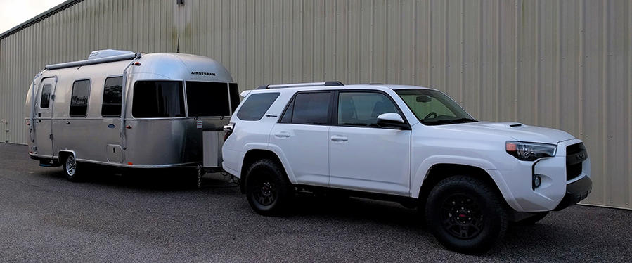

I pull this with a Reese weight distribution hitch and Tekonsha RF brake controller
3800#
tongue weight 400#

Is that a 2017 Airstream Sport 22 Bambi? That is the exact rig I am planning on getting one day. How well does the 4Runner handle it, and did you add any other equipment (Airlift, Trans cooler, etc.) besides the hitch?
Yes you are correct. 22FB. 4runner pulls it just fine. No other equipment was added other than the hitch. Airstreams are a little easier to tow due to the aerodynamics and low center of gravity.
