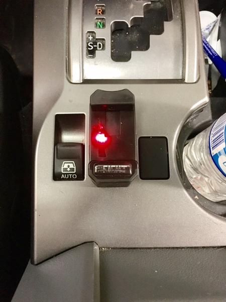

I use OBD Fusion on my iPhone paired with a Carista Bluetooth OBD adapter. But I can 't seem to find how to measure the TC temp. I can get Trans temp in/out, though. Did you have to configure your scanguage to read TC temp, or did it come pre-configured for it?
I have an ultraguage, which is a little different than the scan guage. It uses a different language/format/syntax (?) for programming. I had to find these on tacoma and fj forums, but they worked for me. Not sure if your app uses this format, I'm sure you can find the correct codes/PID's for your app on the various forums, but this is what I used:

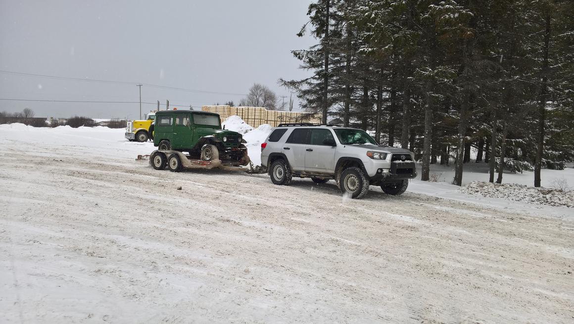

I just posted this in the "What did you do...5th Gen" thread, but adding it here, since it was tow-related. We towed our boat from miami to Ft Myers. For this particular tow, keeping the tranny in S4 worked best. The sweet spot was a steady 2.2K RPMs, at about 68MPH. Took a little longer, but the truck felt smooth - never felt bogged down or straining. The boat is about 2900 lbs dry, and the trailer about another 1K lbs. 4Runner did great.

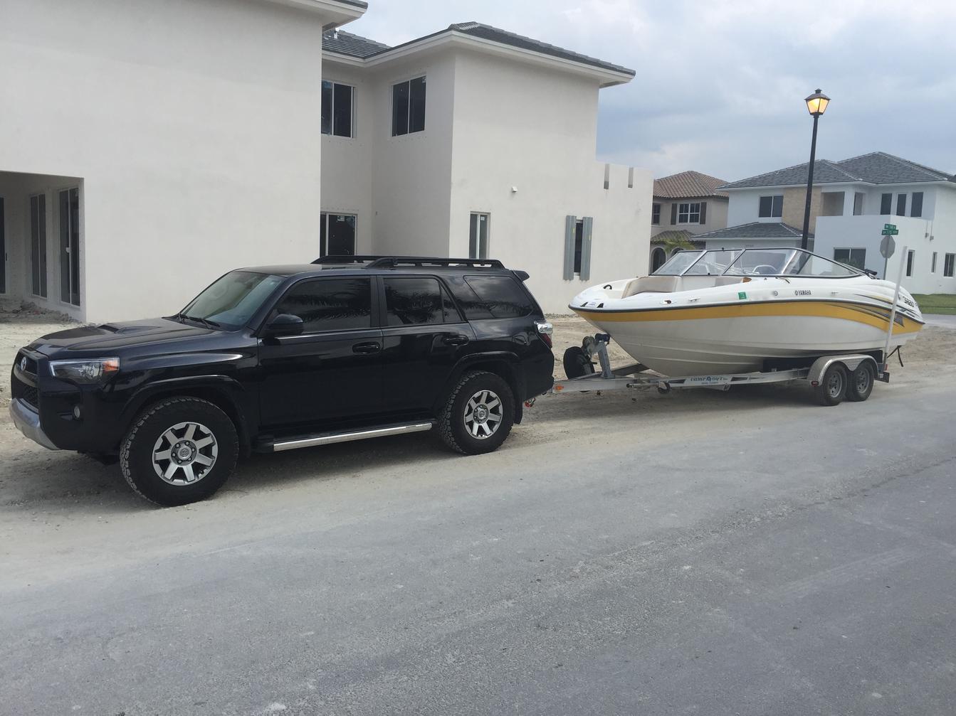

Towed my 23 foot boat last weekend and the 2wd SR5 and it did fine. I aired up the Airlift bags up to 20 PSI and left the trans in S4. It towed the boat even better than the old 04 4runner it replaced. Probably 4500 lbs with the trailer.
I'm using a Weight Distribution for my RV Trailer, but when I went to get Land Cruiser with the UHaul trailer last december (during a huge snowstorm), I didn't expect to get that low on the rear and it was so light up front it was scary as hell. And also manage to loose a bolt on the rear shock, which make me slept in the car for a night.
But usually the towing going pretty well.

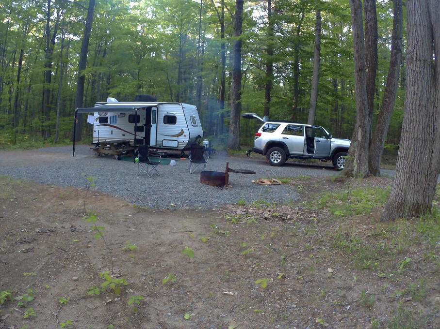

Still new to this forum, and new to being a Toyota 4Runner owner... but have plenty of experience towing with a smaller SUV.
I look forward to hearing some feedback! I too am coming from a 2006 Xterra (same color even :) )which towed like a dream pulling an 18’ Flagstaff Micro-Lite at about 3,000# dry w/ an Equalizer WDH. I’m real anxious (read: nervous) to tow with the 4Runner; it is my single biggest reservation and concern about the vehicle. The low end torque and tranny gearing on the Xterra were seemingly a dream compared to the 4Runner, at least as far as the “seat of the pants” feeling goes, although the numbers on paper are nearly identical as far as horsepower, torque, and even final drive ratio in every gear for that matter! 4Runner is about 500 lbs more porky and too quick on the up shift. I plan on towing exclusively in S-mode and keeping the tranny in the power band.
Also, I’d make the argument that staying in the 80% rule is a good rule of thumb, especially folks new to trailering. Also depends where you live. 5,000# at sea level is a whole different ballgame than 5,000# at elevation; here is CO you can’t go much of anywhere without going over a 10,000ft mountain pass–Monarch, Vail, Lizard Head, Wolf Creek, etc are all long, steep climbs were it makes a whole lot more sense to tow a more moderate load. As powerful as the Xterra was, I felt like that trailer was just about right in these conditions and certainly wouldn’t have wanted anything much heavier, although I know of several others who’ve done it with trailers comparable to yours, or even heavier! As you said, comes down to individual comfort level I suppose, but I prefer and would argue a bit more conservative approach as opposed to towing at the max, especially in the Rockies.
Test run locally in about a month then shake down run over Memorial weekend! :) In the meantime, need to get those Firestone air bags installed…
We basically bought the trailer for a 2 week trip to Mt Rainier w/ our toddler son. Ideal way to road trip with the kiddos! :)
Couple shots from last summer around CO…
Happy Camping and Safe Travels!

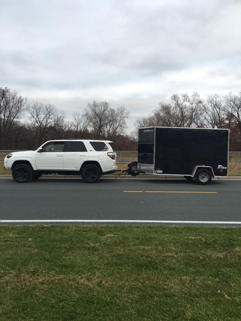

I tow this enclosed cargo trailer about once a month in the warm months. Filled with motorcycles / scooter and camp gear around 2700lbs. Keep it in S4 or S5 with no problems. Pulls a little extra RPM and burns a little extra gas but who cares, it will tow like that forever- its a Toyota.

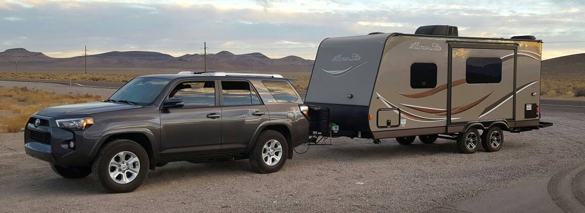

I tow a 2014 Holiday Rambler Aluma - Lite trailer, 22 feet long, with my 2016 4runner. I have weight distribution hitch system with sway control and it tows great. Reno, NV is above 4500 feet and nearby summits are 6 to 7000 feet whenever you hit the road. My issue is the rear sag when I hitch the trailer, 2.5 inches. I just had the Timbren Suspension Enhancement System installed today and will test it out this weekend.
Sent from my GT-N8013 using Tapatalk

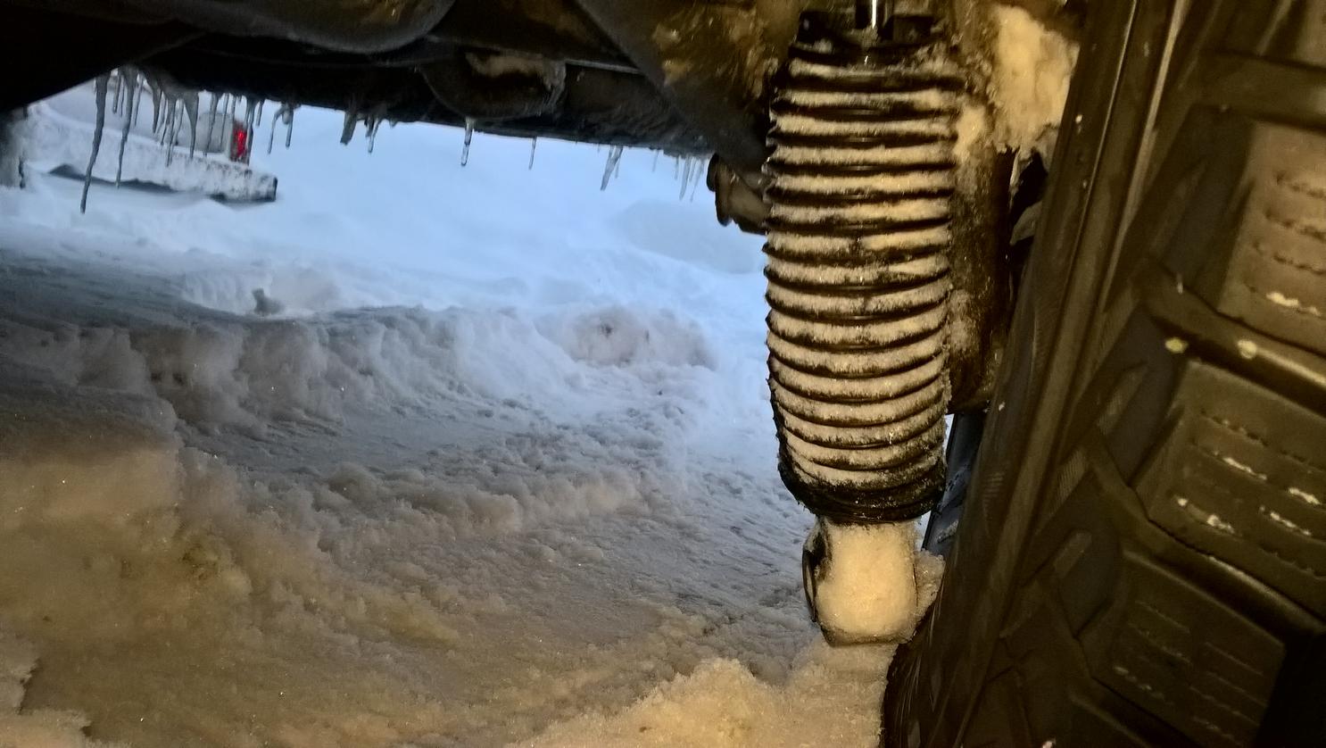

I just installed the Timbren Suspension Enhancement System on my 2016 4runner. Local shop recommended it over air system.
