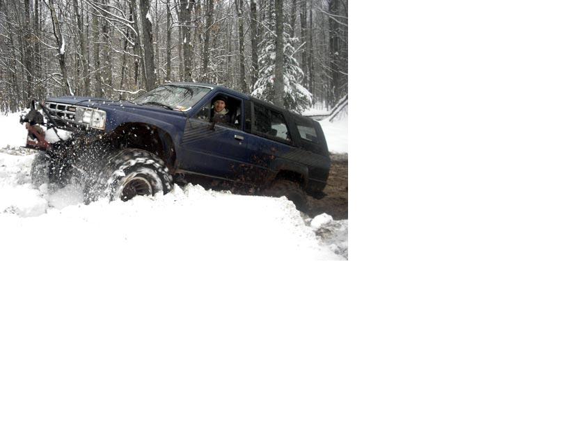

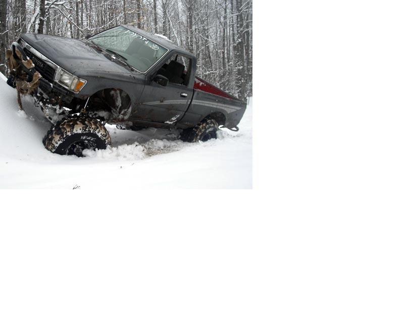

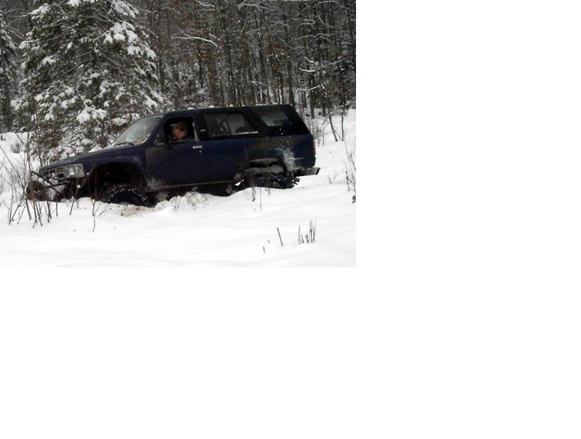

when I was looking at some trail trips in the UP for snowmobiles I saw these photos of guys wheeling in the UP in the winter.
