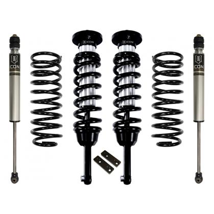

Stage 1 Kit – K53061
The Stage 1 system works well in most on and off-road scenarios by significantly improving factory body roll and overall driving ability. ICON 2.5 Series front coilover shocks feature a vehicle-specific tune to give your Toyota 4Runner great ride quality on or off-road, and they are adjustable from 0 to 3" of lift.
SYSTEM COMPONENTS:
Part #58646 - 2.5 SERIES IR COILOVER KIT
Part#56505 - Pair REAR 2.0 ALUMINUM SERIES IR SHOCK

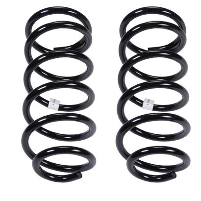

Part #52700 - REAR 2" SPRING KIT
Stage 2 Kit – K53062T
This ICON Stage 2 suspension system uses the same components as the Stage 1 system with a few simple changes and additions. The 2.5 Series coilover shocks used in this system are the Extended Travel version, offering increased wheel travel that will enhance your on and off-road performance even more so than the standard travel units. Since these shocks do provide more suspension travel, they require the use of an ICON upper control arm. The tubular steel uniball upper control arm kit found in this system offers improved articulation and strength over the OE control arms, and has alignment correction built-in.
SYSTEM COMPONENTS:
Part #58647 - EXT TRAVEL 2.5 SERIES IR COILOVER KIT
Part #56505 - Pair REAR 2.0 ALUMINUM SERIES IR SHOCK
Part #58451 - TUBULAR UCA KIT

[MENTION=120150]TotalAutomotiveLV[/MENTION] We currently run the stage 2 suspension (non-KDSS) and just upgraded the rear springs to the OME 2899 "super-heavies" due to the overall rig weight with the new rear SSO bumper and the fact we run with a Turtleback Trailer 90% of the time.
My question is: Should I upgrade the 2.0 rear shocks to the 2.5 remote reservoir to help control this added weight? Or do you think the 2.0's will be enough?

Just one opinion.
Springs control the weight. Shocks dampen the springs. Doubt you would see any difference in dampening characteristics with 2.5 vs 2.0. Unless you went with adjustors and dialed it in for different uses.... 2.5 is mainly for high speed off-road. Doubt you do much with a tuttleback loaded up 90% of the time.
Does it feel OK as is?

The ICON 2.0's are great with OME Rear Coils. Especially with the 2.5-3" of lift.
