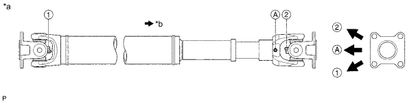

Is there a grease fittings on propshaft or I have to take it apart? that teflon greeze sounds like a great idea!
Yes, there are grease fittings and should be greased every 5k miles I believe per the manual. I grease mine every time I change the oil while I'm waiting for it to drain. Takes all of 3 minutes for 2 squirts each!
The rear has 3 zerk fittings and the front only has 2 as it doesn't have "A".At least on mine it doesn't.

Are you sure there aren't 6 total? I wonder how the front slip joint gets grease?
Mine only has 5 and I looked to see if there was even a place to put a zerk for the front driveshaft slip joint. I thought maybe mine wasn't put on or came off.
Probably greased from the factory. It has slip joint but when you think about it it doesn't move in and out normally like the rear one. It connects to the front clamshell/diff that is attached to the frame, as is the transfer case on the other end.
The up/down movement on a IFS suspension in the front is fron the CV axles. The only time it is needed to move/slip in and out is when it is taken loose or removed.........like I did last week.
Good point. Hadn't thought about it but that makes sense. I might have to rethink how I'm greasing that particular zerk (4th gen). I have observed expansion in it while greasing, though, but nothing like the rear shaft. I suppose it has to move a little for things like frame flex and thermal expansion. Thanks.
