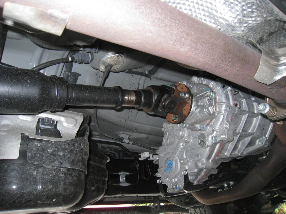

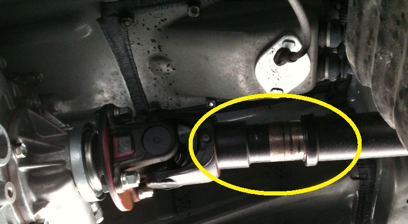

Took my "Lifted" 2011 SR5 (4x4) into the dealer today for the random clunk-thump coming from the rear... Told dealer about the TSB, they put it on the rack, looked at it, and brought me back into the bay to talk with the service manager.
The service manager asked me who did my lift and took me under the truck to show me what was causing the issue. He showed me the front portion of the driveshaft was protruding out of the main body of the driveshaft due to the lift and this is what is causing the random clunk/thump (see pictures).
He also said he gets this issue a lot with people bringing in their lifted Tacomas and FJs, if he were to change out the old driveshaft for a new one Toyota would not except it and the new one would also have the same issue as the old because of the lift. He then proceeded to tell me about a nearby shop that deals with driveshaft issues like this, even gave me their contact info.
Given that I have been driving with my lift for more than a year now and have had no issues other than the random “clunk/thump” concerning the driveshaft, I am apt to think the dealer is full “O”:toilet:
For those of you with lifted T4Rs that have taken them into the dealer for this issue and had the driveshaft replaced per the TSB, did your driveshaft look like mine in the pictures before you had it replaced and what does it look like now after replacement (pics please)?
Any input on this issue would be much appreciated.
Thanks!

@OBW2011. That is such a load of horse puckey.
By his logic, your lift is causing the problem. Many non-lifted forum members have had this problem, including me, and it is positively CURED by this TSB.
Note the TSB says exactly nothing about lifted or non-lifted. Did you show it to him?
I'd find another dealer - this guy either doesn't want to fix your 4R, or he's stoopid. Either way .....

mine looks exactly as the pictures
Is your truck lifted or stock?

Good point, the TSB does not say a thing about lifted or unlifted. I should have caught that and brought it to service managers attention. :ybrick: I brought the TSB number in with me and gave it to them for look up in their system, they seemed to be on top of it and helpful but then you know what happened...
Dealer get paid by Toyota anyway why the hell he don't want to make money?
Good question, don't know, but considering how I feel about that dealer's service department now... not looking good for repeat service.
I'm in South West Florida area, anyone know of a good dealer around here?
