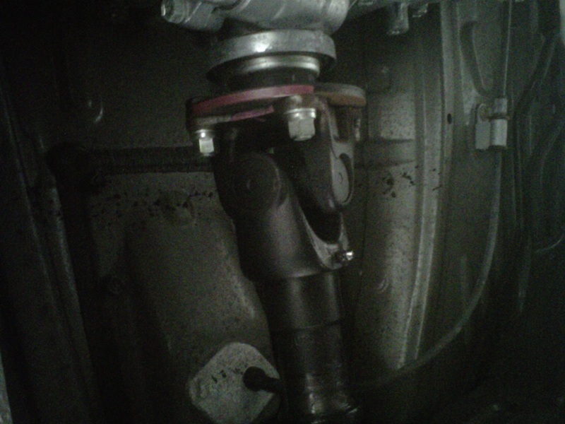

How much grease?
How much grease are you guys using on the slip yoke? For the universals 2 -3 pumps and the grease was beginning to ooze out of the joints but for the slip yoke zerk I pumped about 18 times but no oozing so I stopped. This is the first time I'm greasing (20k miles). I haven't driven it yet but I'll let you guys know if it fixed my thump.
I greased the front wheel slip yoke too but only gave it 6 pumps and no oozing there either.
It's not difficult, I was able to crawl under the truck without a lift and reach all the zerks you may need to roll the truck to position the rear shaft and the front can be turned by hand if you're in 2H.
