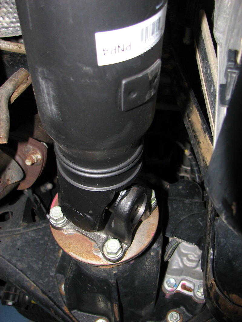

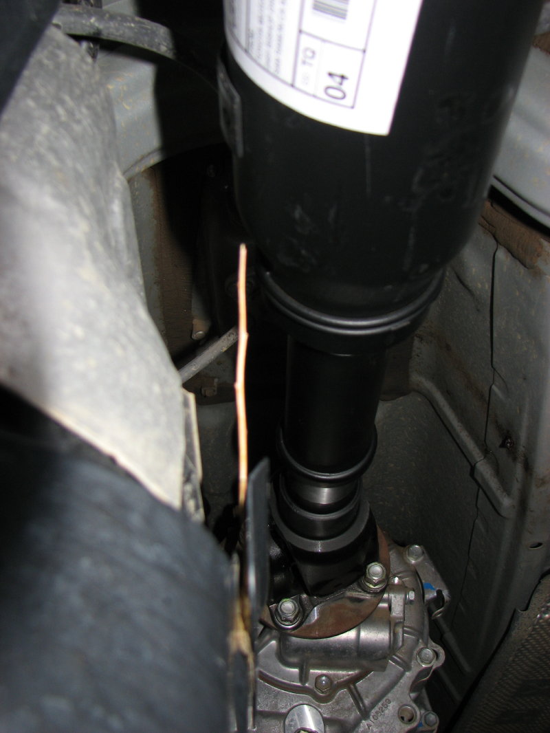

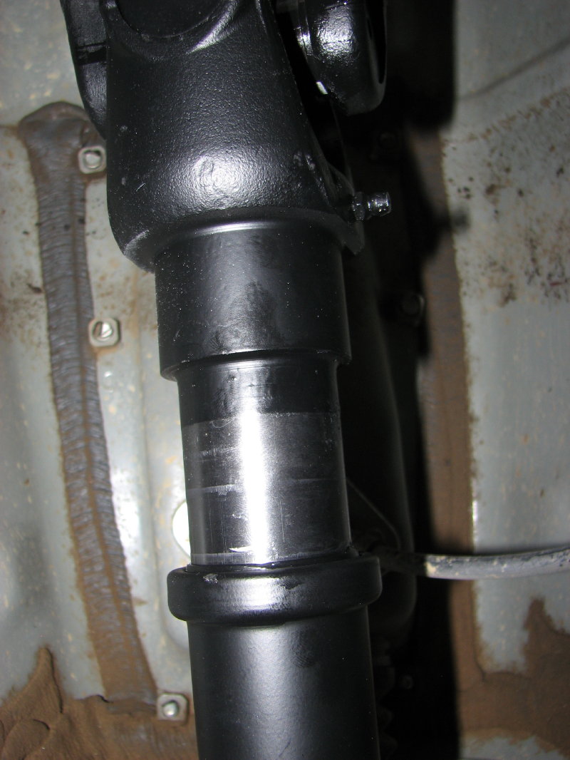

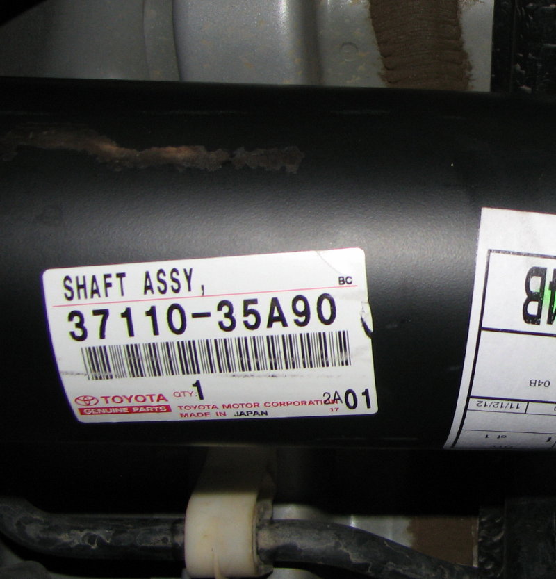

I'm bored so I took some pics.

Dealership agreed to go ahead with the service. My truck is scheduled for the driveshaft fix on December 31. Hope this resolves the issue.
So, it looks like I will be receiving a new driveshaft, right? Did it help? My service will be completed on Monday, the 31st.
Thanks for posting. I've gotten a clunk occasionally but not paid much attention. I'll have to see if that was this.
Well, it's done. In and out in 45 min., including the always-free car wash.
The part was ordered Wednesday, was in stock in KC, and at the dealership this morning.
I ran errands, aka lotsa stop-and-go for 2 hours afterwards, and the problem is gone.
Well done Toyota.
Should have kept reading....Thanks. I hope thatI will have a similar experience when I pick up my truck on Monday. Thanks!
